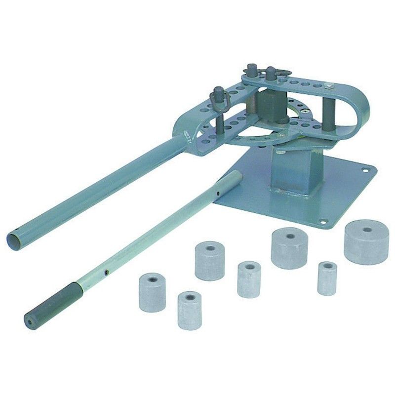

That bender is an HF bar stock bender. I've owned one for about 20 years. Almost as long as I've had my Jd2 tube bender. It should have a set of dies that are way different from the dies for a tube bender.
http://www.harborfreight.com/bench-top- ... 38471.html
Damn handy tool. Should be good for gates and such. Not really a tube bender, although I've encountered some dies for small tubes designed for that bender.
I was just looking for pictures of the gates I made for the Amblin Entertainment movie "Casper" a bunch of years ago. They involved 1,000 linear feet of 3/8" x 1" bar, not an inch straight, all hand bent with tools cruder than one of those benders. Guess I don't have any of my movie set pictures in digital.

The first trip to my bender is almost over.

For an on the road type of rail the style of bars you have between the front and rear hoop are OK (a modified T-top style for easy in and out) but will need something for a connection between them. In a wreck they could bend at the bends and not support the front or rear hoops as well as you would want.
Off-roading it might be best to have those bars located to the outside incase you "lean" into a tree or other obstacle.
At a quick the rest looks pretty good!
