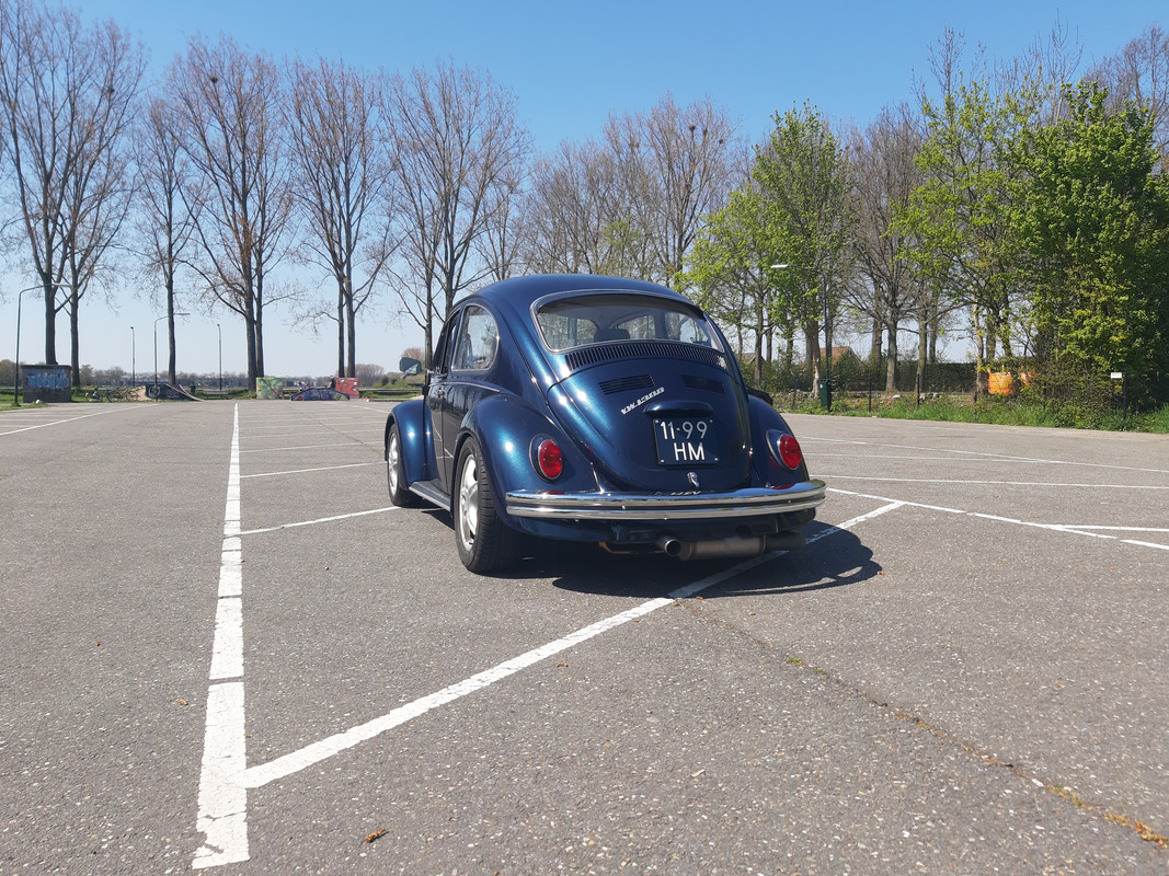

Thanks Robin, I will check the settings of the coil I used. For now the 009 with replacement for the points works fine. Yesterday I had some time to take it on the road. :D
The fuelmap still needs some work, but so far it runs really great very strong but easy to drive! :D And I also like how the throttle control works. Really easy to adjust, way better than the push/pull one I had!
