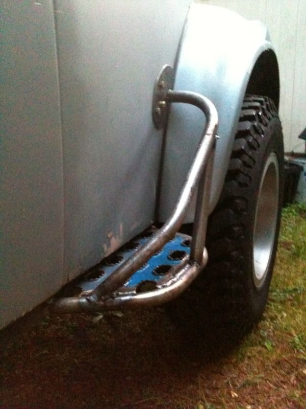

Re: Chris' car (aka, "project on back burner, building Ark")
Sadly I began working on this project again as it looks like it's going up for sale...Tonight I made the final two roof rack mounts, still need to gusset and finish things, perhaps add a license plate mount, etc. I also installed the first of the nerf guards I've made for the rear fenders.
