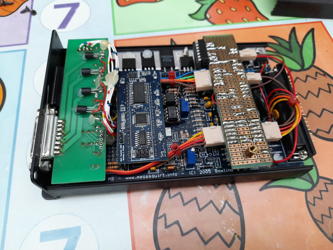

Small update, tested the ecu today, and I got an rpm signal directly! No modifications done to sensor, wiring etc, so it really was the ecu. Only had time to run it on the driveway, so didnt run more than 3500rpm, but it looks good so far!
Some pictures of the ecu upgrates. (Need to do the coil wiring some day. :mrgreen:
From left to right on the green proto pcb:
VR-conditioning for timing, Hall circuit for trigger, oil temp sensor input, oil pressure sensor input.
Updated the wiring inside to the pcb connectors:
Maybe I have some time tomorrow to test it on the street. :-)
Enjoy the weekend!
