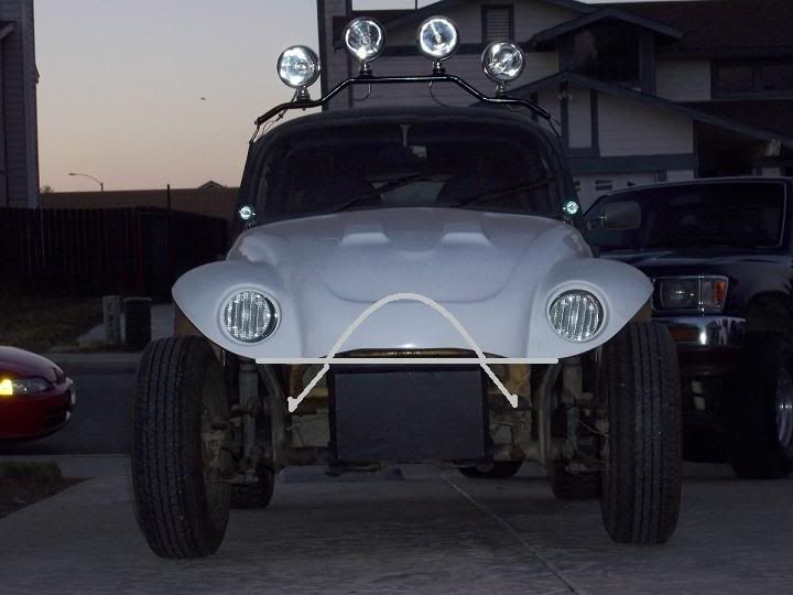

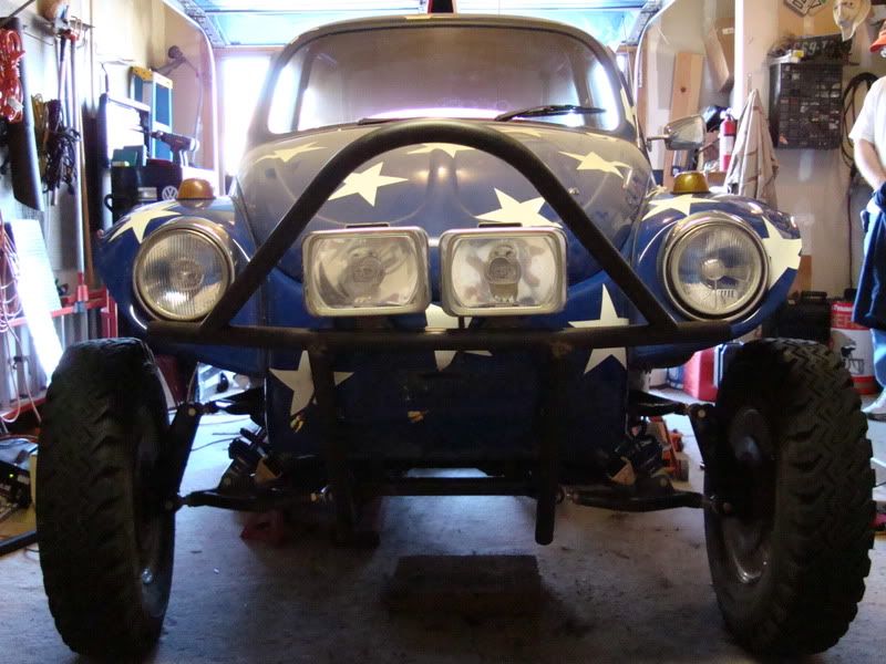

i'll get some pics. i have some new ideas for the front bumper. that one was made from some pieces i saw laying by the car one day and i got a quick idea but it didnt turn out the way i thought it would
tikotiko
Posts: 2904
Joined: Tue Jan 22, 2008 10:50 am
Post by tikotiko »
let me know what you guys think. i was also thinking of add some aluminum the the to side on the bottom or should i just leave it like that

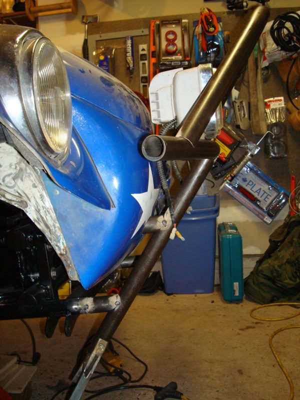

Tiko, that drawing looks a lot like what I built for mine.
The A arm setup pretty much forced me to have the sides straight up and down to give the most strength (IMO :D )
I still have some bracing to do, and I haven't decided if I will do any small 90* hoops to hang under the cross bar and tie to the supports where I can mount some small fog lights or not. Most likely not at this point, but it wouldn't be hard to do in the future if I need more lights :wink:

hell ya bro that looks just like what i had in mind thats cool im glad i got to see the real deal first

whats it look like from the side
Big Dave
Posts: 3208
Joined: Tue May 17, 2005 4:31 pm
Post by Big Dave »
tikotiko wrote:whats it look like from the side
I'm not sure what you mean... I did post a side view.
But not a lefty. :wink:

im trippin i had a brain fart i see it now thanks dave

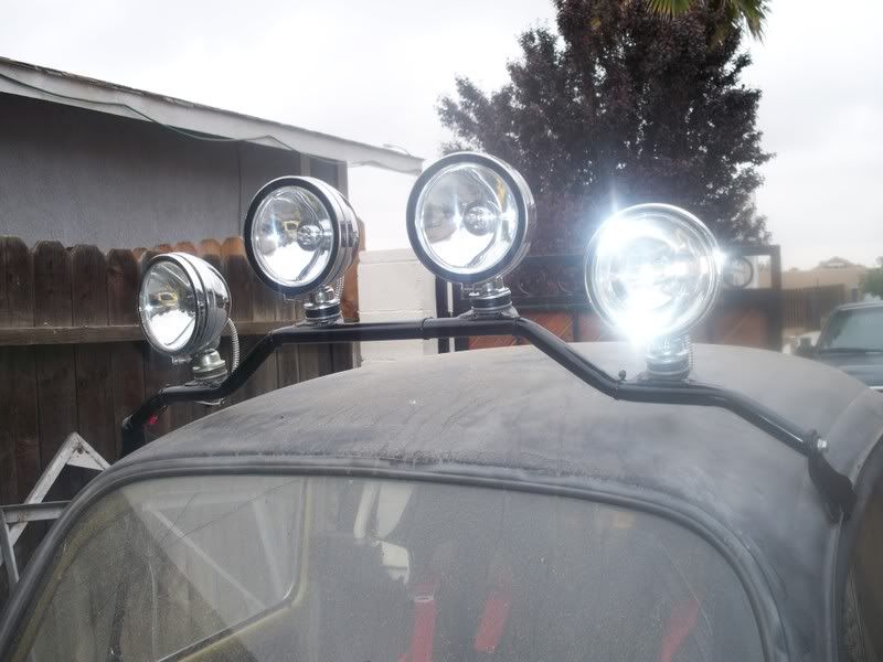

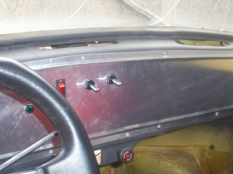

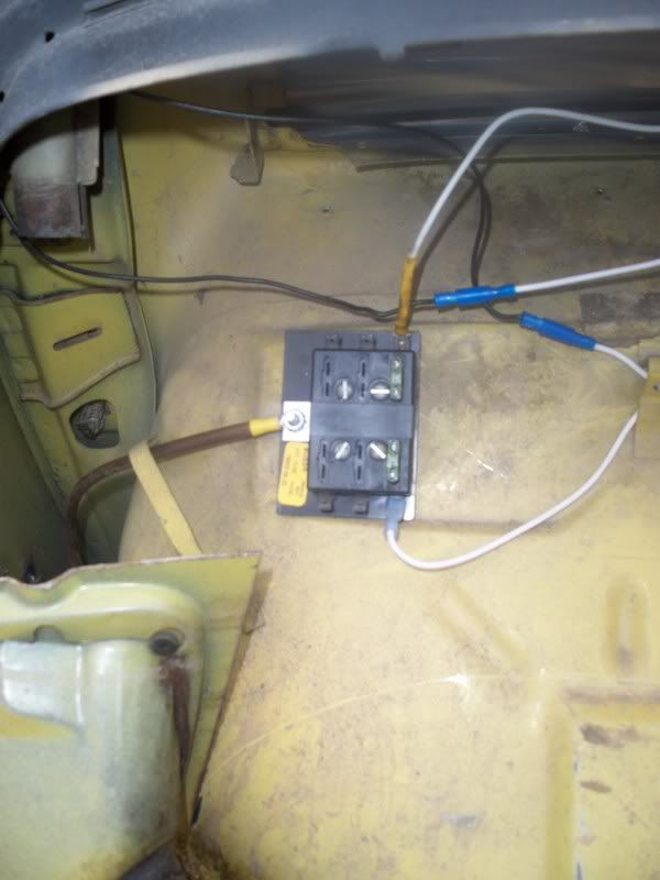

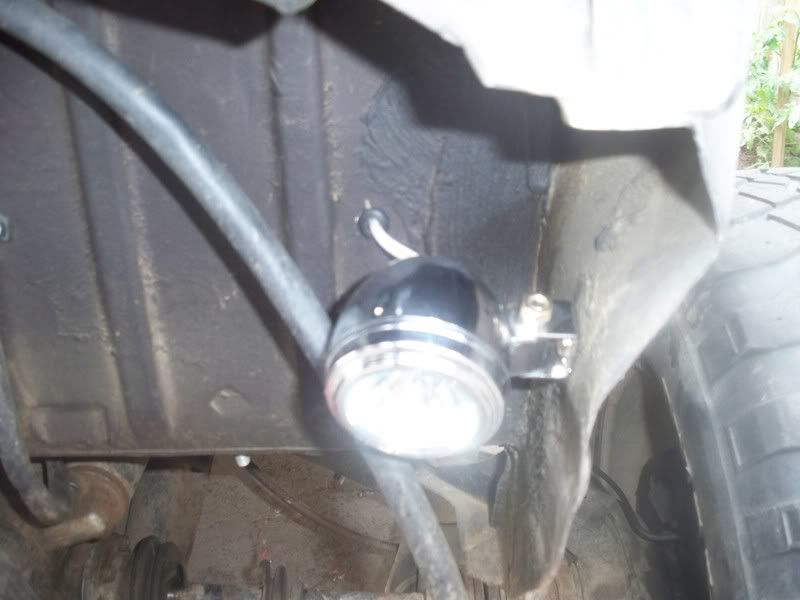

more little progress lights are bright
i wired the rack
i used a 6 circut panel still gotta clean up the wiring
added a switch for the 2 middle lights
and i was told to add a light to be seen in the dust so i took the bullet lights off the front and added one to the back
i'll only be running 4 lights at a time when needed and i'll be making a new light rack soon when i get some time and money. and hopefully i'll have the new front bumper finished by tomorrow.

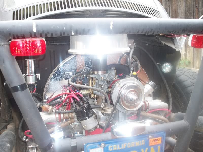

is there a way to see if my fuel pump is pumping correctly?
rickosuave1987
Posts: 4640
Joined: Sun Oct 29, 2006 7:15 pm
Post by rickosuave1987 »
Make sure the float bowl is full of gas, remove the fuel line going into the carb and put into a safe container then start the car. You can see if the pump is pumping. Just be very careful not to spill or let fumes near anything hot. Maybe use a longer length of hose than the one thats on there...
Baja
HookIt
SuaveRacing FaceBook
and have a fire extinguisher near by.......
