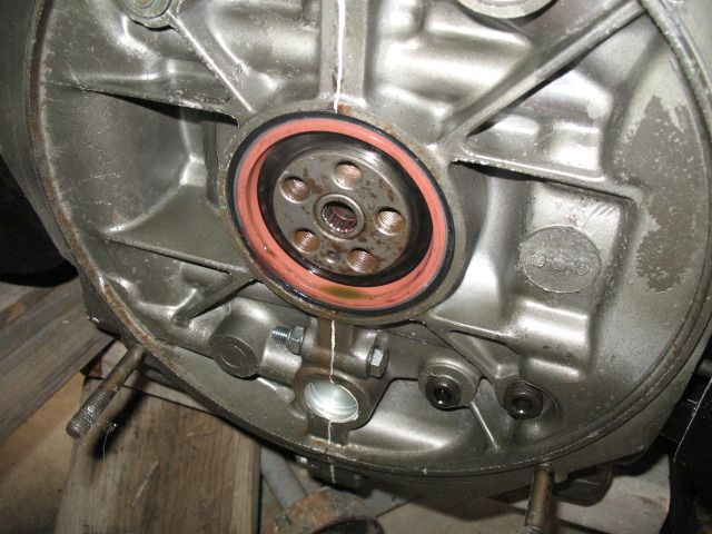

Looks like the front seal is not working properly. everything looks to be in order though. Is there a chance that I have over filled it with 3.7 quarts causing this? Since I don't have a stock dipstick, I am not sure how much oil should be in the engine with remote mount filter & oil cooler.
Posts: 22858
Re: 1911 build (need advice)
Are you driving the seal in just flush?
Ray mentioned some blocks are cut different there and need a deeper seal.
I have always just driven flush.

I have had one engine where just flush would eat the seal immediately on startup.

YEP! 8mm and 10mm seals.....
SEAT the seal FULLY.

I agree, the seal needs to seated all the way in. And there has been an issue with that particular seal from others, I had to replace one on a recent build. The spring in the rubber seal was weak compared to the one that I replaced it with.
How is the sealing surface on the flywheel ? And you did replace the crank seal in the flywheel. It looks like it is leaking past the flywheel seal.
And I usually tap all 5 Main galley plugs.

The seal appars to be set just inside the case (not flush) and it looks to be in great condition. I have a new seal & the one that is installed looks identical to the new one. It does not look damaged or worn in any way. Maybe it is leaking around the outside of the seal? I can faintly see where the seal was in contact with the FW & the the new seal fits snugly at this area. The surface of the FW looks very smooth & shows no wear. There appears to be a seal like an O ring in the flywheel. I did not install any of these seals as they were included with the short block build. The leak was fairly bad - probably leaked 3 - 5 TBSP of oil in the 20 min break in period. Could I take the spring out of the seal to compair with the new one?

Richard was asking if you replaced the oring in the flywheel (crank end) seal.
Those get hard and take a set over time, and generally should be replaced every time the FW comes off.
It generally won't leak a LOT, but it will leak if it can.
