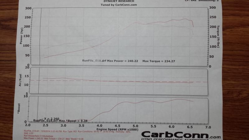

Dyno day yesterday went very well. Mario and I did a little street tuning before and after the dyno session. Idling on closed loop now and it's rock steady at 1,000rpms. The IAC wasn't the answer, it's the timing that made the magic happen. With this ECU we're able to change timing as aggressively as need be, per cylinder ignition event to maintain a set rpm. Works amazingly well.
Once we got strapped down we tried a few full pulls to see what happens. 246hp at just over 14psi on a rough tune...I was not expecting that! The power was not falling off up top, so we set fuel/spark cut at 6,800 to be safe. That's over 130mph on the roller, and really fun
! We spent quite a bit of time doing light throttle cruise tuning from 10-25% load thanks to the sweet dyno. We made a few more full pulls at the end for good measure, 16 pulls total. We found the boost was ramping up slower than before and found intake temps over 130F, previous logs were around 100F. We had a fan strapped to the spoiler to keep from heat soaking the charge cooler and oil cooler, it didn't get turned back on after our lunch break. The ECU was compensating for the rise in IAT, slowing the spool. With the fan on and a few more tweaks we made 240HP/234TQ on a conservative 11psi tune. The power curve is basically mirroring the WG movement, so we smoothed that out on the freeway after the dyno. Not exactly the best combo for a heavy baja, but fun none the less
. The dyno operator chastised me for building a turbo engine with a 108LC cam, but he complimented the overall setup for the flat power curve up top. I think I see a cam swap in my future...

Very impressive! Whats the problem with 108lc? My 108 cam encourages spool way faster than the old 110lc setups did.
