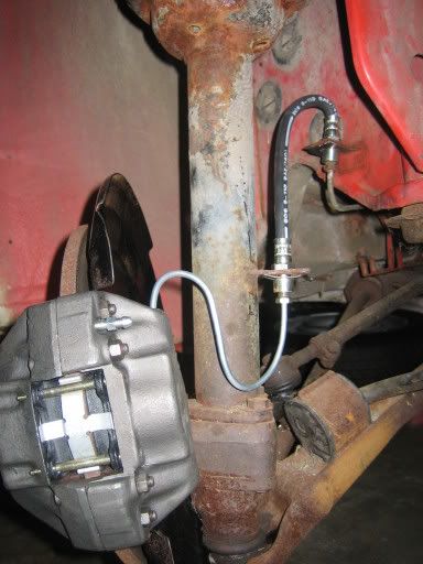

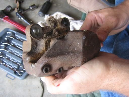

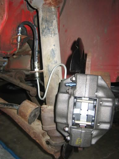

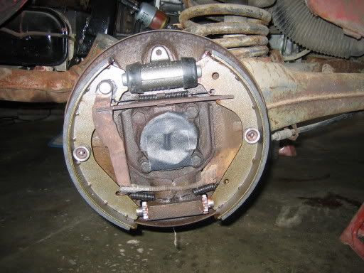

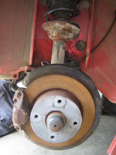

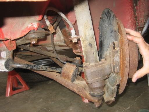

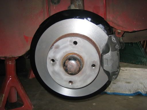

The brake system needed to be gone through next. For the fronts I had the rotors turned, got rebuilt calipers, new pads, rubber lines, and had to make a few metal lines. (after a few skinned knuckles :laugh: )

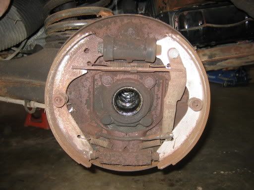

Here are a few before and after pics:

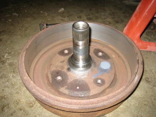

The rears followed with new shoes, cylinders, springs, turned drums and some good old cleaning

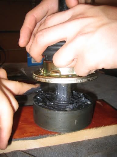

Another fun and greasy part to rebuild was the axles. This car has pretty low mileage so luckily the CV joints didn't look too bad, they just need new boots.
