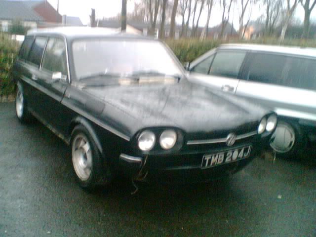

Hello, I swapped out the 412 struts for the original struts with the cut springs.
Now I have the 2 unmodified struts Which are odd :shock: tthe springs are different lengths, ~2". one is the same as my 411 strut and the other will be the '74 412 that they came off.

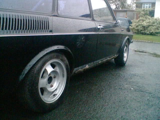

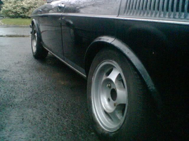

There is about 45% of the springs already removed. I moved the lower spring platform UP 35mm and moved the upper spring platform down to the centre of the spacer the fits on the shoulder of the damper shaft. It now rides great and looks just right for a daily driver :D And in less than an hour it can be 1" lower again by relocating the upper platform.

dude your car looks rock hard looks a good stance as well mate :wink:

MattKab, nice job! Thanks for sharing pictures!! :D

MattKab, I like the stance!! How does it handle? You said it rides nice but how does it take the twisties? ;-) You've got a great start on a cool car, I'm jealous. :)

Looks mean Matt!

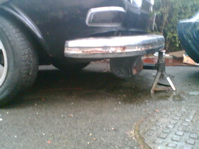

Tonight, I treated all the underside above the rear bumper, chased the bumper bolt holes, refitted the bumper and the rear valance, which is a nice panel :D I even touched up the paint chips with gloss black, wow what a difference! I'll get a pic for you all 2moro. The exhaust is the old thunderbird with a very effective toyota 316 silencer and custom tailpipe. The silencer was mounted (by Arry, my pal) as close to the short collector as was possible. This means the WB had to go in at the start of the tailpipe, about 10" from the atmosphere. Notice the stainless pipe notch trim. It looks well respectable from the back now.
One other thing, when I pulled the parts from that 412, I also grabbed the rear springs and rear shocks. My 411 rear spring were cut too, so I fitted the uncut 412 springs and at the same time, I fitted the 412 oil filled Boge parts. The shocks I pulled off were gas charged and the ride hieght remained the same. Did my 411 Variant get stiffer rear springs than the 412 saloon? I think my stance will improve if I refit the gas charged rear shocks.
The bumpers are both straight but the rear is dull and pitted, the front is more like flaking or peeling. The car as you have seen is black, with blacked out lamps and dark tinted rear side windows. This is now the cars character and shall remain. When Arry had this on the road, he had a (boiled clean) rat's skull hanging from the rear-view mirror!

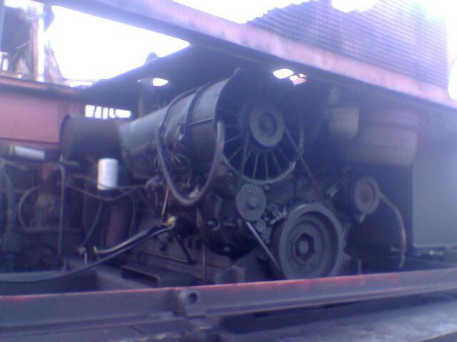

I really ought to show you a pic of the donkey at my local bone yard. it's got 10cm pistons and is really noisey and dirty:
101.6mm Venolia pistons and some pro turning, hmmm.
This is a rather freaky Poclain contraption with a thucked main lifting ram. The jugs are all mine if I can find a crane or digger that can follow its contribution :wink: :shock: This is the only engine there that still runs. How cool is that?

Two things I noticed: It looks better on your 411, maybe because your bumper is in a higher position?
Secondly: I think its too low for a daily driver. Its only 8cm above the ground...(thats about 3 inches)
