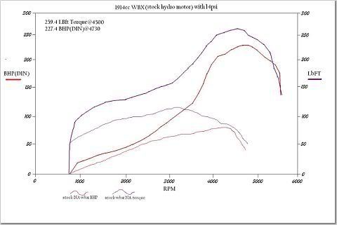

have a look at my stock 1.9 turbo post
the dyno sheet is no loading any more but the motor made 227bhp@4750 and 259ftlb@4500 with 14psi.
http://www.shoptalkforums.com/viewtopic ... sc&start=0
happy days 8) 8)

Don't see any pic's in the tread.
can u please mail me the dyno curve for comparsion=??
with my "NOS" hydros i have had the engine up to 7000Rpm.unstable oilpressure over 6500.- :)
stange u don't see more than 5000? maybe they are worn .
normaly i push it to ~6500.-
the DG engine has a lover duration cam than the DJ/MV engine , that maybe makes it produce power @ a lower RPM

got it to work
i had so many hard mile in the motor the springs could of got week, i cant realy remember is was over 4years ago :shock:
also the hydros were some cheep new crap from brasil :roll:
