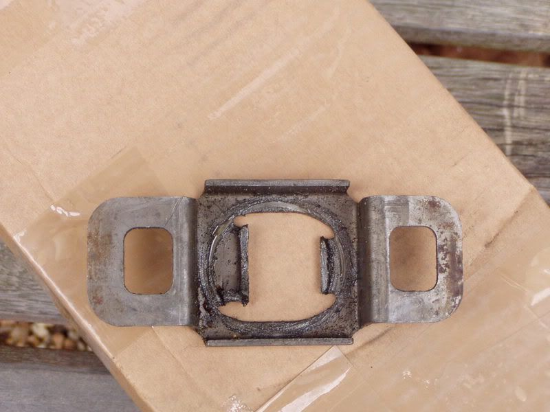

Just got rid of a quick shift bit of rubbish trying to improve my gear change and now I'm not sure if I have put this around the right way.
Does the short bit go to the left or right when it is in place at the base of the gearstick?
Cheers Guys

I am going off memory....so other chime in....but the small side goes right like you have it.
Don't bother even starting to try to adjust your shifter until:
(1) new from shift rod bushing
(2) Make sure that the plastic support disc at the rear of the tunnel is properly fitted.
(3) The rear hanger bar, mid hanger bar bushing and the tail cone bushing is properly centered and free floating as per factory.
(4) There is tight fit of both shaft couplers in the rear with no slop. Ray

I think I have found part of the problem, if not all of it.
The bush that goes around the front end of the gear selector rod is no longer around the selector rod but was in two halves hiding amongst the crap in the bottom of the tunnel.
I have been told that bush is the same as a Type 1 bush so have got one in, a quick look and it kind of looks like the rod has to be withdrawn from the hole it sits in at the front of tunnelto be able to seat the new bush.
Would disconnecting the rod from the linkage where it exits the rear of the tunnel give me the clearance required to seat the new bush or as I am now fearing the whole engine/gearbox need to be removed?
Bugger springs to mind quite quickly :roll:

Just disconnect the coupling at the rear and drop the rod down.
Its a tough job getting that bushing in. Very hard to reach.
The type 4 will also have other shifting issues. Everything else I noted must be spot on.
If the rear hanger bar bushings go bad...your shifting will suffer.
If the midbar bushings go bad over the bell housing...your shiftinmg will get bad.
If the tail bushing goes out...shifting gets bad.
If the coupler gets sloppy...bad shifting.
If any of the mentioned bushings is incorrrectly adjusted...and there are numerous adjustments in the system...shifting will be poor. Ray

But seeing how the bush is shot to pieces at the front I'll change that first then see what happens.
When ever I have the problems changing gear, finding second, it feels more like a linkage problem as you can feel it click at the bottom of the gearstick after wiggling the gear stick side to side and a little it is possible to find the "groove" for second and it slips straight in.
When I change gear slowly/carefully making sure it all lines correctly the gears slide in nice and easy both up and down.

I have got the bush in question at the front end of the shift rod done now. In the end I disconnected the rod from the ball joint connection where it exits the rear of the tunnel and links to the gear box. With a little gentle pursuasion the rod was then moved back far enough to fall out of the support bracket at the front revealing the hole for me to insert the new bush. I was then able to put the rod back into the new bush in the bracket, refasten the rear connection and the job was done within 45 minutes.
I am now awaiting the delivery of the little plastic cup the bottom end of the gearstick sits in on the shift rod and then I can see if it was worthwhile doing. First indications are there is far less slop on the rod so...fingers crossed
By the way Ray as far I can tell from you descriptions the other bushes and linkages all look in good order, shall be able to tell better when I can replace the plastic cup and can drive it again.
