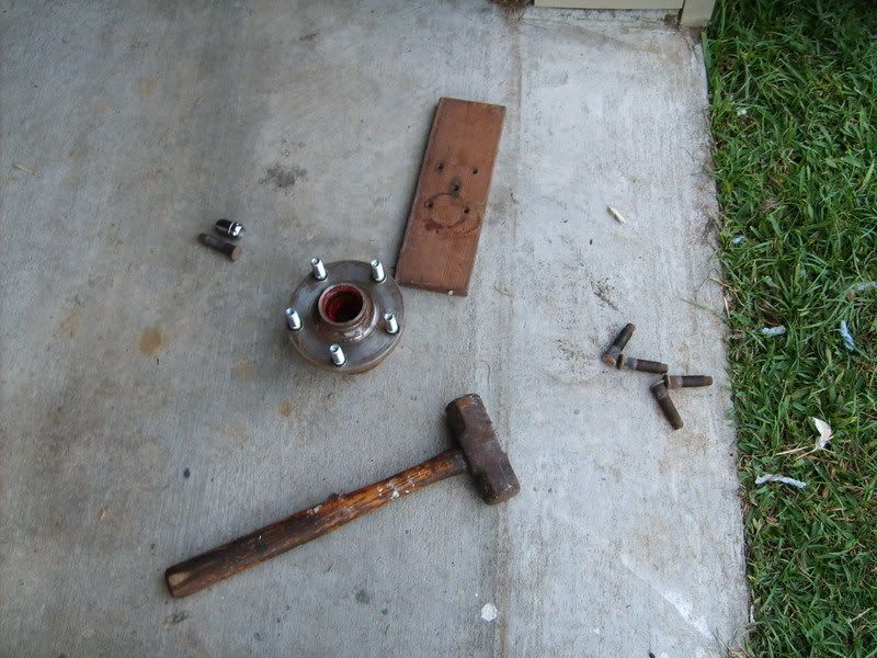

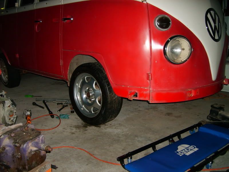

I've found one guy on thesamba who's done it to a single cab so far. I will need the BusBoys II kit as the arms have to be narrowed, a Gene Berg nose cone adapter 600A, and GB rubber mount GB641E. I also will need 17" axles from what I'm told.
Also of note, I'm going to be using Mercedes rims off a CLK. The bolt pattern is the same as a late bus(of which I've already swapped the front over on my bus to disks) but the hole size is different. Bus uses 14mm, Merc uses 12mm. Pop the studs out of the hubs and go down to the auto parts store and find one with a 12.5mm thread but the same base spline as the bus studs which is 14.77mm. Redrilling the rims to open the holes is NOT an option, they wanted $500 to machine the holes and put inserts(this is the right way to do this mind you).
Here's a photo of what I swapped over today, I found out if you just say you need Honda Accord studs and lugs you'll get what you need. With the Merc. rims you will need acorn cup style ones to center the rim, the same as stock nuts.

Popping the studs out of the front hub
The top is a stock Mercedes 12mm lug, middle is a Honda Accord 12.5mm stud with a 14.77mm base and lug nut, bottom is a stock bus 14mm stud.
The CLK rim mounted, I popped the center cap off, didn't need too for space I just didn't like it. A plan to go with some spike center caps a friend will machine for me.

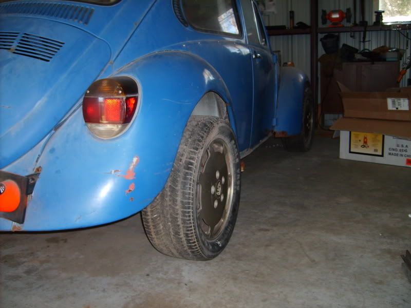

A picture of my super beetle with the 928S rims, slots, whatever you want to call them. These are mounted to 924T brakes which are essentially 944 brakes, no hokey adapters here. The car stops so well it'll put your heart up in your throat. No engine now though, awaiting a 911 motor I'm trying to get fired up, that's why the rear ends sticking up.
Not sure if I'm going to stick with these rims, Porsche twists would be sweet or a set of mini-lites.

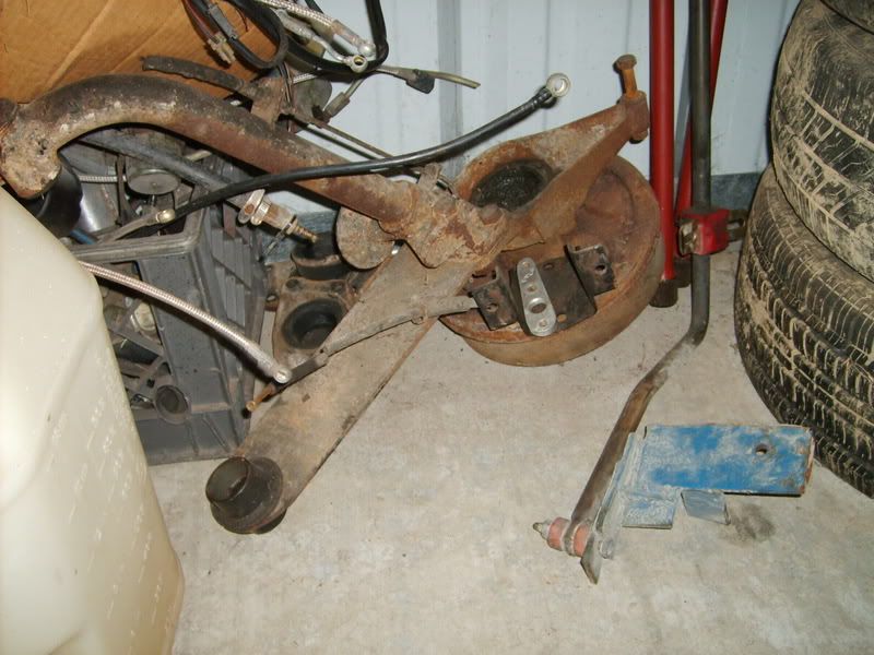

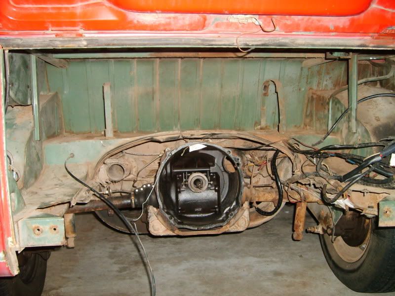

And so it continues, I have most of what I need now. After the bus dying in traffic yesterday it's time to coat the inside of the gas tank as it's rusting out...and I'm ditching the carb for injection.
I pulled the motor today and am going to strip the engine compartment to paint it. The blue tank is for the airbags, I'll have to redesign the brackets now as well for the bags after the conversion.

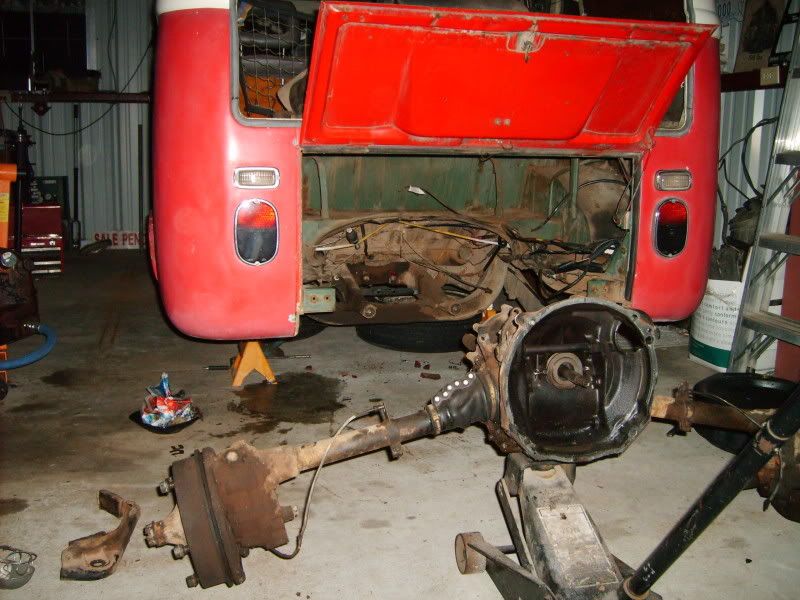

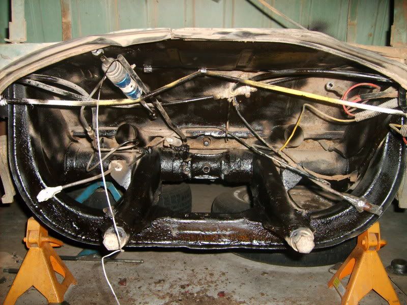

Have the rest of the junk cleared out of the engine compartment, minus the wiring of course, and getting ready to paint the area. Getting the rear apron straight will be the hardest part.

Post by Jadewombat »

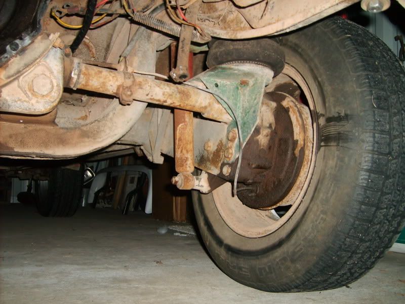

Got the rest of the running gear out in one swoop. Bye, bye swing axle. Next is to pop the spring plates off and start painting with everything bare.

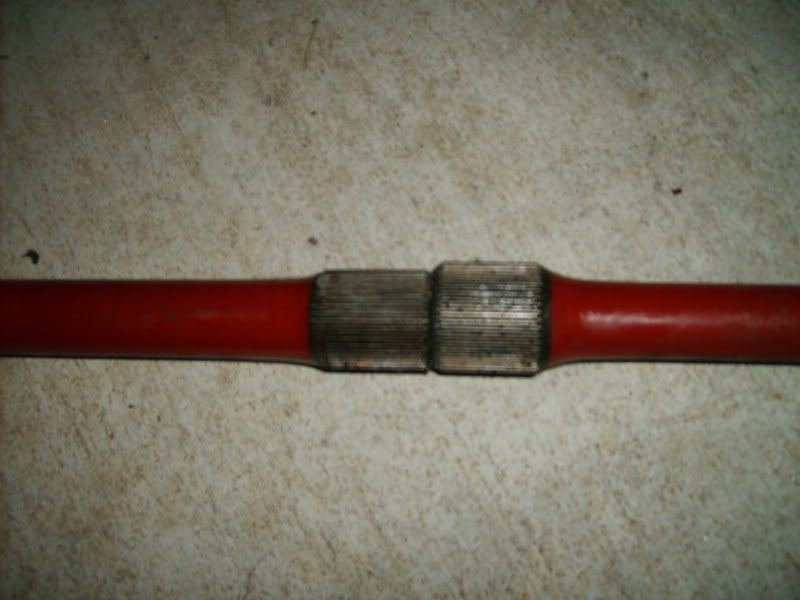

Came into my first snag last night. Got the spring plates off and tried to fit the IRS plates to the torsion bars, no go. The splines on the bars were too small. No big I thought, I grabbed the torsion bars from the donor mid-70s bus so I'd just use those. Those didn't work either, the inside splines on the IRS bars were too big for my bus. Several people told me the spline pattern was the same for all buses, not so.
I won't get into details, quick rundown though. You're doing this type of swap you need '68-70 spring plates to make this work. I requested BusBoys reword their catalog to SPELL this out as it isn't (they even list used spring plates as all being the same 68-79 in their catalog, even though they aren't). I've already located a used set of early IRS plates.
Today I got more stuff cleared out and undercoated all the hard to reach areas.
