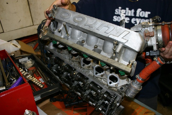

planning to weld a plenum between these runners , making it one piece:

The angle of the dangle may not allow a one piece manifold to fit onto the head.
Unkl Ian
Posts: 872
Joined: Sat May 25, 2002 12:01 am
Post by Unkl Ian »
With studs, that would be a problem.
tencentlife
Posts: 424
Joined: Tue Apr 25, 2006 8:13 am
Post by tencentlife »
I think you'd end up with overstress and perhaps cracking somewhere. If you water heat the manifold it would lessen, but not eliminate, differential expansion stress, but then you have a hot manifold making the intake air hotter, and a more complex thing to build vs. putting some tubing couplers in there which is simple and eliminates all those problems.

yes thats what i have come up with to.
and if i'm swapping head's or putting the plenum on another engine , tolerances will probably not make it fit right either.
