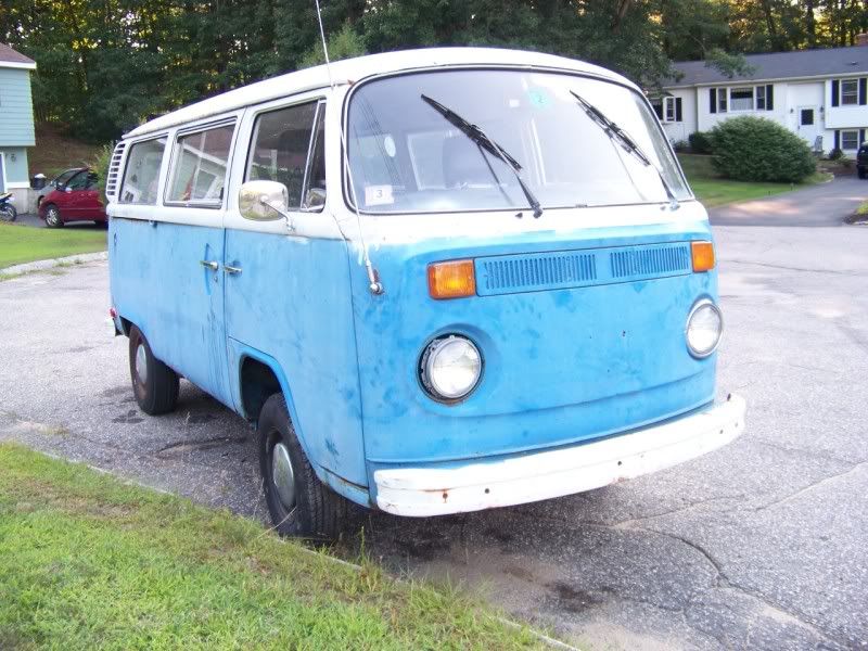

Ok, so time for some pics. Loaded up and ready for the 2.5 hr drive home. The Dakota did a decent job, not as good as a full-sized would have but I was impressed.
and at home finally

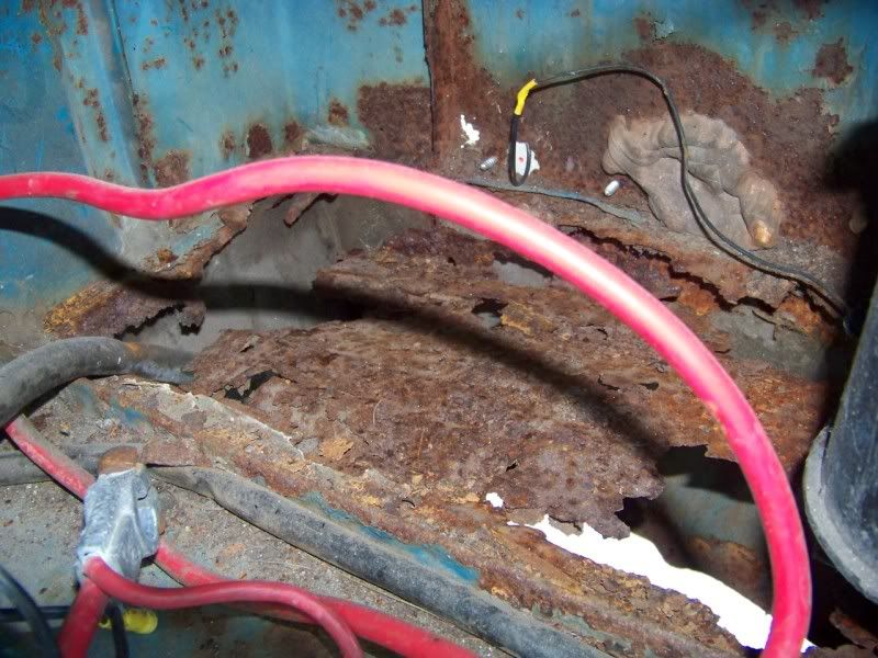

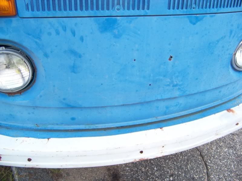

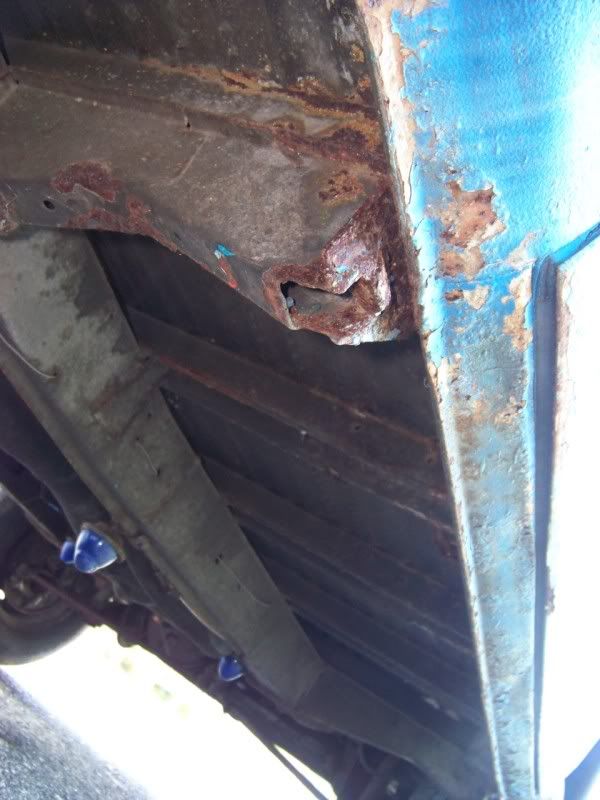

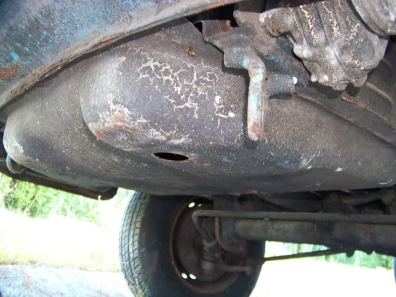

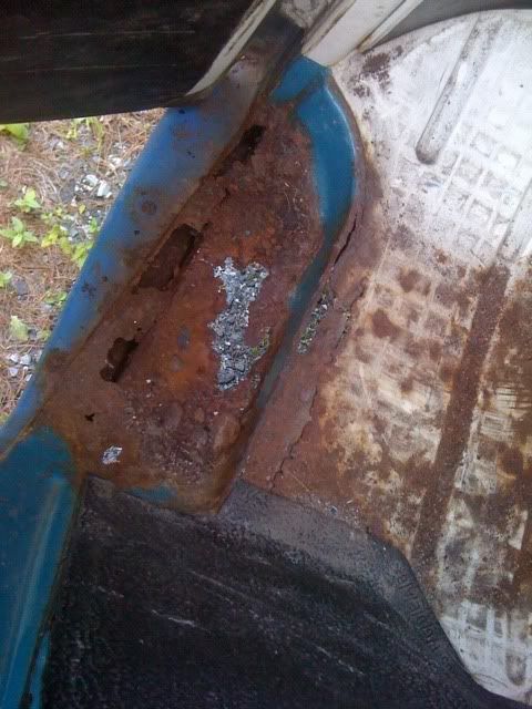

So there is more rust than originally met the eye but still very manageable and not bad at all for a New England bus. As expected, the battery tray

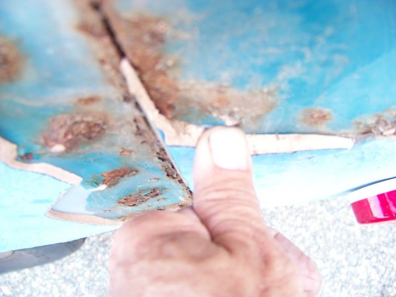

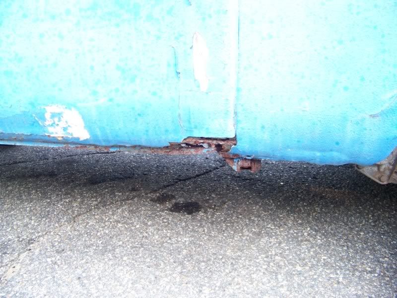

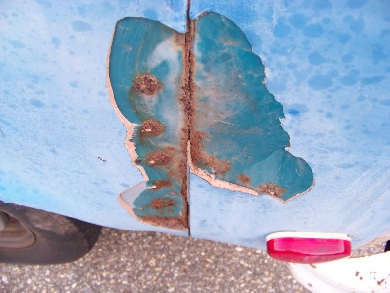

Rear corner seam...nice thin coat of bondo, huh? It's like this all over the bus but most of it doesn't cover rust but dents and dings.
Wider shot

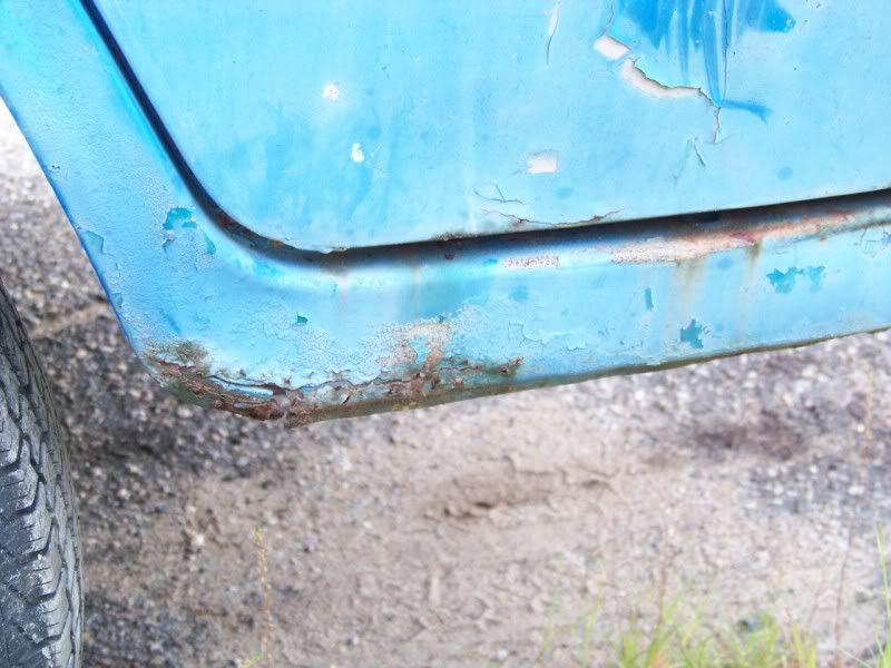

the worst I've found so far, drivers lower rear rocker area

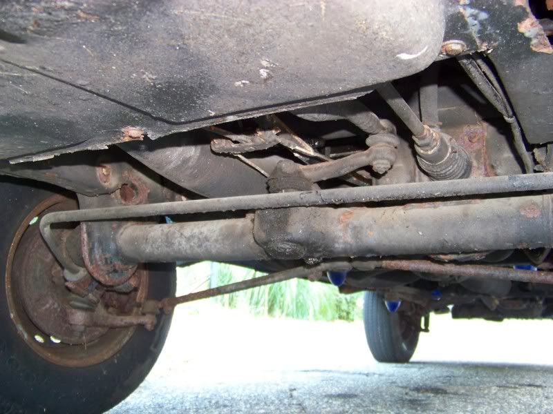

Very good underneath

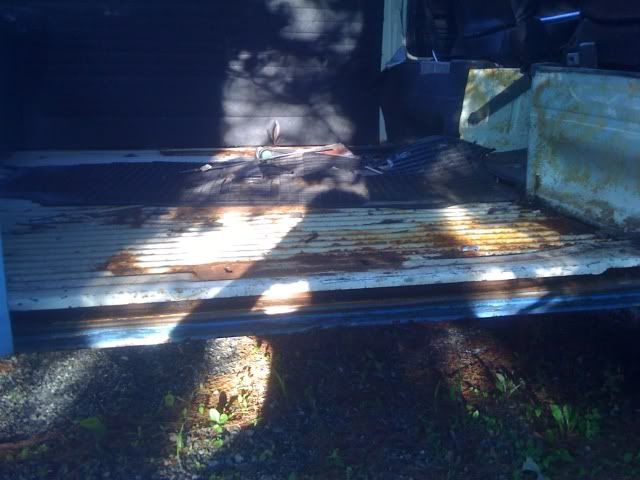

Slider

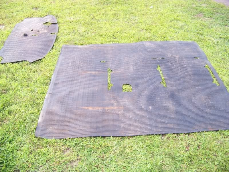

Original and not ripped mats

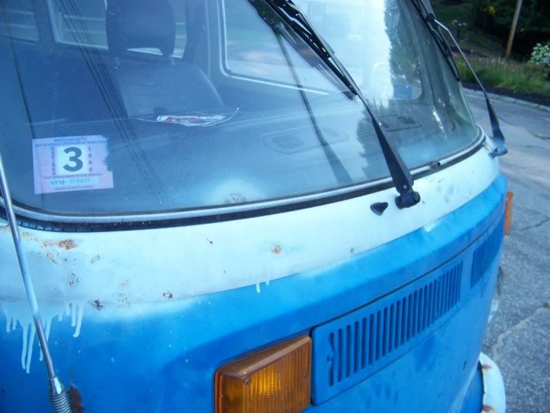

windshield area solid

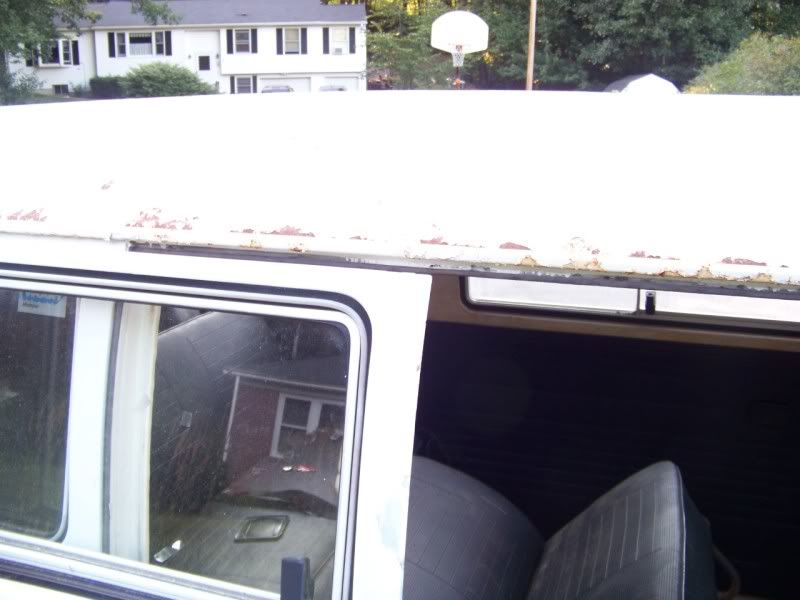

drip rail area just surface rust

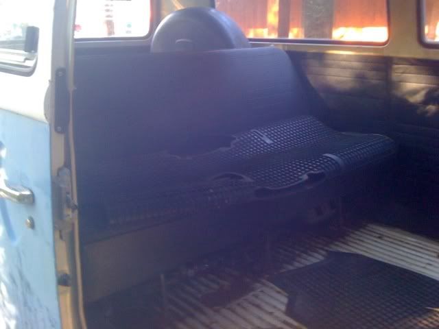

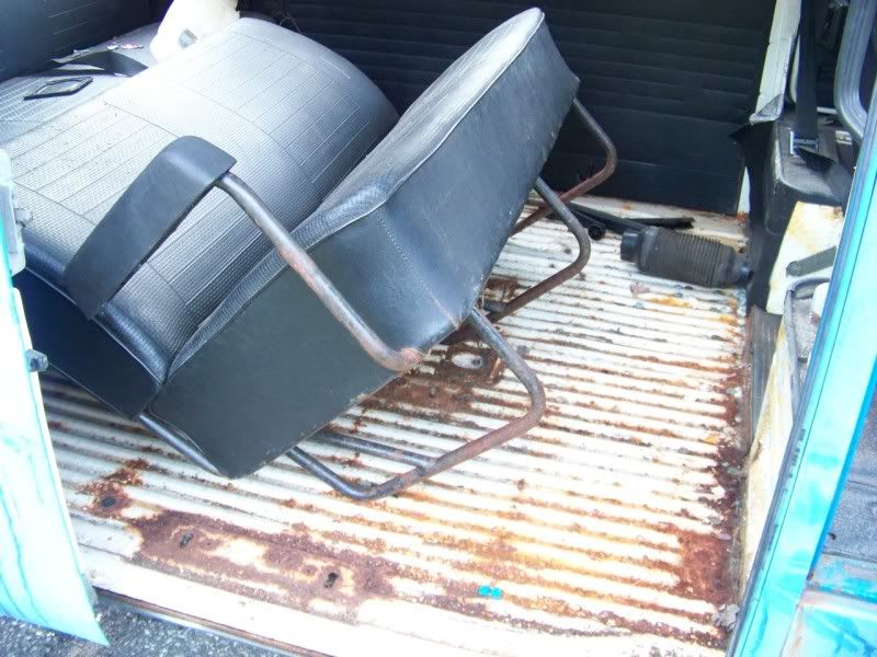

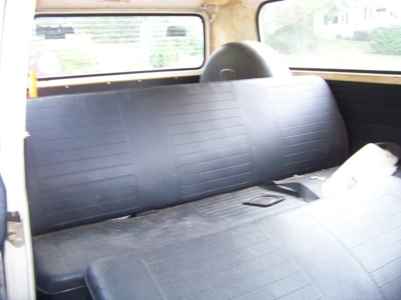

middle seat
look at the original seats, not a crack or tear in sight!

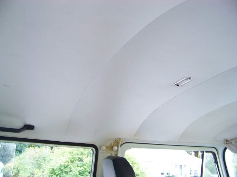

Decent headliner

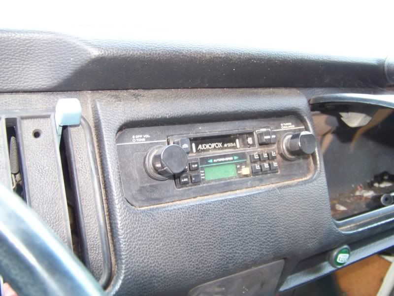

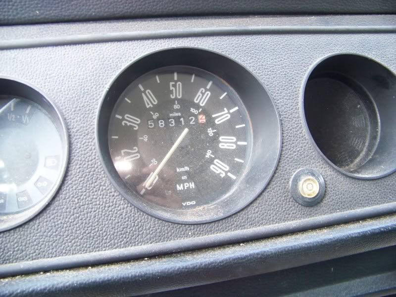

Check out the cassette deck, too bad isn't an 8track:)

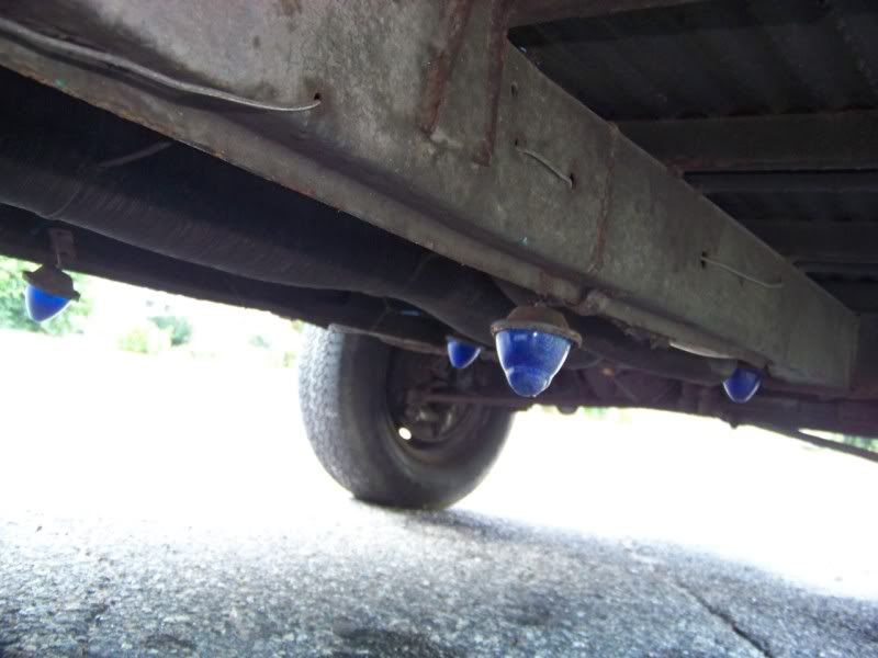

What are these for?
Ghetto neon...

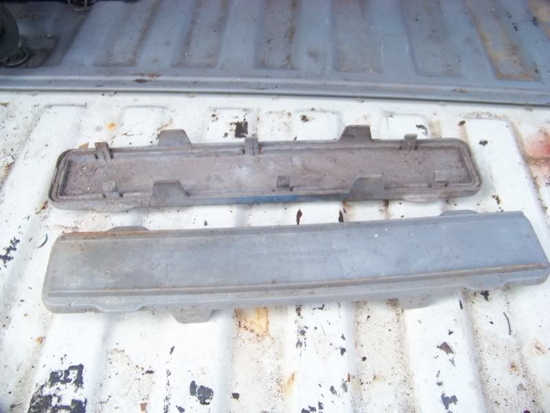

well not to throw a wrench at ya, but where is the air cleaner and AFM? that would explain the ehter bit...
the plastic thingies are the backs toe the tail lights. interior seats and such look incredible! I'll see this thing in person soon enough, gotta break in my engine so I'll be swinging by. you're missing teh intake screen for the fan, important cause you are gonna be sucking leaves in there. if she's been sitting you should pull all the upper tin anyways, because at a minimum there are acorns ontop of your oil cooler, worst case the squirrel is still there and has packed is goodies inbetween the cylinders as well. holes in the front are emblem holes. I have all the accordian tubes you can have em, I ain't getting heat any time soon. AJ has at least one good and one broken tail light lense, don't buy new they aren;t even close to the right colors, and bake in the sun in afew weeks.
NSU, that explains a lot, although nothing explains the neons. I just thought they sprayed too much and got runs.
