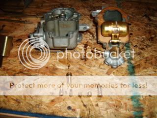

OK, I just got done driving this bastard 1800 miles from St. Louis, Mo to Los Angeles. Me and my dad did it in 33hours straight. Bug did great, till we got to Barstow, which was about 1hr from home. Blew out my sand seal going up and down the mountains, due to to much crankcase pressure. Anyway, I had to get a few qts of oil and keep it topped off every 20 miles. Got home, and let her rest for a few days. Alternator was shot, with cooked bearings. I found out this is almost common when driving over 6hrs straight. Whatever, got a new/used bosch for $40. Dropped the motor, cleaned it up, took off the carbs, and fan shroud and cleaned the oil and all the other crap off.
Now it comes time to reassemble. I put everything back in place, mount the motor, put the carbs back together, remounted them, charged the battery, and fired her up. No go. I loosened the distributor for some reason and knocked it when i was cleaning everything. Fine, static time it to 7.5btdc, until i can get it running and use my timing gun. K, turn it over again, runs like dog poop, which is fine cause my carbs will need to be re-tuned, but it is idling. Go back and mess with the carbs, nothing happening. I adjusted them the way the weber link says to, starting with the idle adjustment screw 1 1/2 turns in after contact with the stop plate, and with the mixture screws 2 turns from the bottom. I turned the mixture screw in and out and had no change, still idles at about 500rpm. Messed with the idle adjustment screw and then she just said "enough" and died. Hex bar linkage is off, so i can set each carb by itself. I ran it for about 4 min to get the motor warmed up. Now when i try to get it to idle, it wont...not..at...all. How the hell am i supposed to tune the carbs if i cant get it to idle!?!?!? The jets are the exact same ones that were in it for my long ass voyage, so i know they "work." But now i cant even get it to idle to tune.
I guess im just going to take them off this weekend, take them all apart, reset the floats, and hope for the best, and also check for vac leaks. Any other ideas would be great, and i appreciate it if you read this whole thing and can offer some advice.

One last thing. When i do get it started, and even though it doesn't idle, i can keep it reved at about 2-3000rpm, and it runs great. Constant idle. There is a slight rumble once in a while, like a backfire out of the exhaust, but not like a pop, more like a growl. It also doesnt like to go above 3500 without full throttle. So i didnt even bother messing with it anymore.
And yes when i got to Cali i adjusted the valves. All were pretty close to spot on, cept hot #3, it was about .003-.004. So had to loosen it up a bit.
