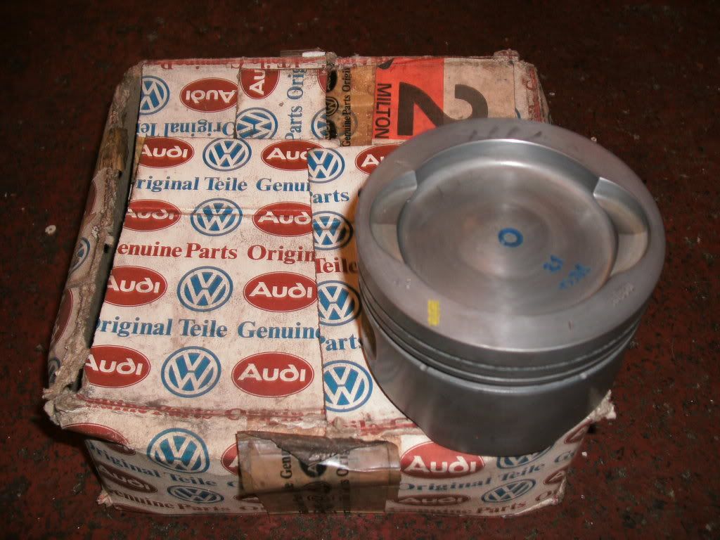

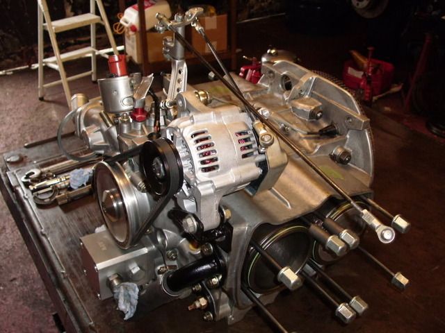

buildabiggerboxer
- Posts: 621
- Joined: Wed Mar 25, 2009 12:50 pm
Re: cofab pistons? again...
hey Jo, for some odd reason which i cant get my head round, the valve notches on the MV piston are shallower than on the DJ piston, its as tho VW may have wanted a bigger cam in the DJ at some point during its lifetime,
i'll try and get a piccy from the 'shop tomorrow.
what i did, after a pointer from fastback to run a 5.5 rod in my 2.5, was to clearance the pockets by hand with a die grinder, i had a web 86c and 44x 38 to accomodate with 1.4 rockers, i also sunk the valves to gain installed height. i did a quick calc; with a chamber at
55cc, (cut MV at 37cc and an 18 cc chamber) and a .035" deck, thats with an old used pre compressed ring, i have kept all the thin ones for exactly this, and came up with 9.7 scr. the same with a stock DJ piston on 76 stroke gives 11.7 on a stock 5.4 rod, but using the 'no ring' trick. ive run .030" deck with no problems before at 7500 rpm,shame you cant find a set of o/e DJ pistons and keep the 5.4 rod with T1 bolts, i recon they would clear the valves easy, short rod? good suck on the cylinder with the piston speed.. ill do the pic in the am...
regards.bbb
regards.bbb
buildabiggerboxer
- Posts: 621
I found gold..
they went in here...
