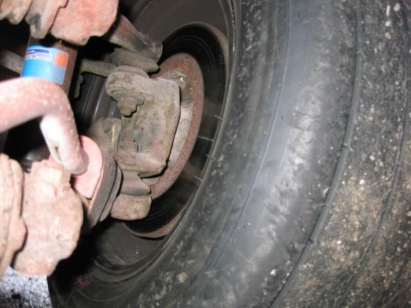

The KYB GR2's are a fair, entry-level, sporty-feeling shock. Bilsteins and Koni's also hold high regard. For more sporty racing coil-overs (I'm assuming you have Chinese EMPI's or the like) many go with QA-1 (old Carrera).
If you do make a change to the front suspension - you will change your caster (self centering steering) without making an equal change to the rear axle.
SWAY-A-WAY makes 15/20% stiffer, replacement torsion leaves too.
The dropped spindles are often a problem with wheel selection </=15", have you already chosen your rims? Smaller/lighter rims are fairly common in aggressive setups when braking demands aren't high enough to warrant something bigger/heavier.
OEM 'Ghia spindle w/13" rim vs CB spindle w/16" alloy rim:
