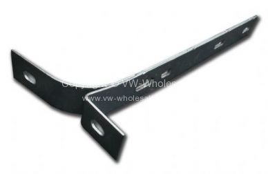

Here's what a `72-`74 bracket looks like:
The pre`72 bracket is thinner and mounts to the body differently:
The contours of the body sheetmetal are essentially the same, so you could fit earlier facebars (or even the "euro-style" that have no overrider bars) if you made up some adapter brackets.
Here's a `70/`71 bumper, and a euro bumper with the big late turnsignals. Note that they don't have much protection...

I pulled off my bumpers and my brackets looked nothing like any of these.Marc wrote:Here's what a `72-`74 bracket looks like:

Do your fronts look like these repops? http://www.karmannghia.com/viewDetail.a ... oduct=1339

Oh, I see what they did there. I didn't realize that the front brackets were truncated on the late cars with the beam-basher tubes, I thought the whole thing was in there...obviously not, and the "1972" bracket was only used on `73/`74s not sold in the USA. Everybody selling them lists them as `72-`74, I suppose if you needed one for a USA car you would cut the superfluous bits off of it...
