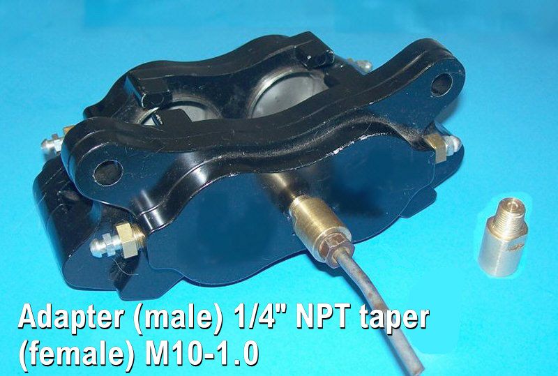

The lightweight aluminum clone caliper has four 44mm pistons, no dust boots (racing style) and four bleeders, two on top and two on bottom.
An 1/8-inch NPT threaded port on one side provides for brake line fittings.

BRAKE LINE ADAPTER
An important detail is the brass brake line adapter Lanner offers. The adapter fitting is metric M10-1.0, with the tubing terminated in a bubble-flare,
opposite of most US brake lines, which uses the inverted flare.
The adapter accepts the M10-1.0 fitting and screws into the caliper with its 1/8th NPT tapered end. Use Teflon tape.

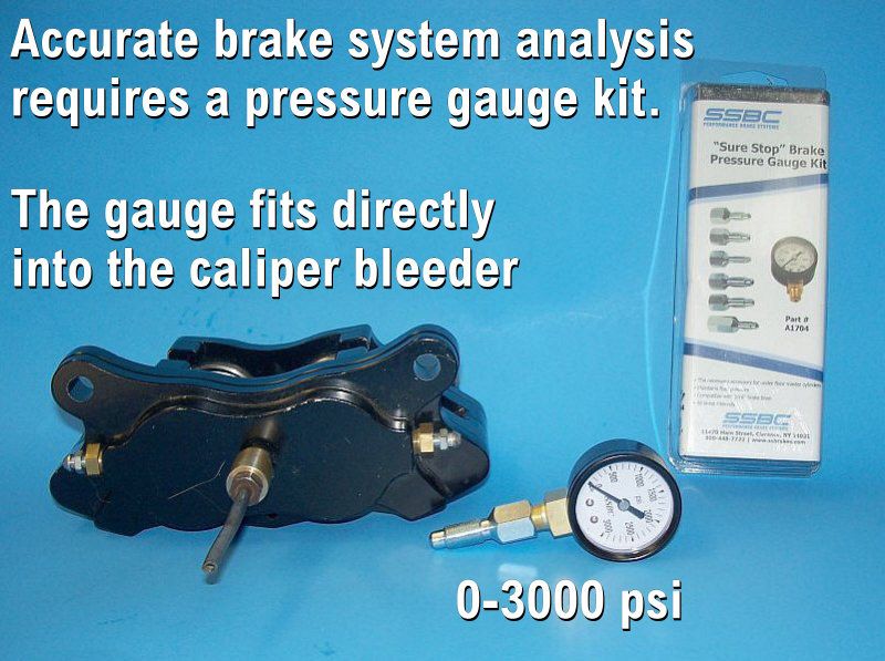

PRESSURE GAUGE
As a rule, brake pressure gauges are not part of the average mechanics tool kit. But they are useful and inexpensive. A pressure gauge will tell you if
you really are not getting the same pressure to one brake as another, or if a bad hose is causing slow pressure release.
For racing purposes, you want to know exactly what pressure each brake caliper is receiving, and how different are your front to rear pressures.
This enables intelligent brake tuning.

FJCamper wrote:Use Teflon tape.
Why? Everything I have read is that brake fittings are sealed not by the threads but by the inner mating surfaces compressed together. The tape is supposed to be capable of getting where it shouldn't and causing problems, though I doubt it would do anything at that point in the system anyway. I have used tape on bleeder threads to minimize air with a vacuum bleeder (for evaluating the fluid as it evacuated).
FJCamper
Posts: 2910
Re: Mounting Wilwood Clones
Post by FJCamper »
Hi Proctor,
Wilwood itself advises the Teflon tape. We're using it just on the brass NPT adapter threads, not on the original VW M10-1.0 threads.
The clone calipers are aluminum and the brass adapters tapered. You must be careful tightning the adapter. It can be overdone.
I use Teflon tape myself. I was having problems, not so much with leaking but air getting into the system; the Teflon tape stopped that problem. I was told that 4 wraps is what is recommended.
