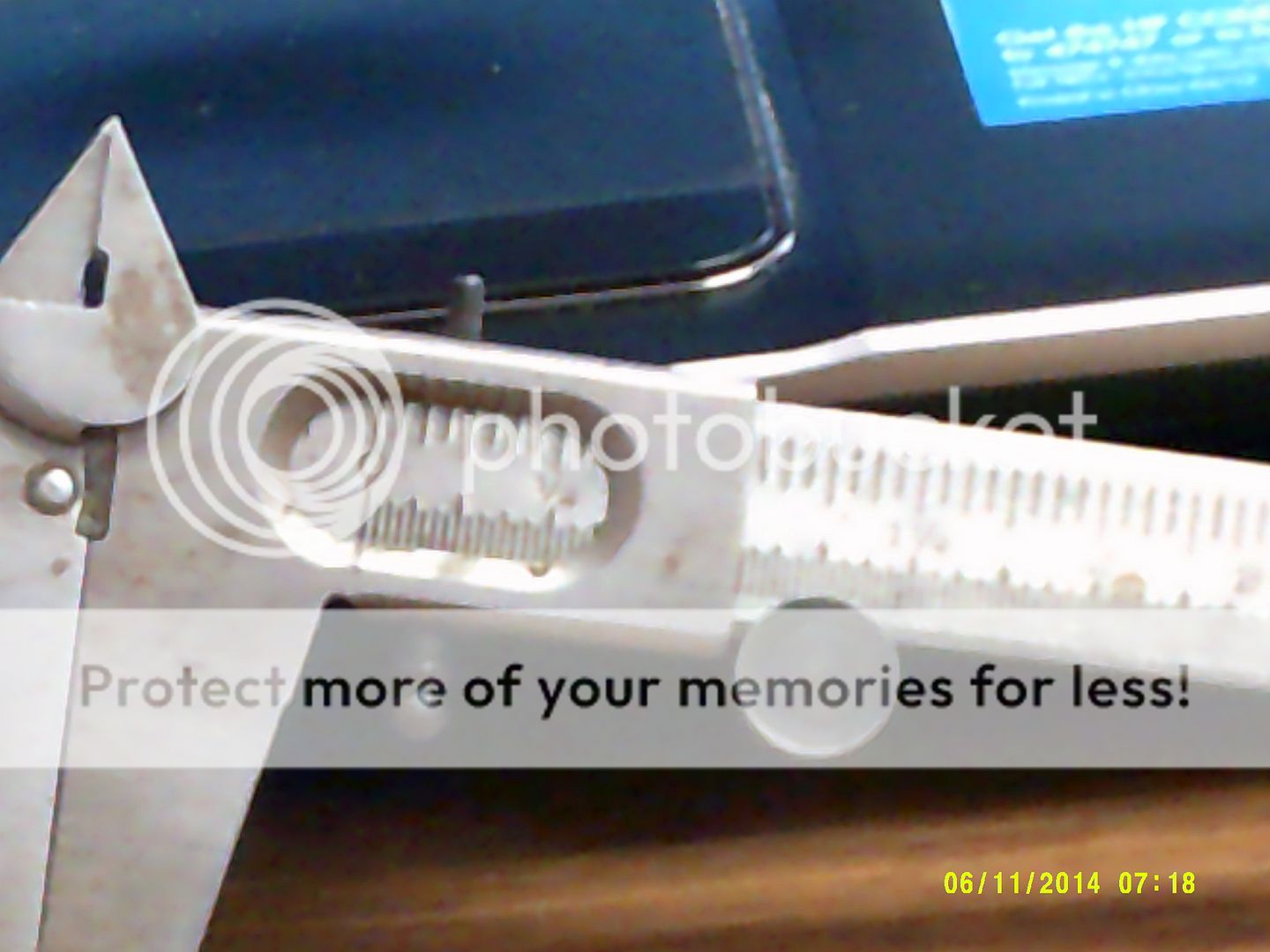

I watched U-tube videos on using a caliper. But most are in metric or measure in thousandths of an inch. I found an old caliper that shows 1/16th inch on the upper line and 1/32nd on the lower line. If I crack the jaws just barely so the zero notch is between true zero and the 1/32nd mark, the top scales meet at number three. So is the measurement 0.03/32?

If the caliper's upper scale is in 1/8th (.125) of an inch, and the lower scale is in 1/32nds of an inch then the first mark on the lower scale 1/32 (.0323) from "0" and halfway between "0" and the first mark would be a 1/64 th of an inch (.0156). I think that is what you are after.
3/32 is .0938 from "0". Do you need that converted to mm? http://www.slotcar.com/drs/gachart.htm for example but there are better conversion tables out there.

Stack up feeler gauges to various thicknesses and measure with the vernier calipers until you're confident that you can read it correctly.....

in school fpr aviation, one instructor mentioned this for learning.Marc wrote:Stack up feeler gauges to various thicknesses and measure with the vernier calipers until you're confident that you can read it correctly.....
then he mentioned that, in a pinc on non critival items, this is also a method for verifying calibration

I think you'd be amazed how few employees in a modern machine shop can still read vernier calipers. Even the dial calipers are becoming challenging since the "digital revolution". I still prefer the dial calipers over the digital version though. My batteries are never dead.

I bought a set of cheap measuring tools like this (http://www.harborfreight.com/6-piece-te ... 94447.html) mainly for the divider and spring calipers until I could afford a better set. To be honest I yet have had to have a valid reason to use them but I still have them. The veneer caliper that came in the set (look at the price of them too as that is pretty cheap for the whole set) is very similar to what crvc has but it is a combination of inches on the top and metric on the bottom.
Even after all the years of doing what I did for a living, I had to stop and think about the markings for a second.
What Marc said and Devastator backed up is wise advice; get a known standard and check out the markings to see how true (accurate) they are. I also would be suspect of the accuracy of the whole unit unless I verified each mark mainly because of the type of markings (looks to be stamped/formed/rolled because of the raised and dimple marks) I see and the material and forming methods used. I am sure that the ambient temperature is going to affect the accuracy some and you probably don't know what the standard's accuracy temperature is... assuming you are going to rely on it for any great accuracy (talking about temperature is a little overkill on information but true).
