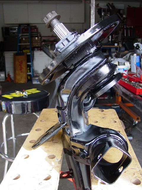

foreverska wrote:This might be interesting... the discussion of the axle nut got to me so I went out and checked it. I popped off the hubcap and what did I find in the rim? Broken lock wire. Started the car up and the nut spins in gear. Upon closer inspection one of the crowns of the nut is covering the lock wire hole so it's obviously loosened a little bit. Think that's all it is? I really should be working and I don't have any wire or else I would do it now.
What you see is a trailing arm minus the brake drum and the brake shoes. The threaded part of the stub axle goes down to the splines the splines in the brake drum drive through. I caught one of my axle nuts loosening up but got to it before too much damage was done; The noise I got was a squeak... squeak... squeak every time the wheel rotated. The torque spec on the axle nut is roughly 250#s and some people like to go much higher.

That's conclusive, the splines are stripped in the drum. The axle nut is supposed to be torqued to ~220 lb-ft, no cotter pin or lockwire can transmit the torque needed to drive the car for any useful distance. In truth, if the nut's torqued to spec the cotter pin isn't even necessary.foreverska wrote:...Started the car up and the nut spins in gear. .
Because the drum is made of a softer, cast metal than the steel stub axle most of the damage occurs to the drum - but often the splines on the axle are also compromised some when driven loose for this long.
When you get the drum off, inspect the splines on the stub axle right at the inboard end...if there's a perceptible step between the last ~¼" that the drum never touched and the rest of the spline (run the tip of a small screwdriver along the splines to see if you can feel one) the axle is worn and should be replaced - another drum will be enough to get it back on the road, but if the fit is loose the new drum is more likely to work loose again (with the same eventual result).
