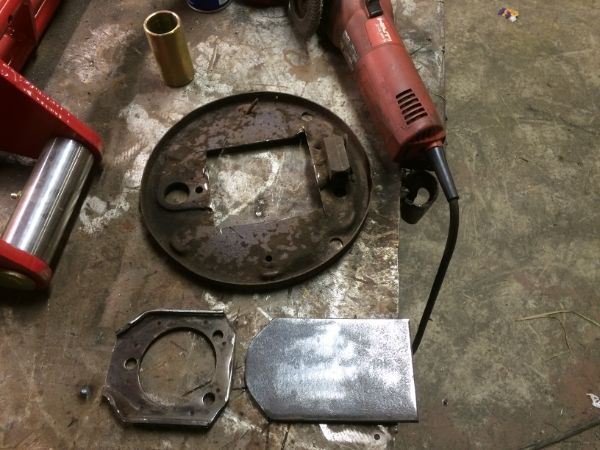

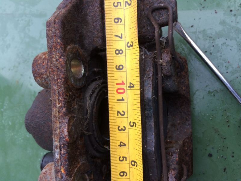

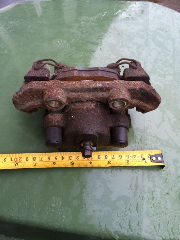

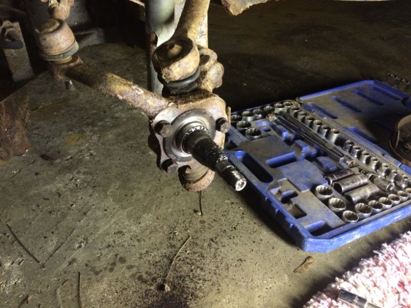

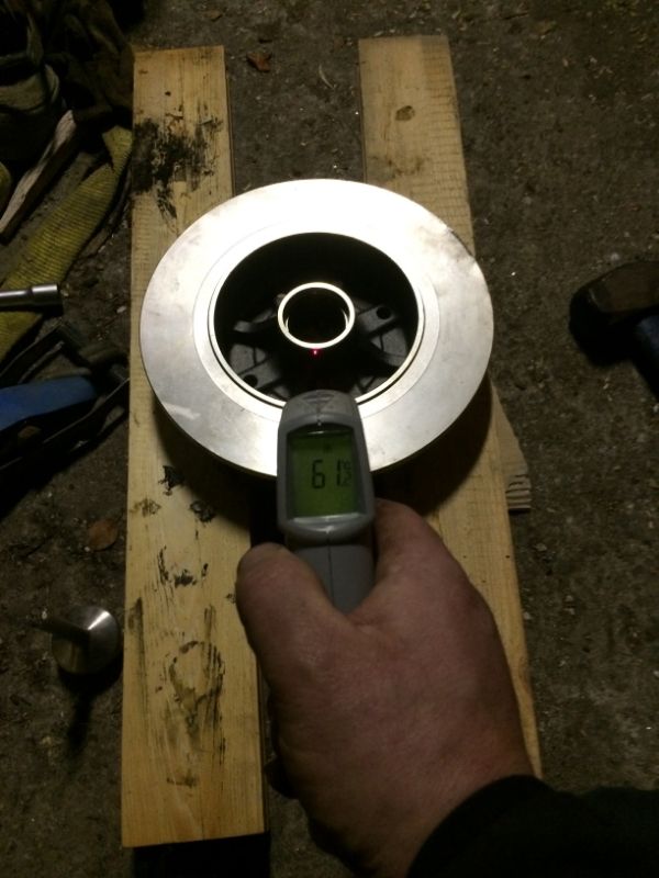

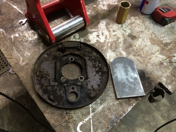

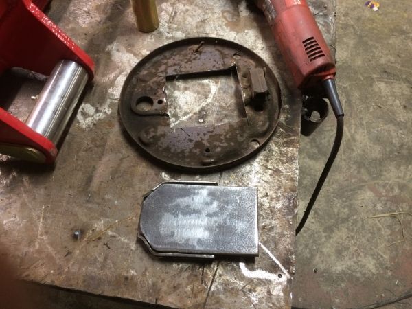

I'm not crazy about the idea of DIY caliper brackets, but if you're confident that you can handle making their attachment sufficiently robust go for it. Karmann-Ghia spindles that already have stout integral "wings" for caliper attachment are fairly easy to come by, though, so IMO they'd be a better way to go.
I see that you've got the late, hub-centric rotors - those don't fit on most wheels which were made for the earlier "bolt-centric" drums/discs so you'd better confirm that your wheels will bolt on before you go much further.
