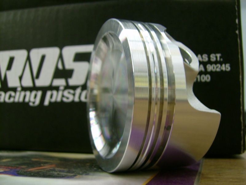

So I had my heads hemi cut and want from 59cc to 68cc. Then I had a friend water jet some custom .130 thick copper head gaskets. I then took 2 out of the three barrel spacers out. So I'm running weisco pistons and after talking to weisco decided not to have them dished. The pistons at TDC have zero deck height. You add the .130 inch head gasket and 68cc heads and I'm now at 7.4-1. As it turns out I didn't have a cracked jug like last time but had a leak between the head and the jug. So i had the heads fly cut ever so slightly and sanded that one jug with wet dry ultra fine sand paper on glass until the carbon deposits were gone. The motor is together now and I just got another set of copper exhaust gaskets. I will be filing down the all 6 flanges on the turbo header tomorrow to make sure they are good and flat. Wish me luck.
