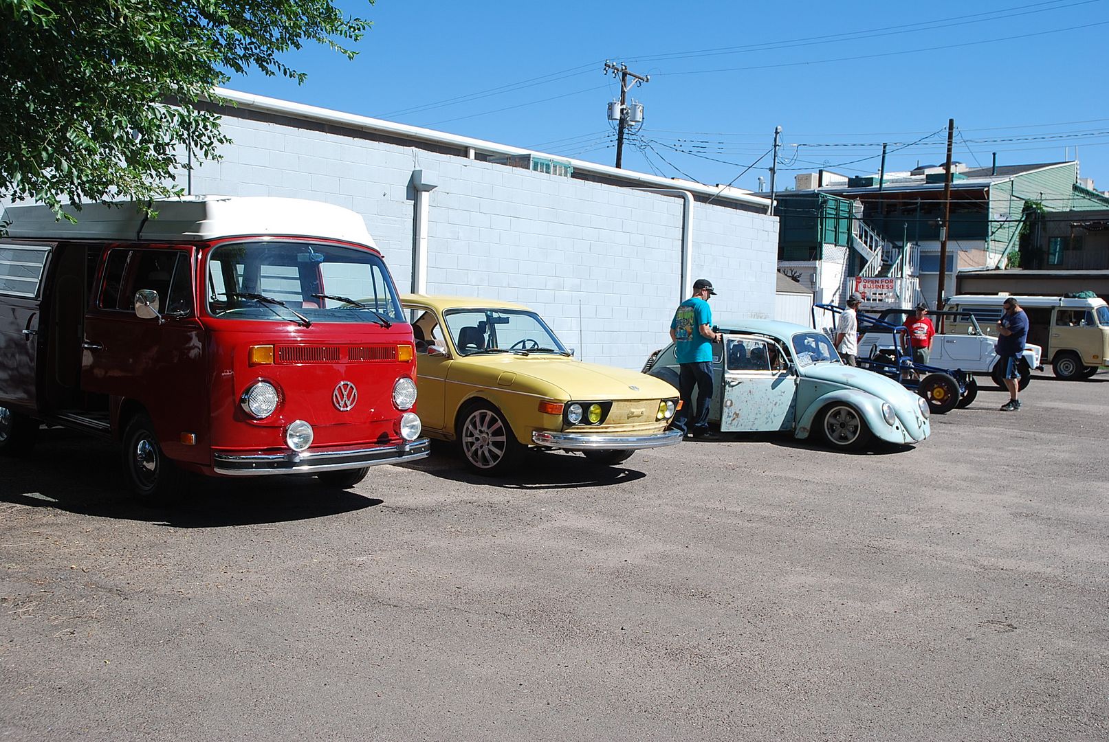

Anyway, I have been slowly trying to fix things here and there and get it back up to a status capable of daily driving, which I believe it is now. I host a monthly Cars & Coffee event at my shop and a loal VW cluub uses it as a jumping off point for their weekly cruises. I just started up the Cars & Coffee events again, so thought I would take the 412 on the cruise. Other than driving it to and from the shop a handful of times, this would be the most miles I've put on it (maybe 50) and on a sweltering hot day, and through some very slow driving traffic.
