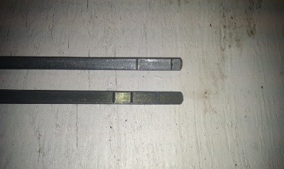

so are we saying that on a stock T4 1.7 engine
that its ok or good to put an extra quart in it
maybe the 914 "Porsche" stick has the provision for the extra quart?
Dipstick comparision, 411 VS 914/4
- Posts: 22758
Re: Dipstick comparision, 411 VS 914/4
sharkskinman wrote:so are we saying that on a stock T4 1.7 engine
That's basically how it looks.
The blocks are identical.
Drained and topped up the oil in my 914 today, the difference in volume at the different dipstick marks are are as follows:Lars S wrote:Just discovered the difference in min/max marking on the dipsticks for a VW411LE and a 914/4, both from -72. As you may know the two veichles had almost identical 1,7 80hp D-jetronic engines.
The min on the 914 seems to be the max on the 411, despite this the sticks are identical.
In addition to this the 914/4 had a some extra arrangements in the crankcase to prevent high sea in the oil (at least from some year model).
/Lars S
The lower stick is the 914/4 one.
Upper 411 mark to lower 914 mark: approx 100ml
Lower 914 mark to upper 914 mark: approx 350ml
That's OK with me but why does the 411 and 914 manuals list the same oil capacity?
/Lars
can you try the 914 dipstick in the 411 and vice versa? I would be curious to see where it reads. The 914 reads in a different location (?)
- Lars S
- Posts: 321
- Joined: Sat Jul 07, 2007 12:25 pm
Yes I can swap the sticks between the two cars and the dipstick location and the dipstick tube length are identical.
/Lars S
