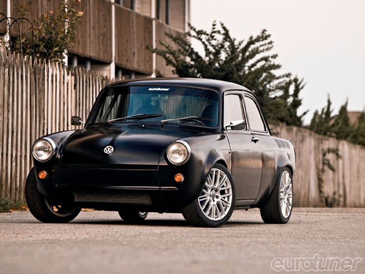

- Soul
- Posts: 281
- Joined: Tue Jan 28, 2003 12:01 am
- Jadewombat
- Posts: 1447
- Joined: Sat Jun 22, 2002 12:01 am
Re: ProVolks Official Shop-Car Build Thread. . .
Man, that notch is too cool.
You've looked on the ebays for flares? I got mine for my super beetle for ~$150? new for a Datsun Z car. Very similar to those Corolla ones above. They fit really well.
- Posts: 22779
Droolworthy Notch.
A std Mk1 chin spoiler would really finish it off.
(they are already black, and wouldn't drag)
Looks like he could have used a bit wider tire out back, given more backspace on the rim.
- aircooledtechguy
- Posts: 1709
- Joined: Sun Oct 28, 2001 1:01 am
OMG!!!Soul wrote:
I'm speechless. . . Super cool car!! Thanks for the photos and inspiration.
- supaninja
- Posts: 1658
- Joined: Tue Sep 14, 2010 12:48 pm
Isn't that the notch with the vr6 in it?
'65 notch w/ a squirted type 4
