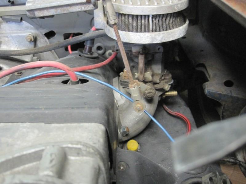

https://www.thesamba.com/vw/forum/viewt ... 40#9353440 (Carb Manifold Mod)

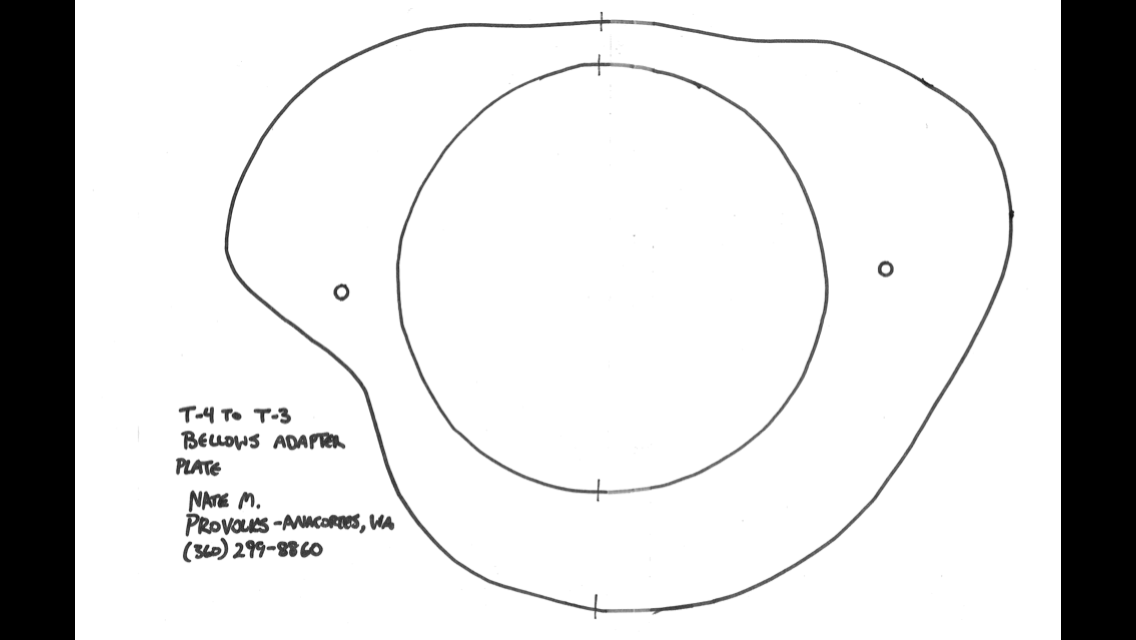

https://www.thesamba.com/vw/gallery/pix/2048486.png (Nate's mythical t3 bellows adapter template)

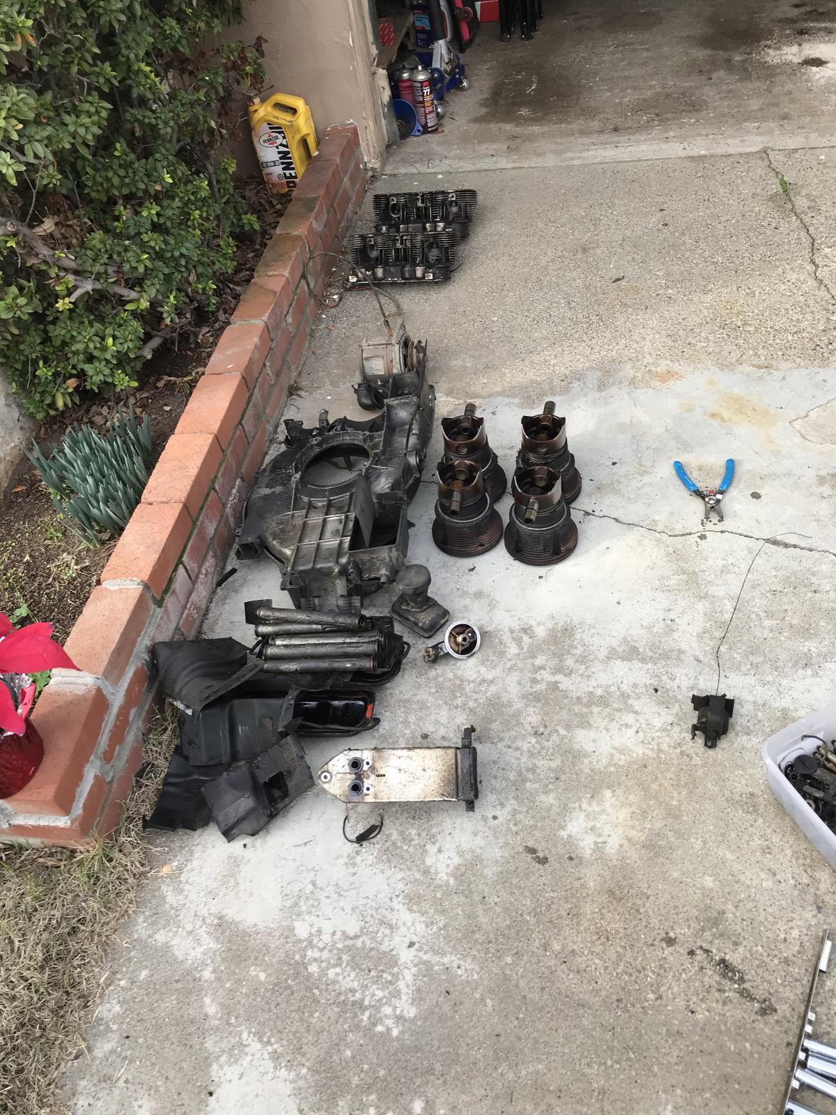

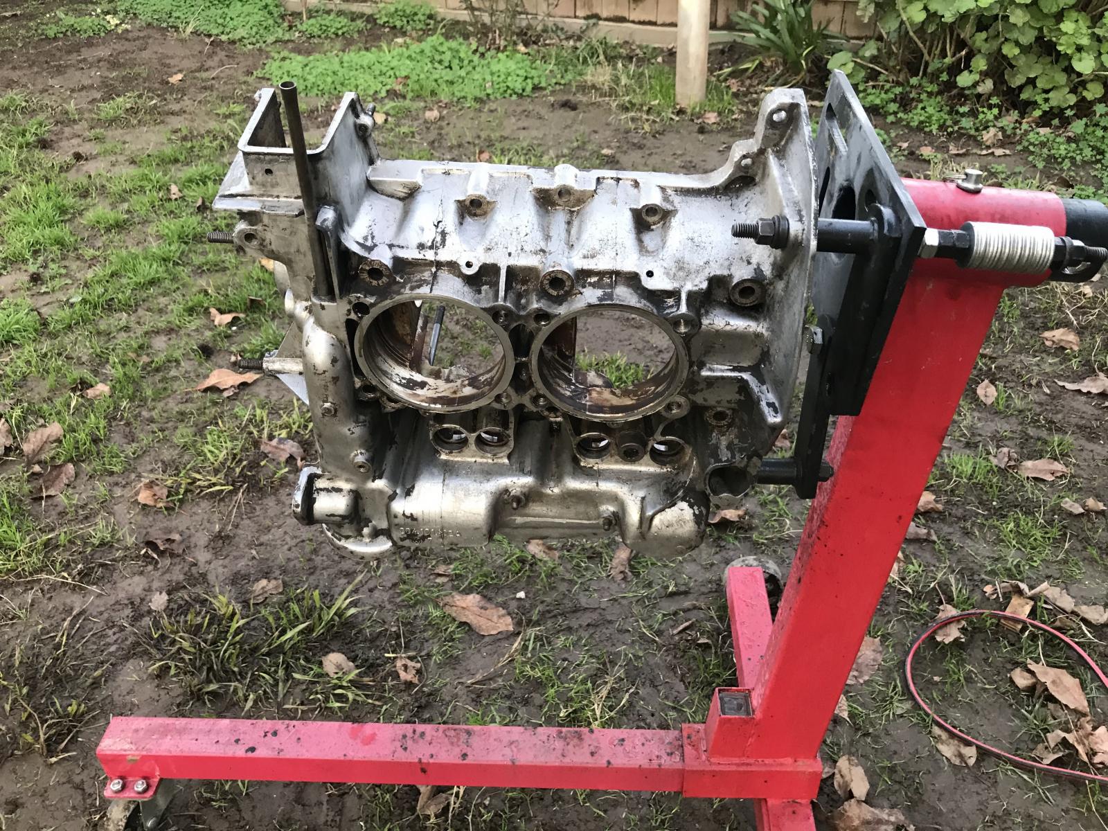

Got it torn down to a short block today. So far nothing looks too bad. Will have to clean up the heads and see if they're going to be reusable. Only think I'm concerned about is it looks like there's some oxidation or fluff/buildup on one of the exhaust port sealing surfaces. I'll post up some photos once I get them cleaned up more and see if you guys think they'll be usable.

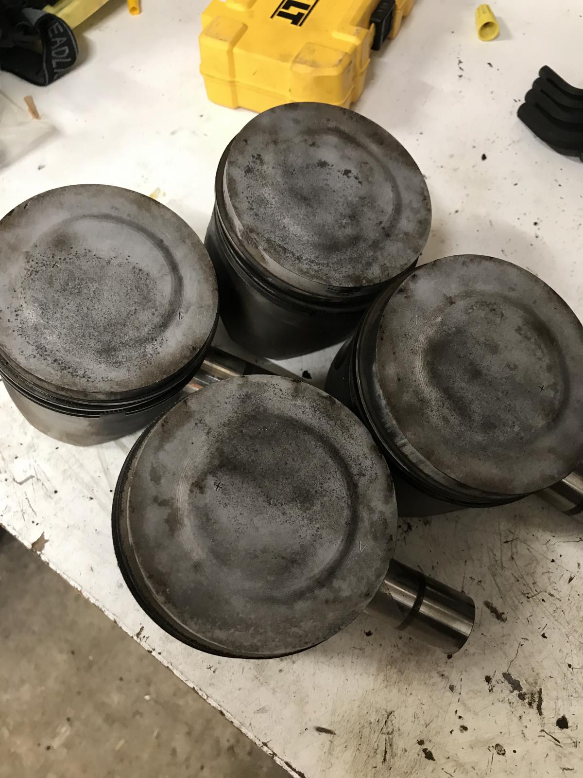

I was happy to find out it had domed pistons in it, anyone know how many CC's that takes or how to measure that? Here's some pictures in progress from earlier if anyone cares. It was quite caked over with grease and grime.

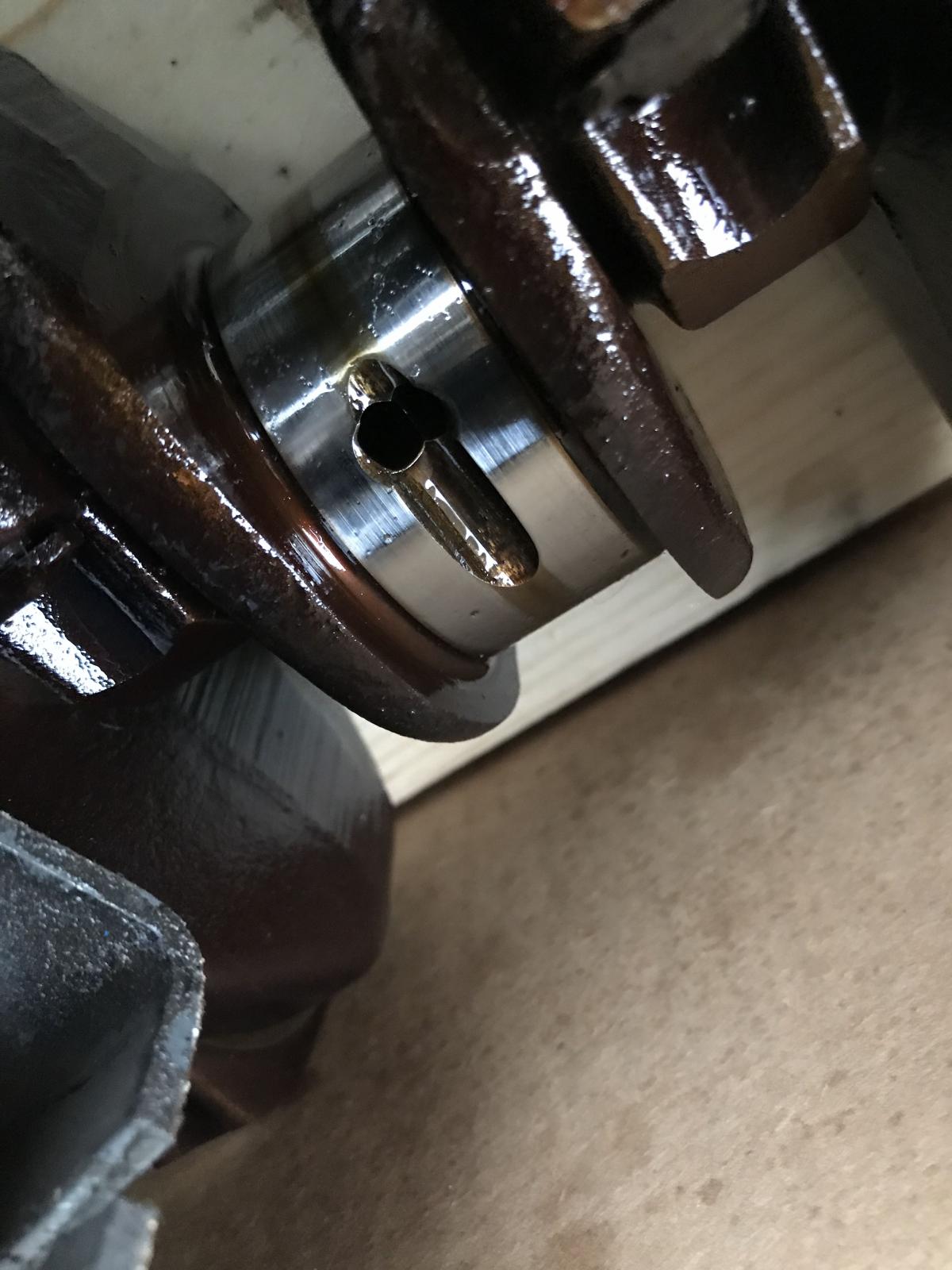

Good evening all, made further progress this afternoon. Started getting the case cleaned up, no sign of the T4 syndrome and so far it looks quite good. Even had the sump baffle plate in it still.
Cam is shot so I'm thinking the CB street power cam. Would that work well in a 1.7L? Running MS EFI so not constrained by the stock FI.
https://www.cbperformance.com/product-p/2202.htm

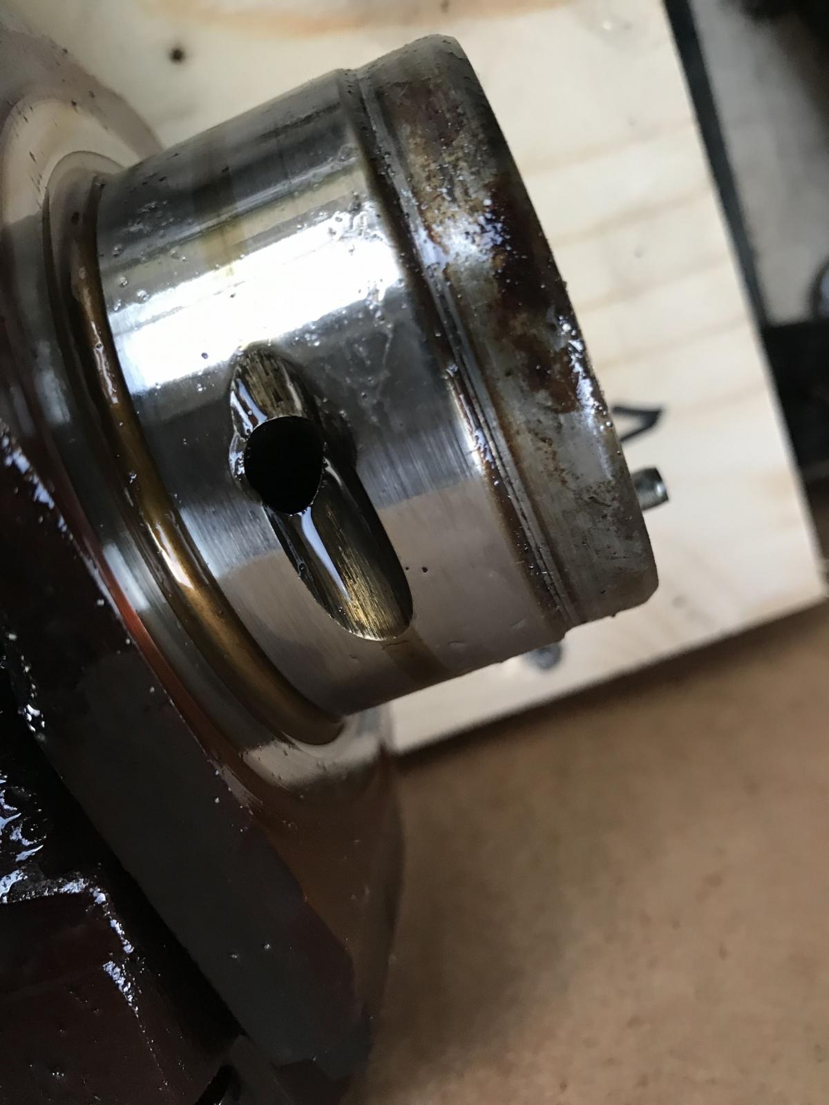

In addition to my previous post's question about the pistons, how do the crank journals look? (aside from the dust stuck to the oil of course!)

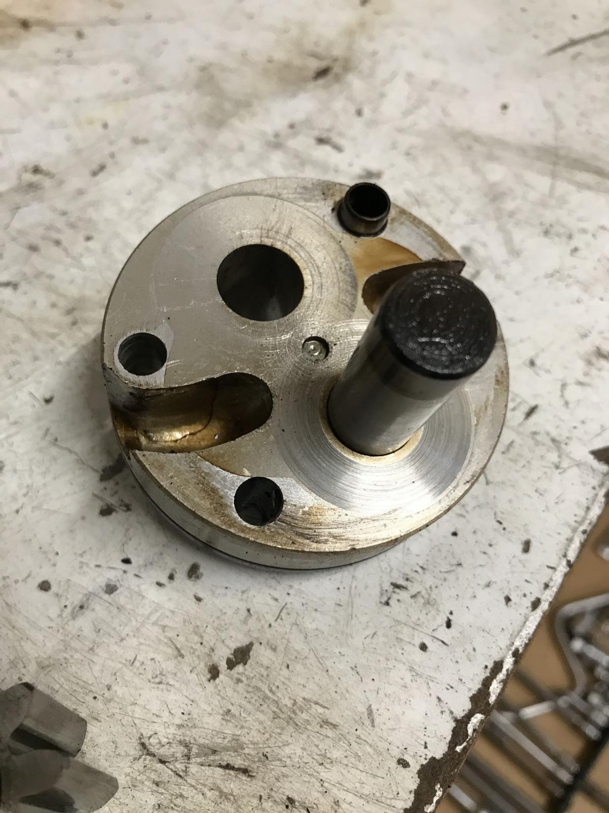

Also the oil pump? Looks re-usable to me, no scoring and it looks like very little wear. (The gears look better in person, the photo looks like it highlighted some gunk or oil I missed with a quick wipe down.)

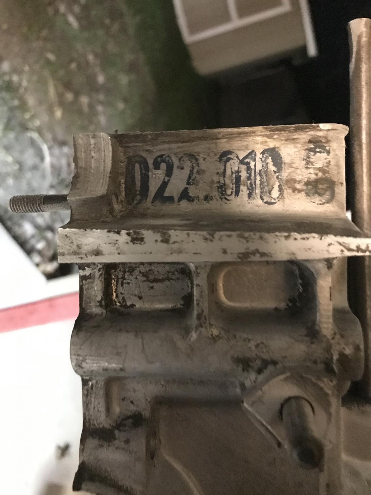

Twodollardoug, I will certainly be trying that out on the other case half and some of the really grimy parts. Got this half pretty well cleaned up with a bit of work with a tiny screwdriver and some soda blasting. A few spots still but looking really good I think.
Got a photo of this stamp on the case, anyone know what it could mean?

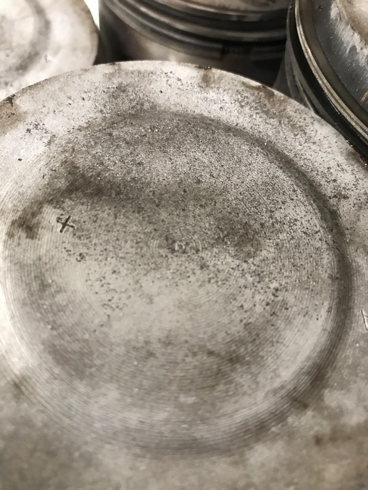

The pistons have some weird pitting on the faces, the skirts measure okay and they don't seem to have scoring down the sides so can these be re-used with some new rings? The pitting isn't any deeper than the stampings already on the faces. They are KS with the steel support ring inside so they should be pretty nice pistons right?

Post by Bruce.m »
Looks like the engine has been suffering with pinking / light detonation? Perhaps running lean or having the ignition too far advanced?
How does the heads look? Similar damage?

Bruce.m wrote: Fri Jan 31, 2020 5:11 am Looks like the engine has been suffering with pinking / light detonation? Perhaps running lean or having the ignition too far advanced?
Haven't gotten into the heads yet, but pistons and heads both had/have a lot of brown and black carbon buildup.

Post by Clatter »
Everything looks really good to me.
So far I’m guessing that stuff will all just go back together.
Have to measure things to know for sure.
Keep us posted!

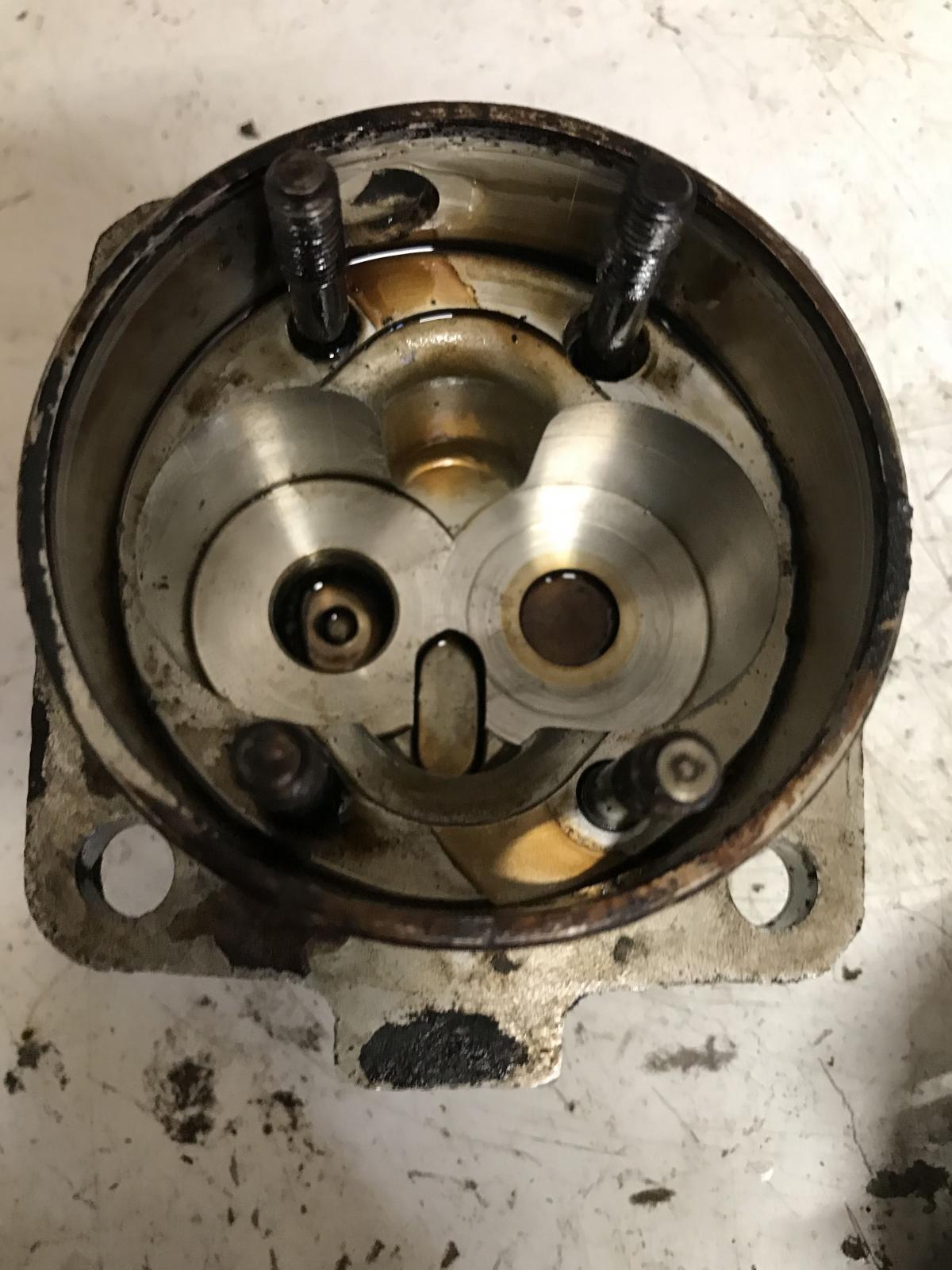

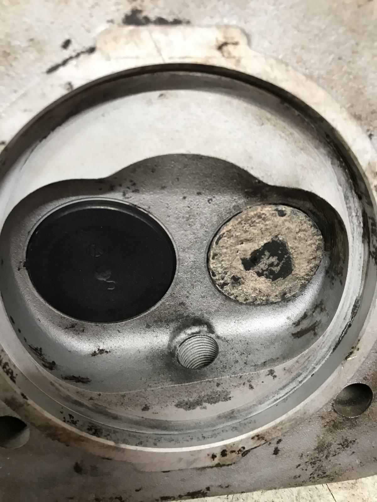

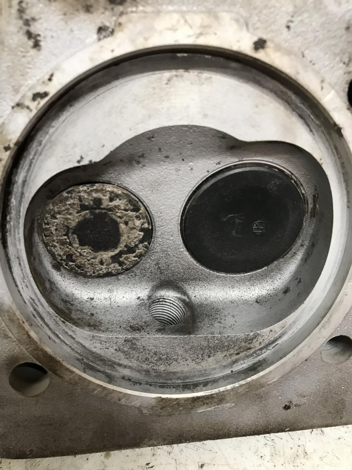

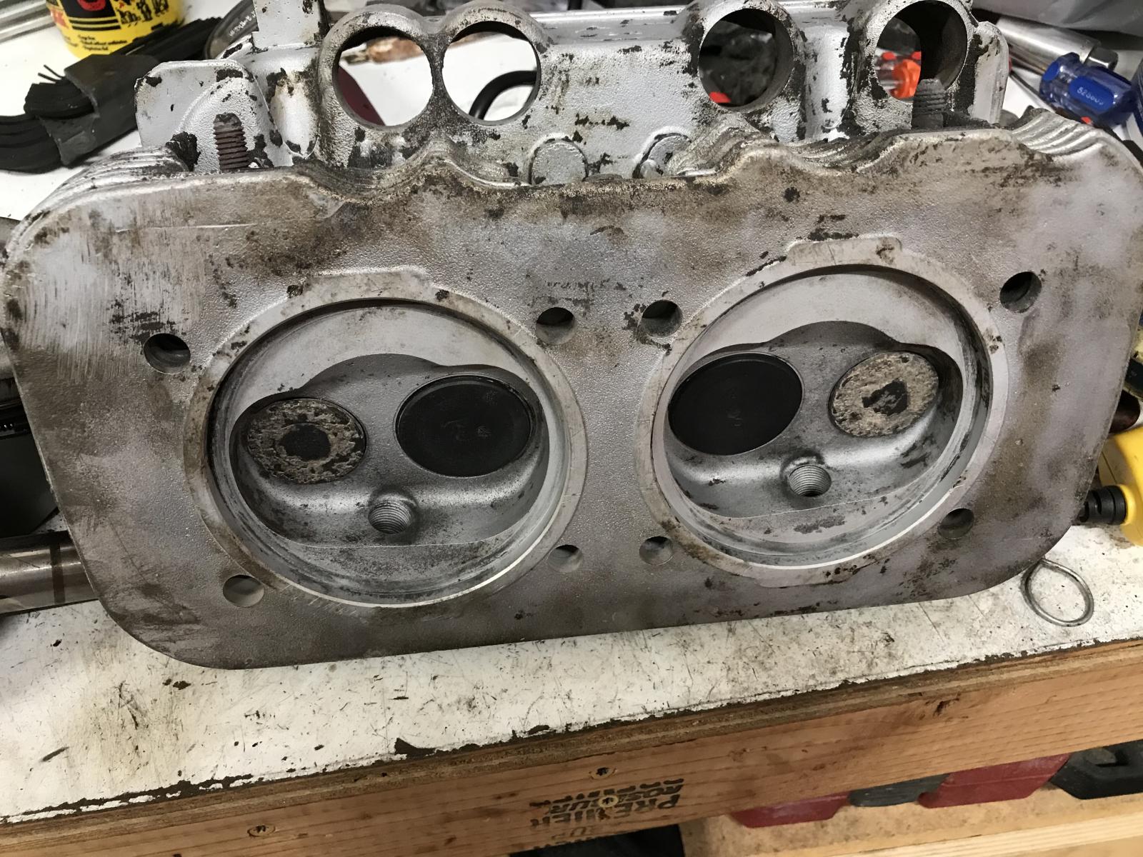

Still just working on getting things cleaned up. Started on one of the heads tonight to see how the chamber looked. No pitting like the pistons had, just as cast finish it looked like to me, so I don't know what's up with that. Just some crusty crud in there and especially on the ex valves. (A few photos below)
Will certainly be measuring everything to the best of my abilities, and certainly posting up here and asking questions when in doubt.
