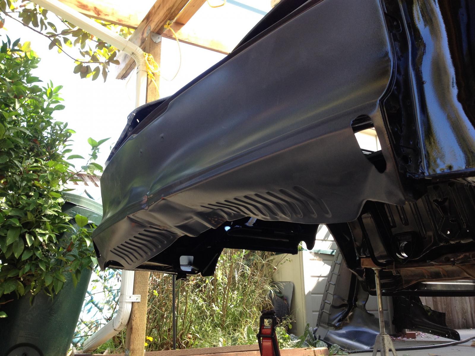

I have an epic several-year build going as well.
Mine fell off of the jackstands…

Oh man, that looks like an expensive panel! Ouch.
