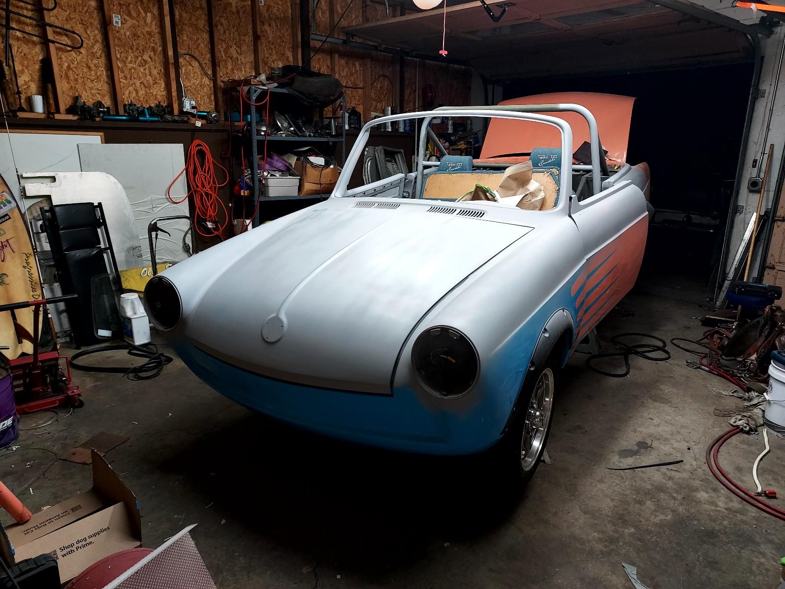

I did a thing:
Started to scuff to prep for paint. No going back now.

For what it is worth... an opinion:
Looking at the drawing (good job) and the pix a few posts earlier showing the roll bar, I think you need to add some additional support via. the roll bar being made into a cage. The roof/top of the body spreads loads around in the body and the pan (floor/frame) and a lot of that needs to be considered.
- vwfye
- Posts: 1010
- Joined: Sun May 21, 2000 12:01 am
Re: Still playing with notchbacks
This is actually a 6 point set up with door bars. But... i am going back to cruiser car and not the track.
