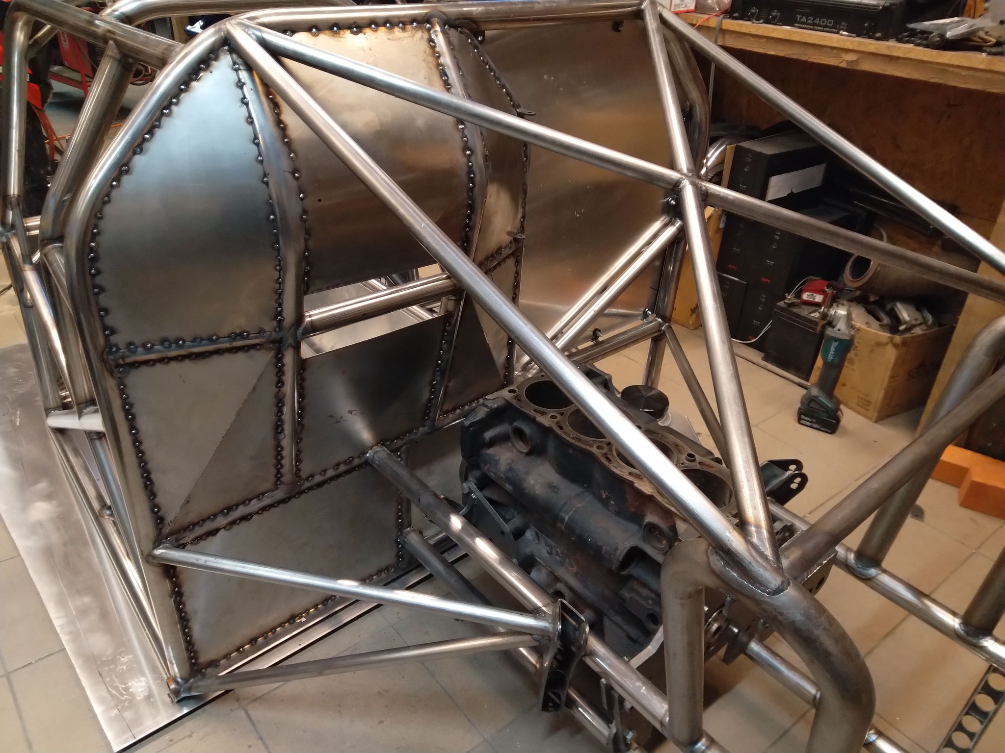

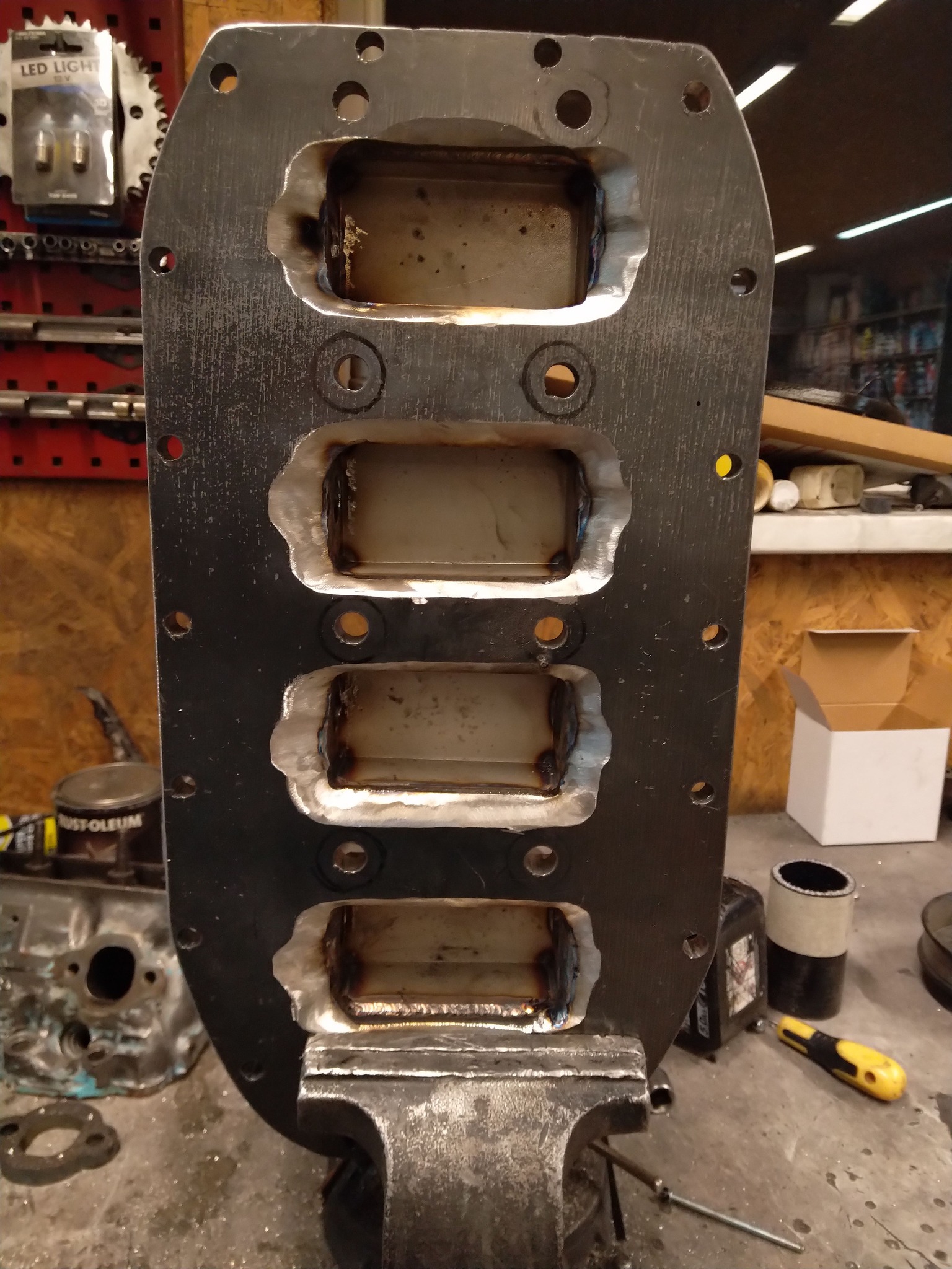

The workmanship looks great, but I see the potential turbulence inside of the cover going into the tubes into the fuel system.

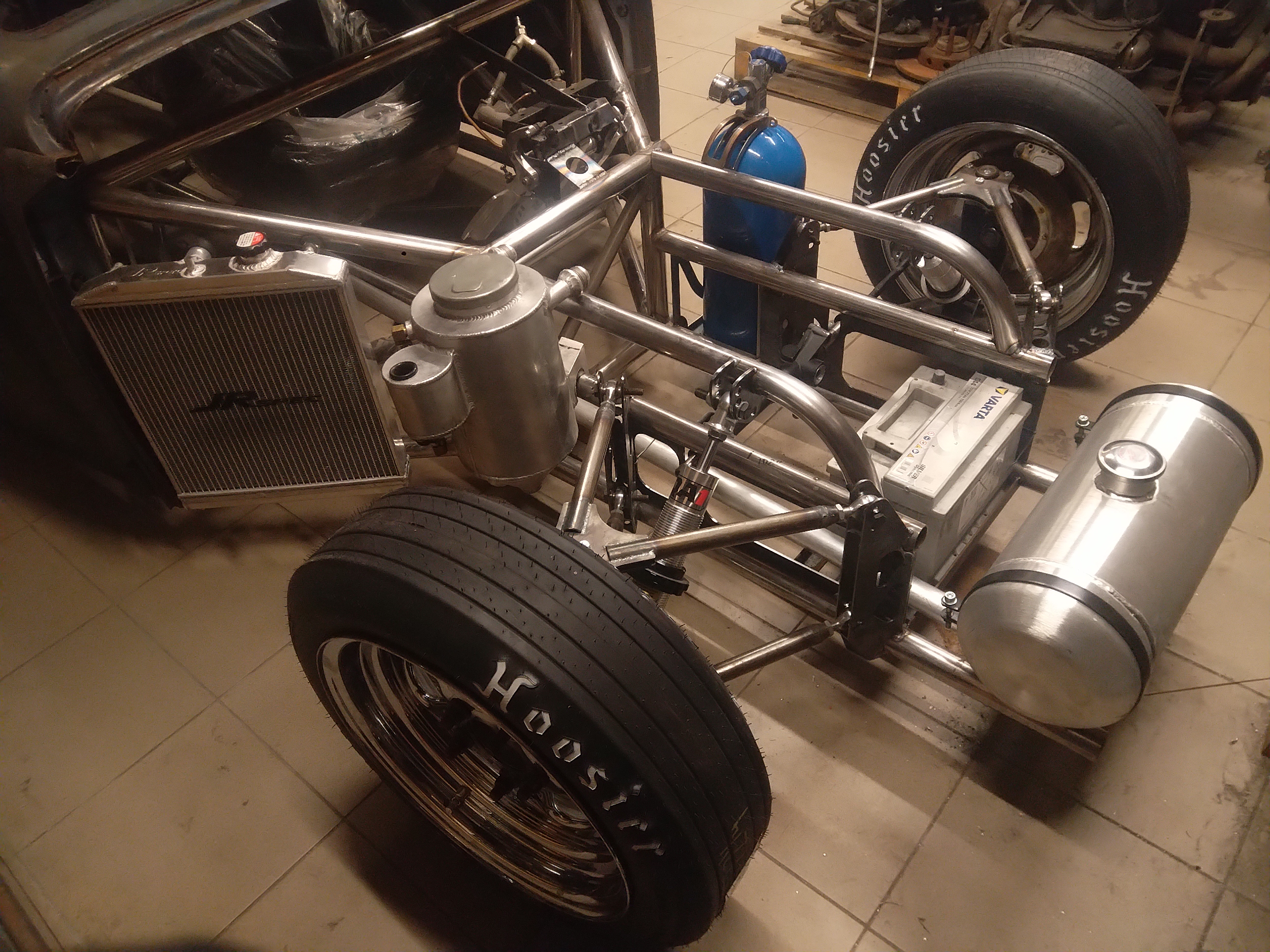

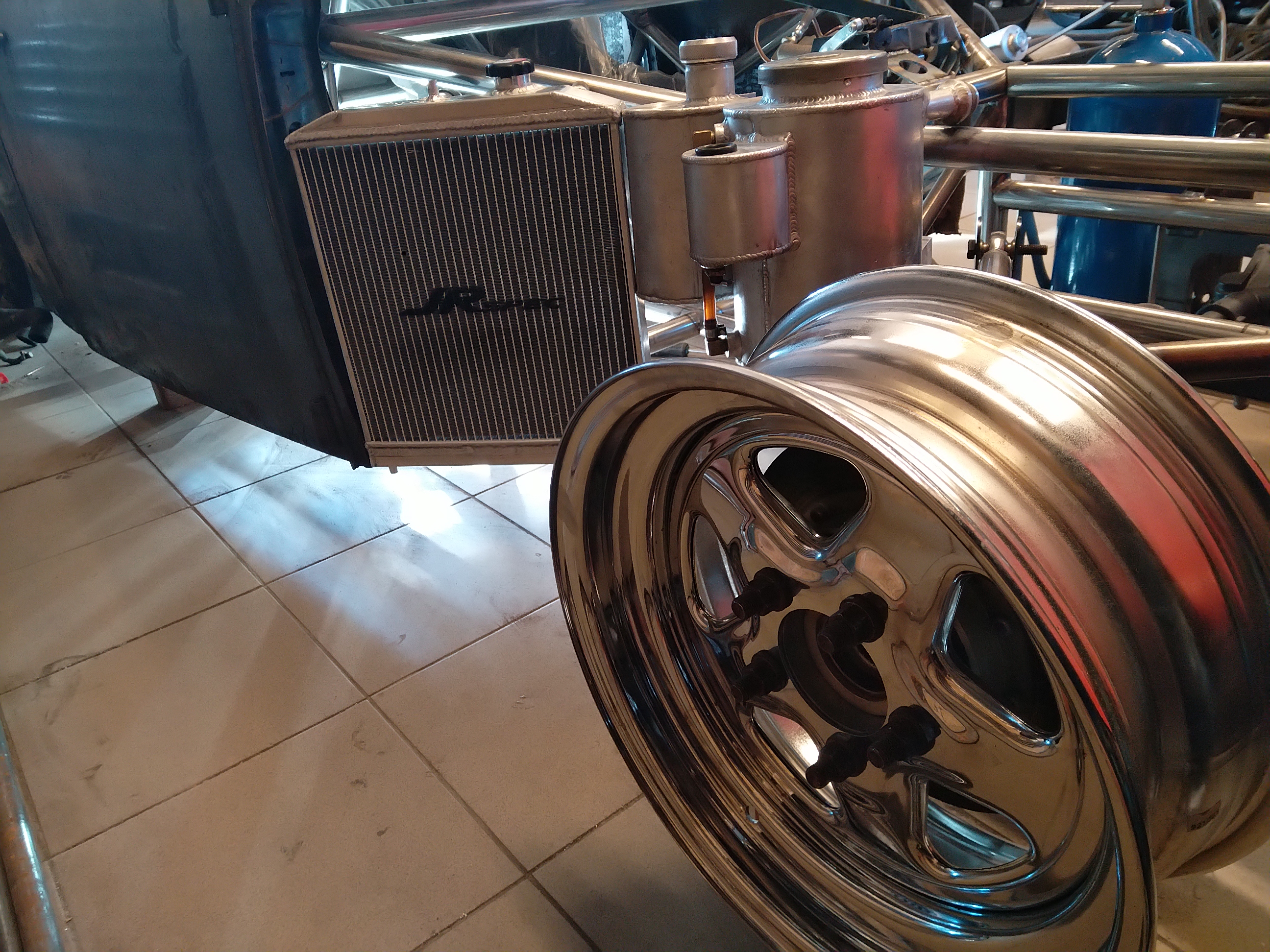

I've been busy with tuning clients cars, but now when season is over and I started working with my own bug.
It was an awesome season and I learned alot. Fastest and the only methanol car I tuned with my own ecu is in 7s now. (~1200h LS) I also had a chance to push 2 little engines to their limit and I was able to see 750nm 511kw from hubs on 1.8L audi and 820nm 512kw from hubs on 2L opel engine. It gives me really good push to wait for my saab engine. i really beleve that 600kw 900NM from hubs can be done with 4 cylinder engine.

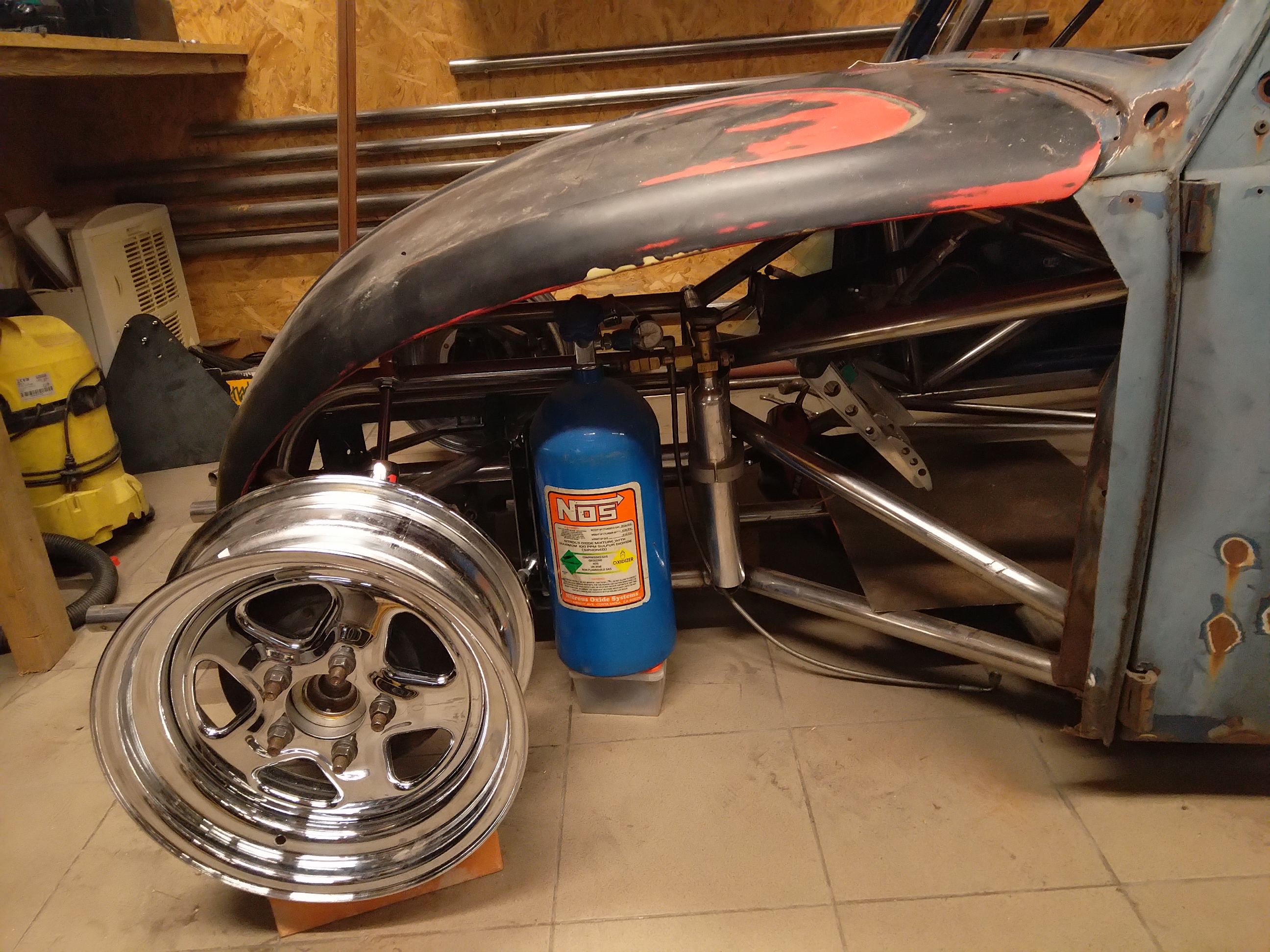

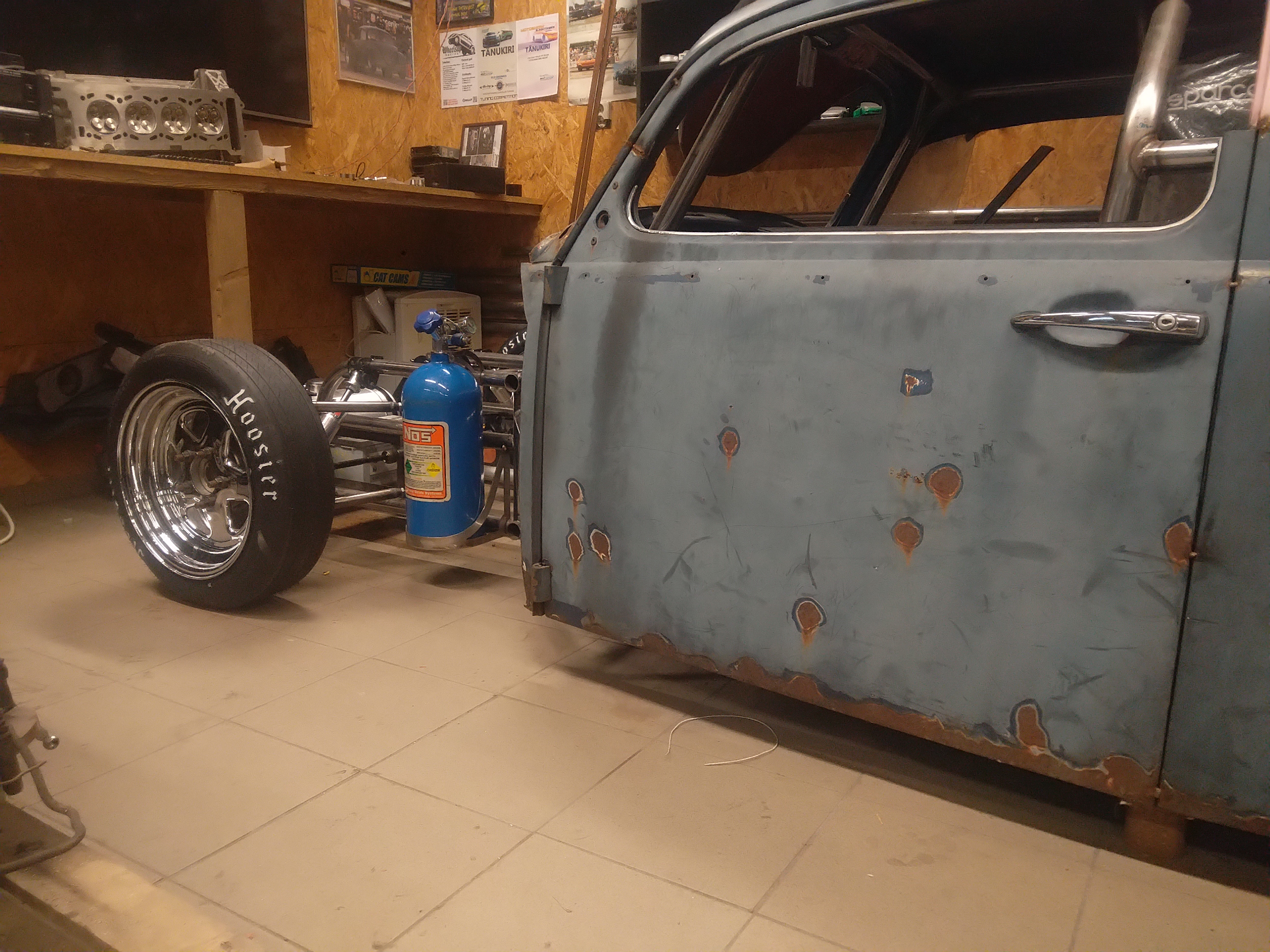

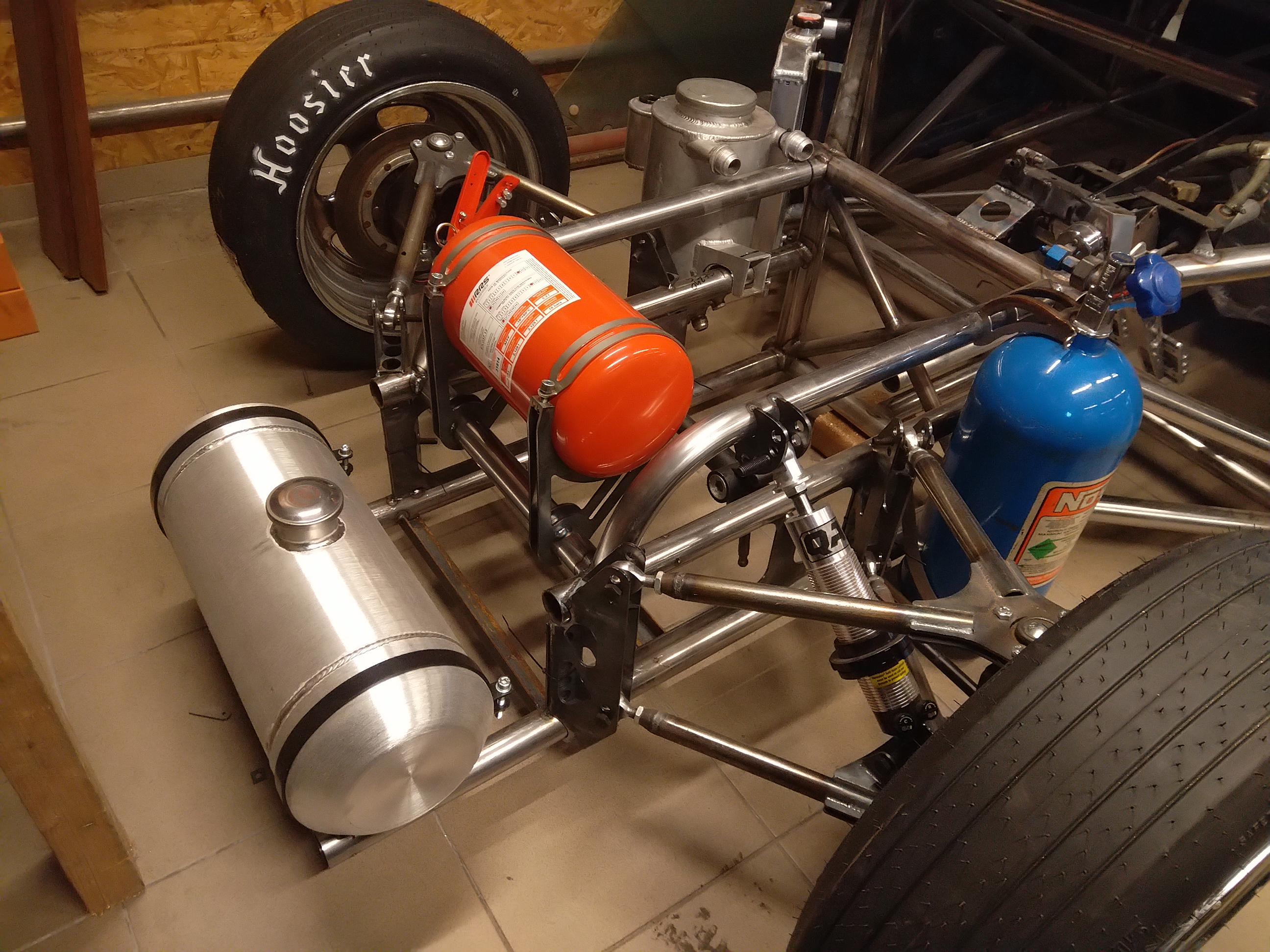

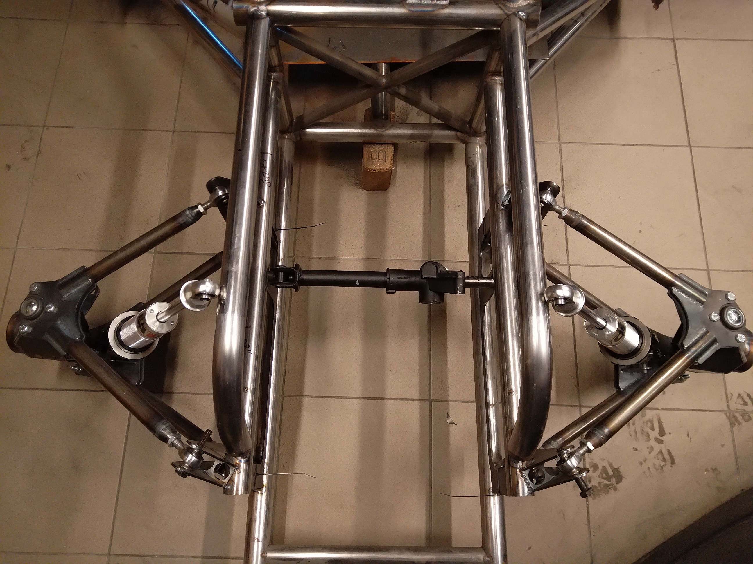

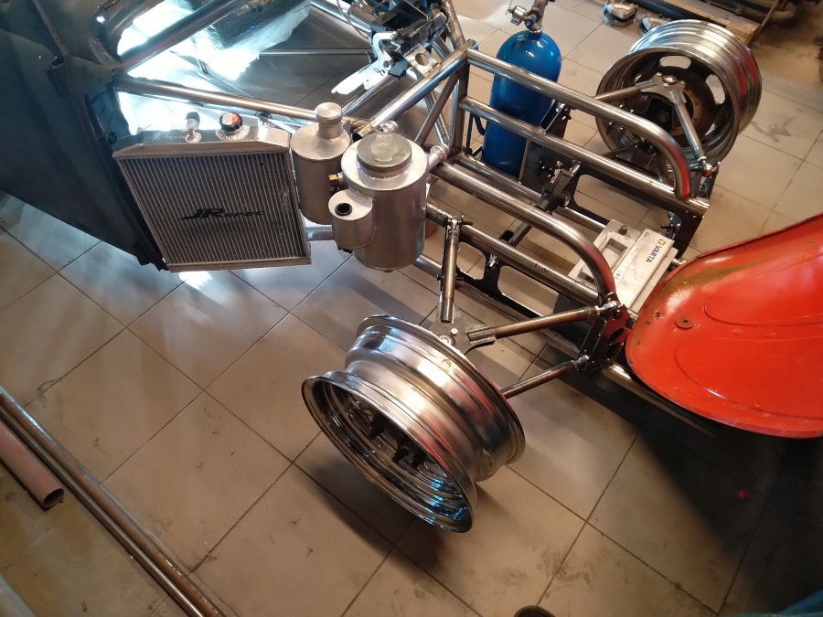

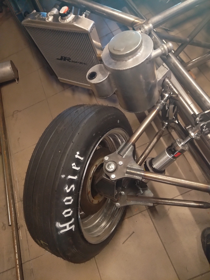

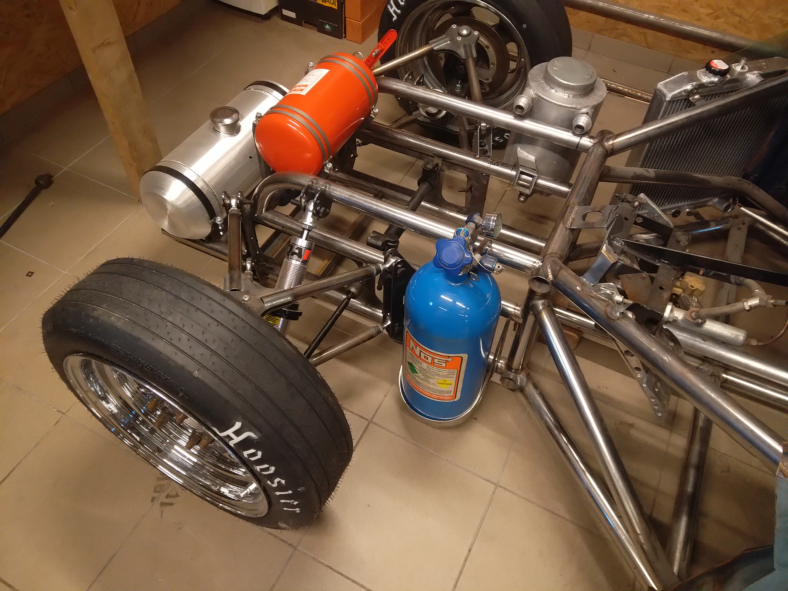

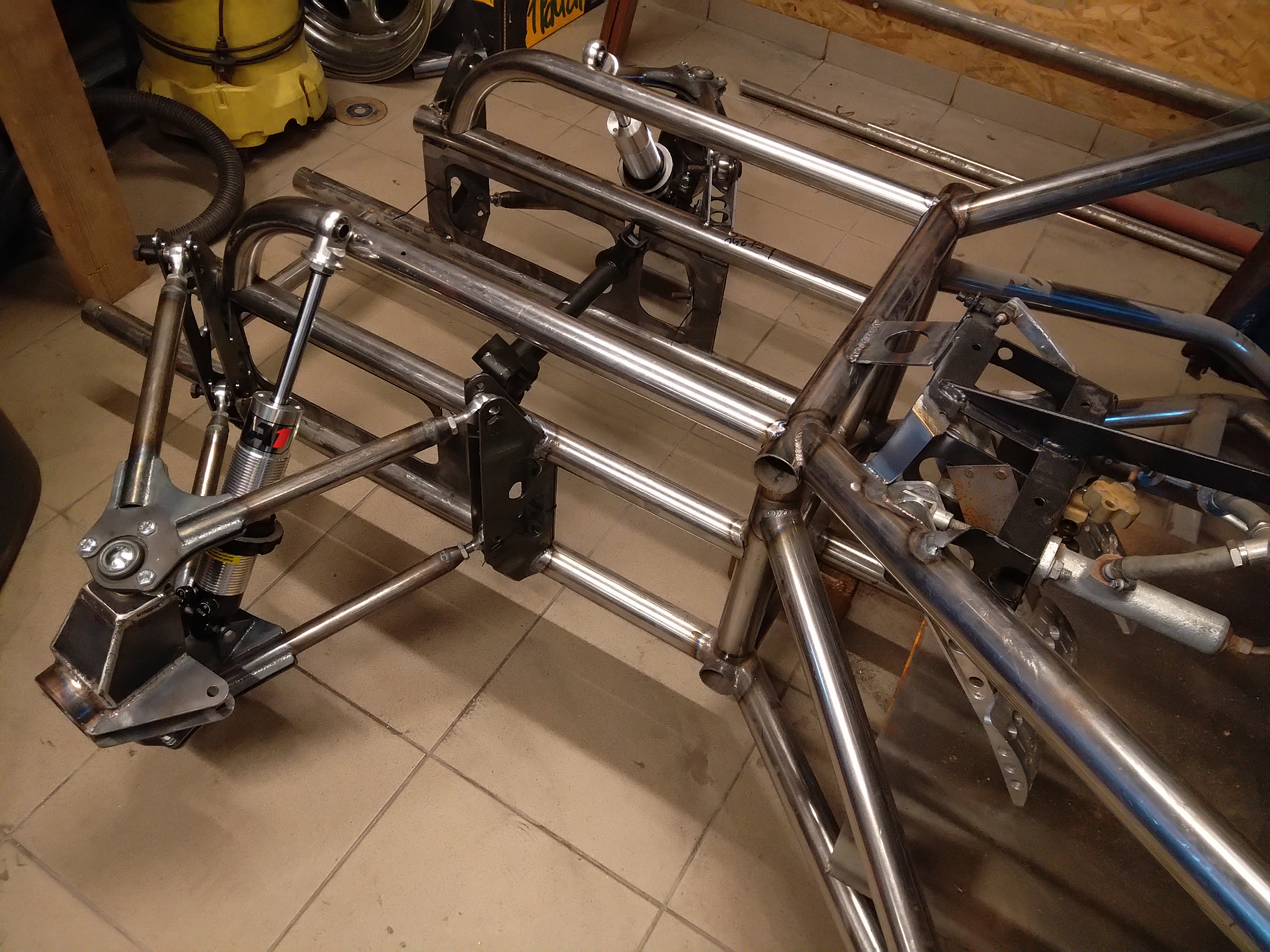

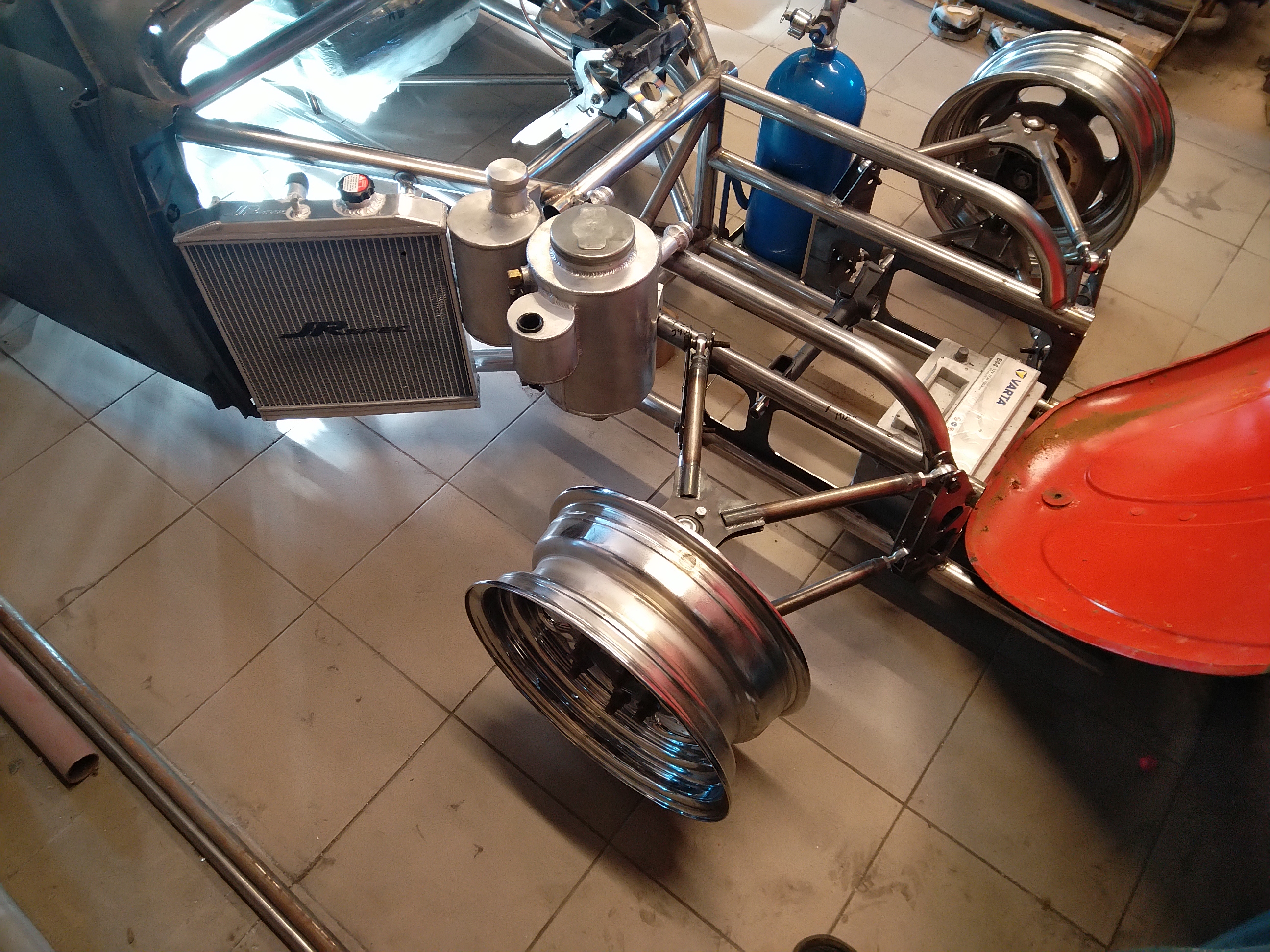

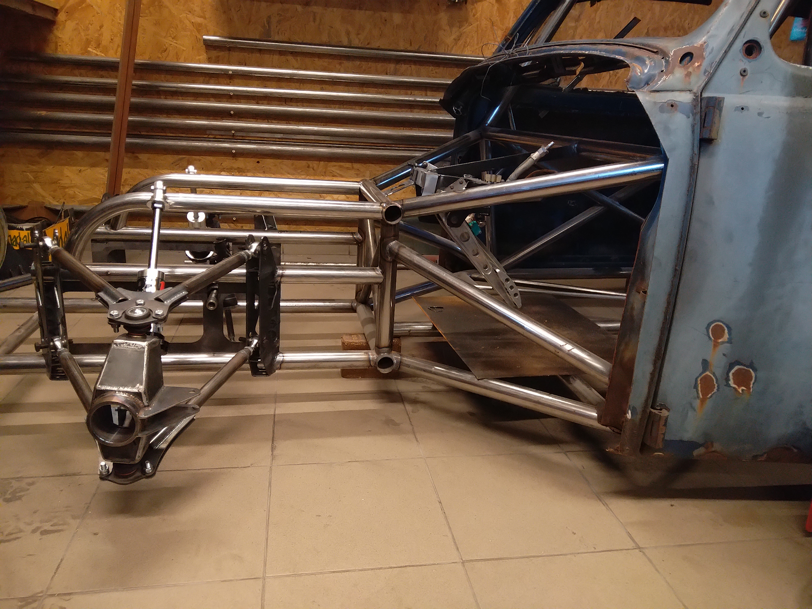

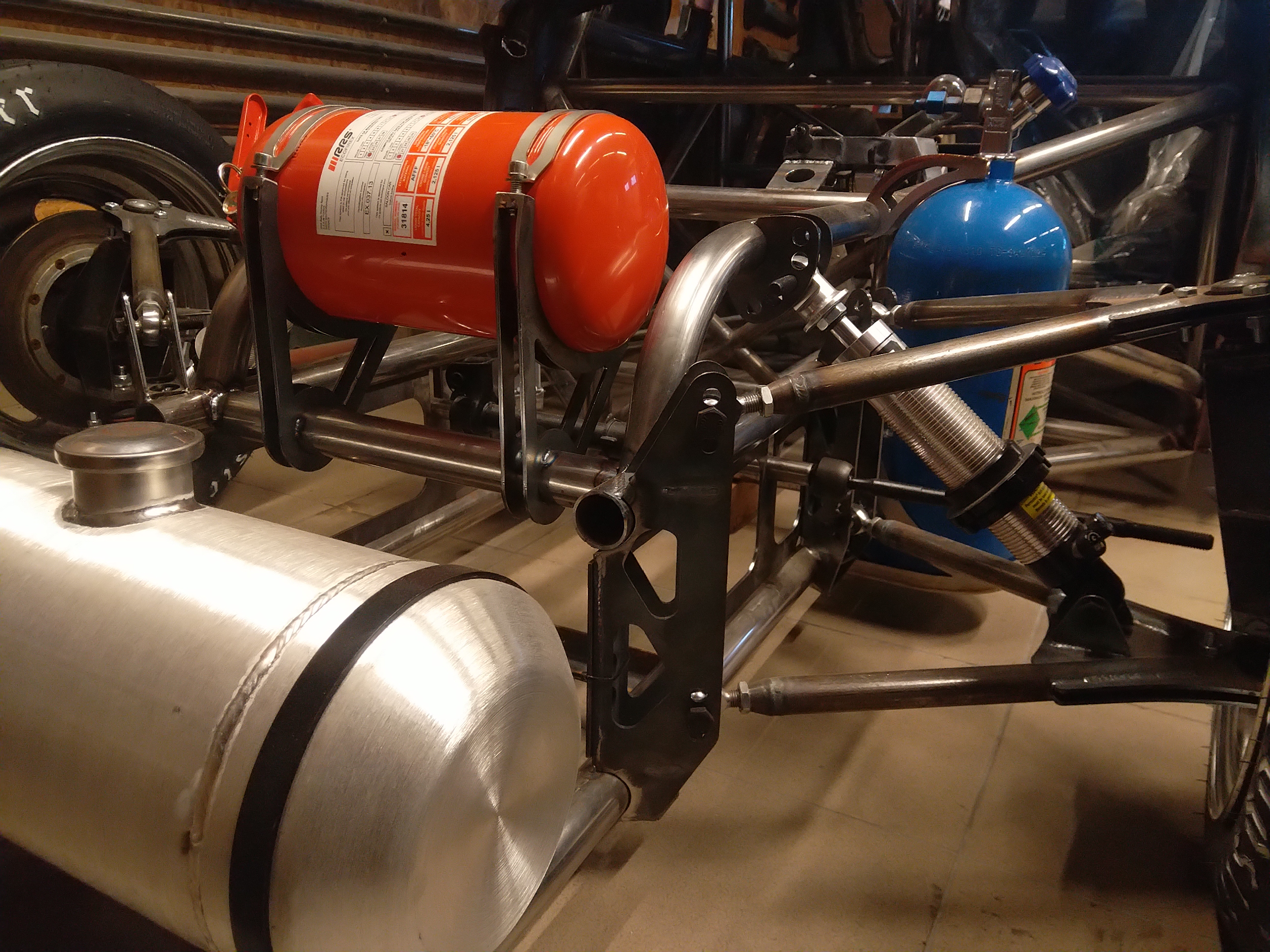

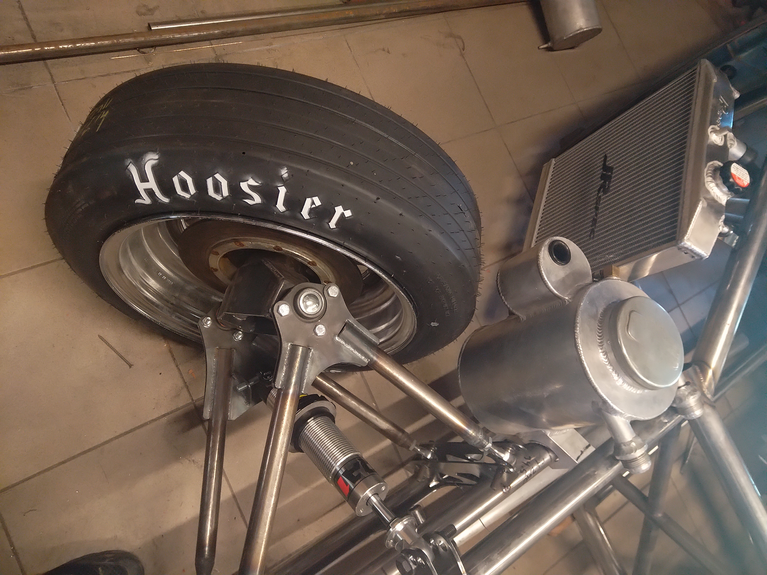

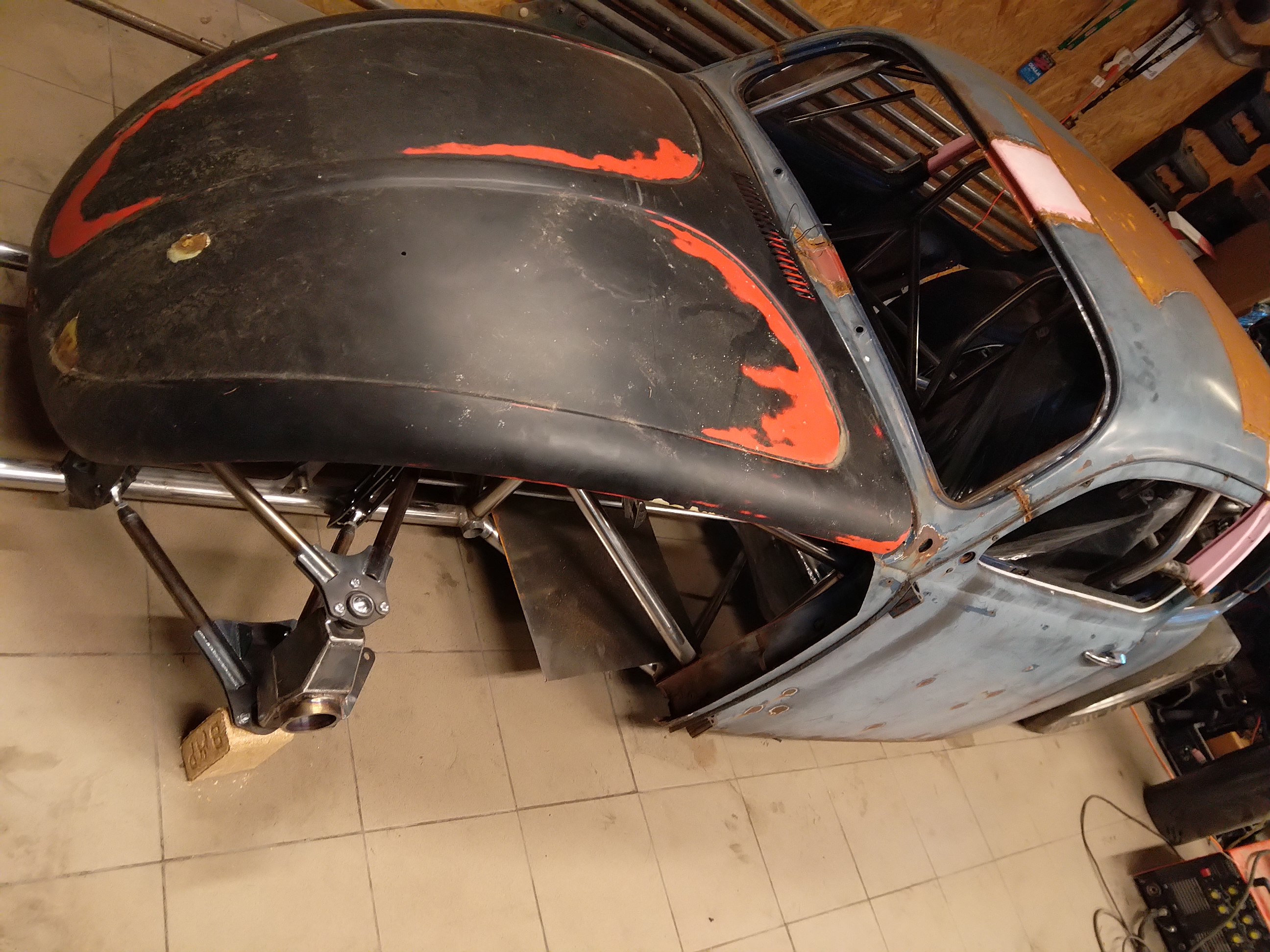

Now some pics of last week works on front axle. Wheelbase was set to 108" That was max I could fit under hood. (No wings)
I'm not pleased with that front end look. There are pipes that are not needed and some parts would look better if they would be different but I have to live with that, or I just make 1 step forward and 2 steps back and It will never be finished.

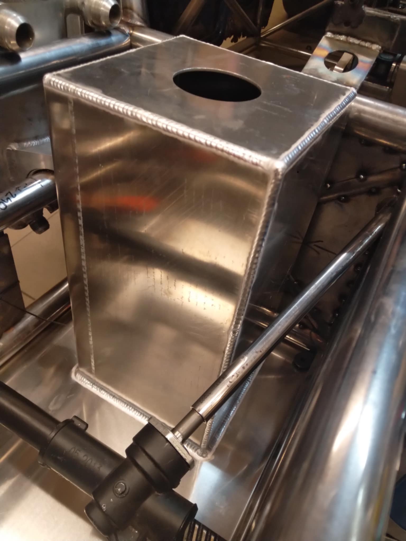

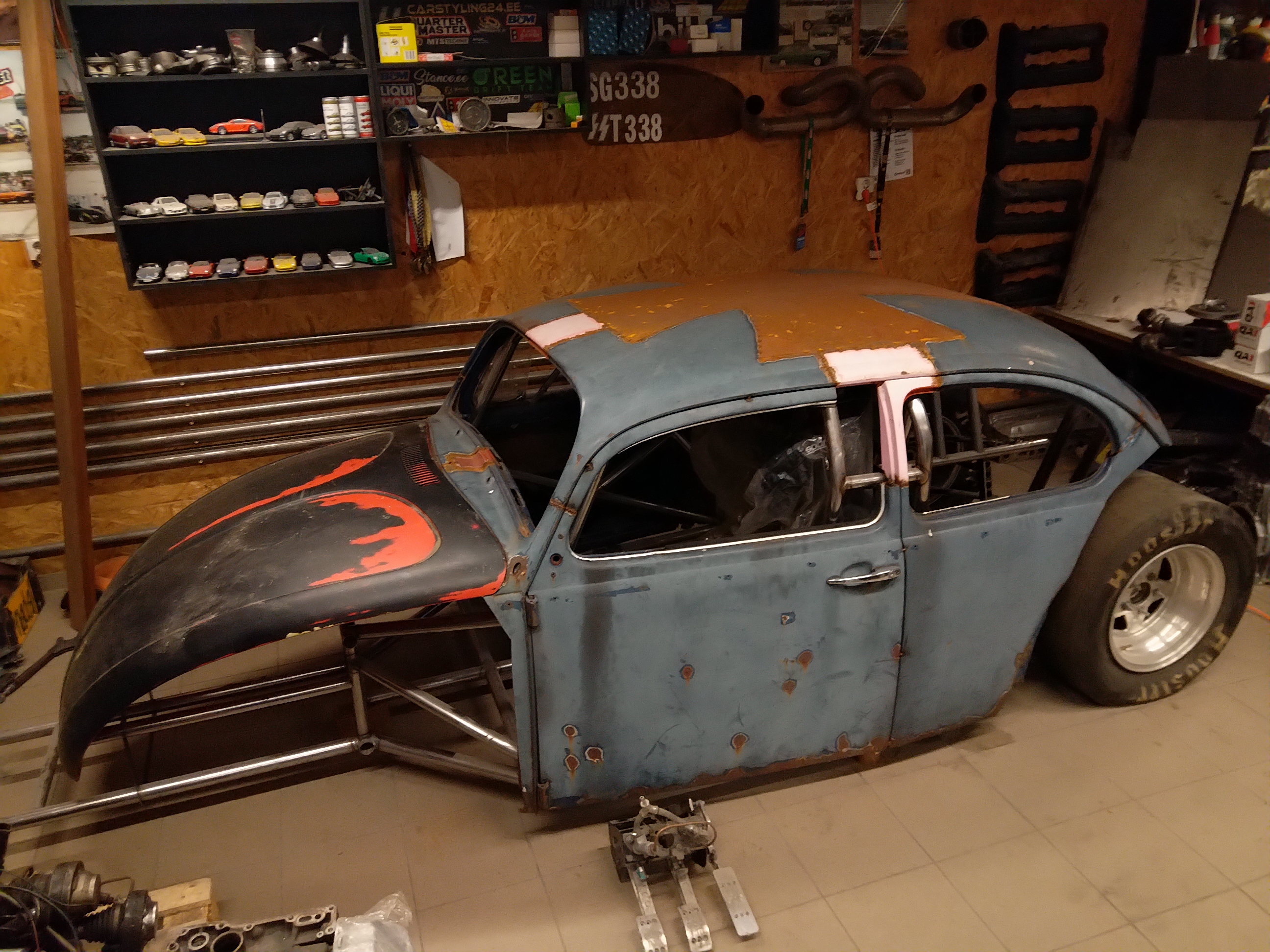

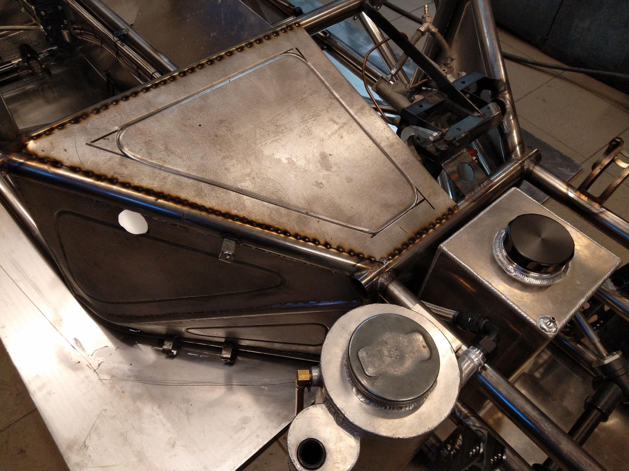

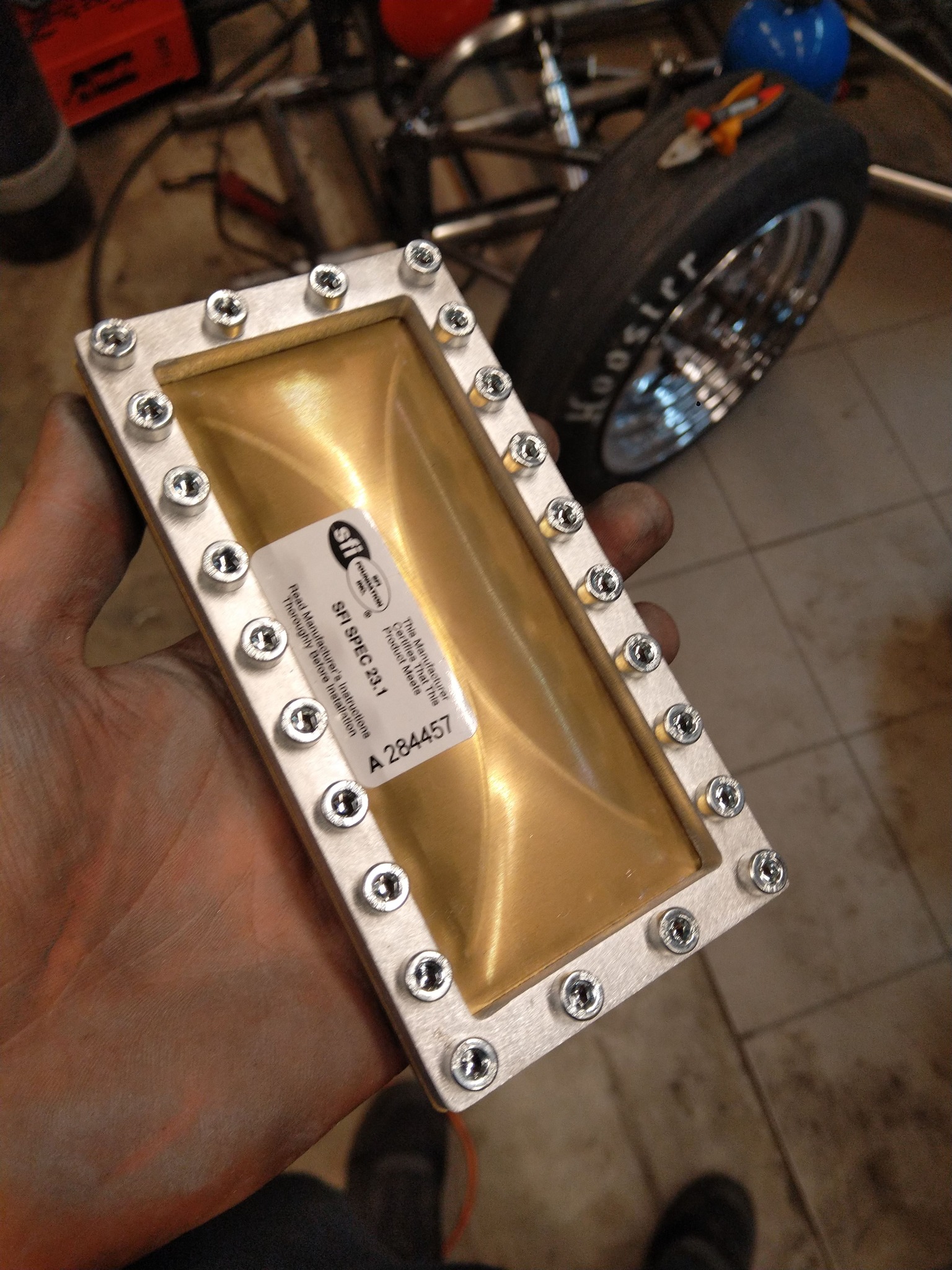

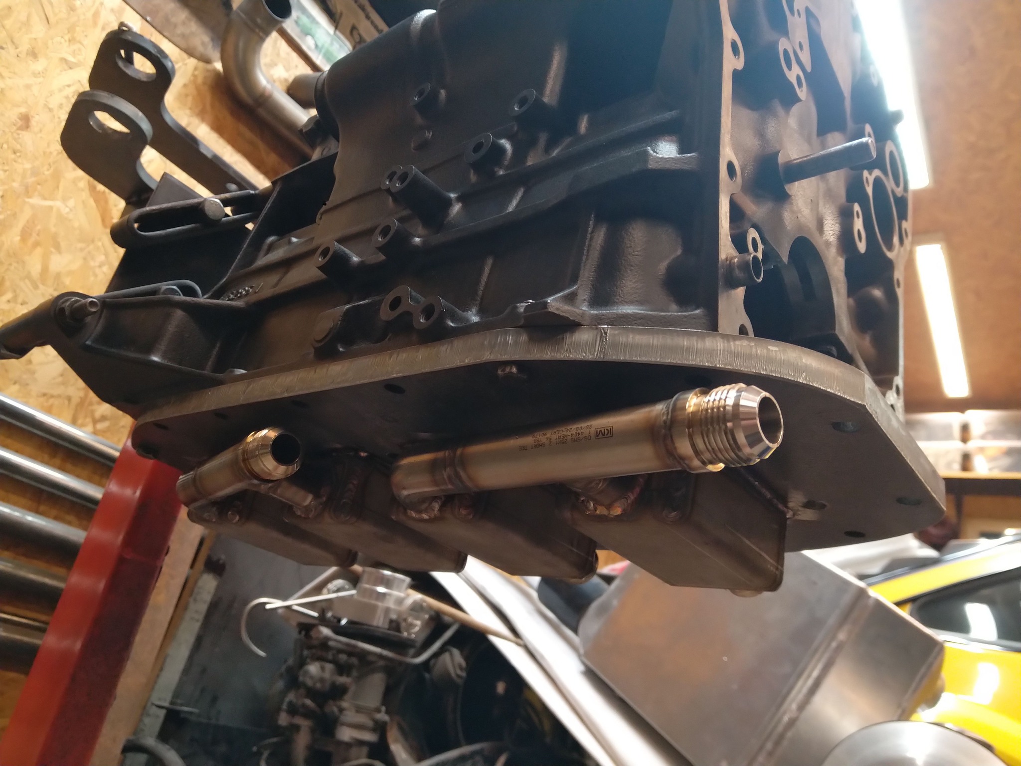

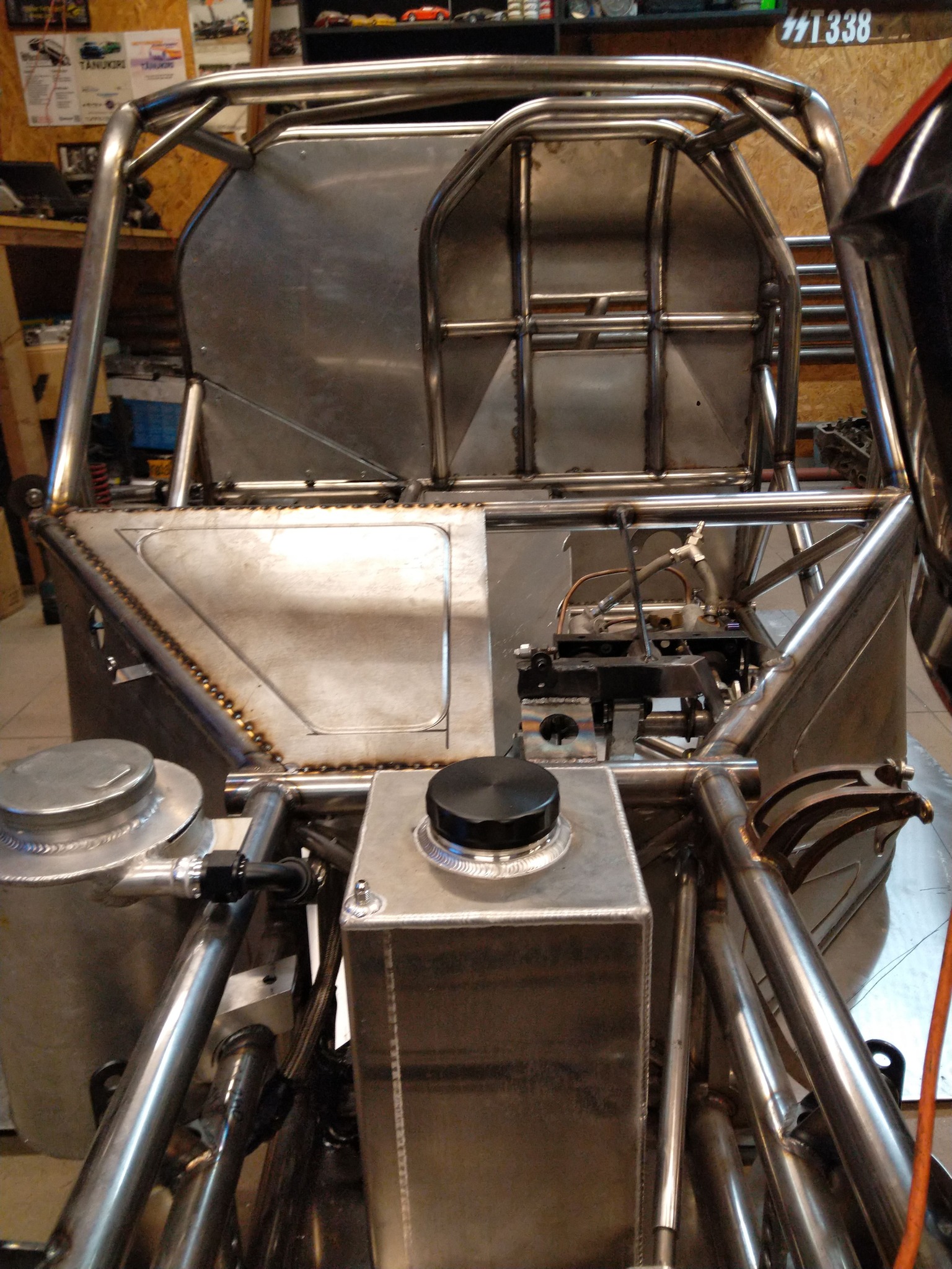

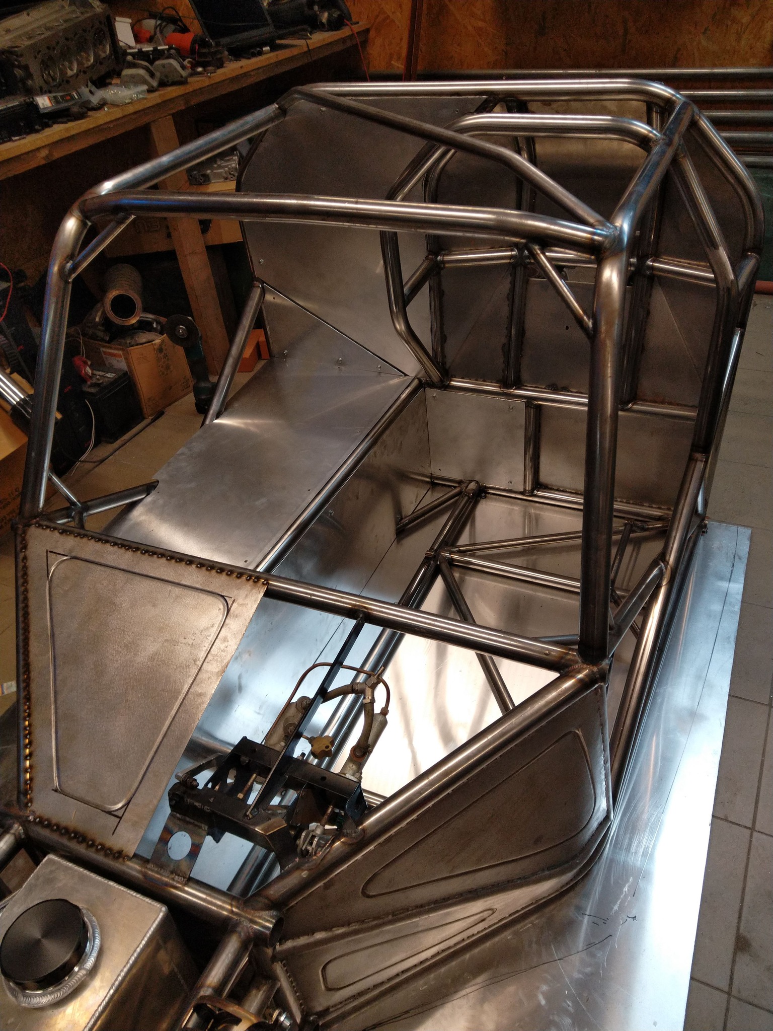

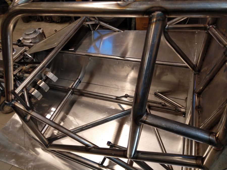

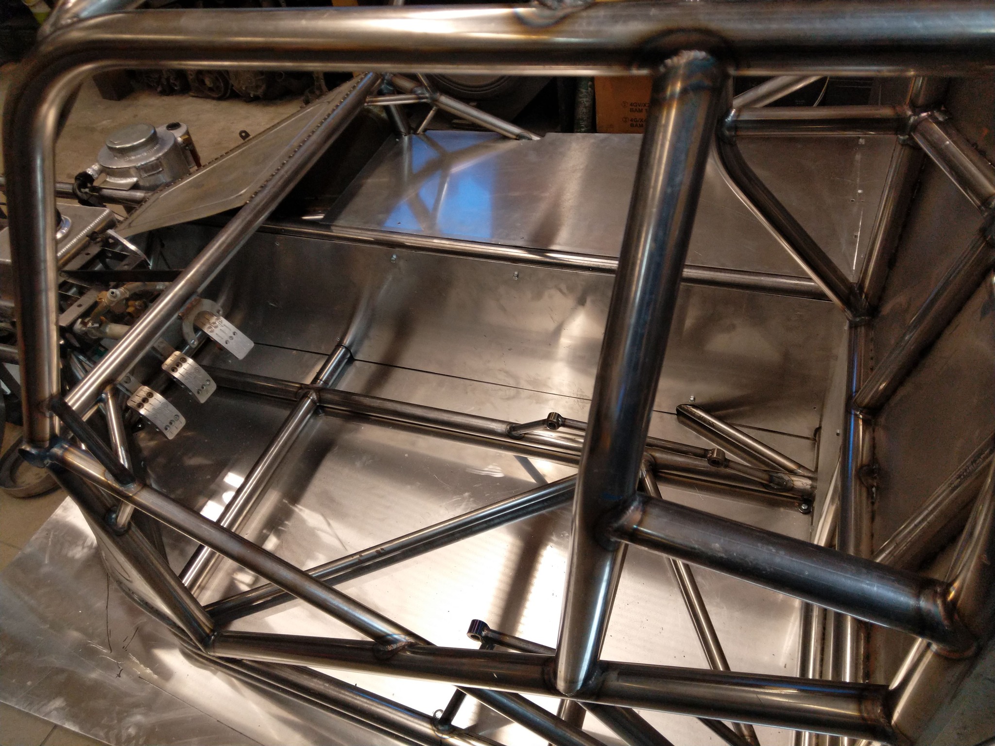

Sorry, not much but I decided to go with dry sump. As my target power request I made 15mm Girdle. When I thaught about it, I decided to go without sump / oilpan and collect oil with my girdle. (1 part less to make and 1 potentional leak less. I also made a new fuel tank (waiting for filling neck and cap)
After that I took it to apart to weld everything whats not done yet. (It must go to powdercoat in march atleast)

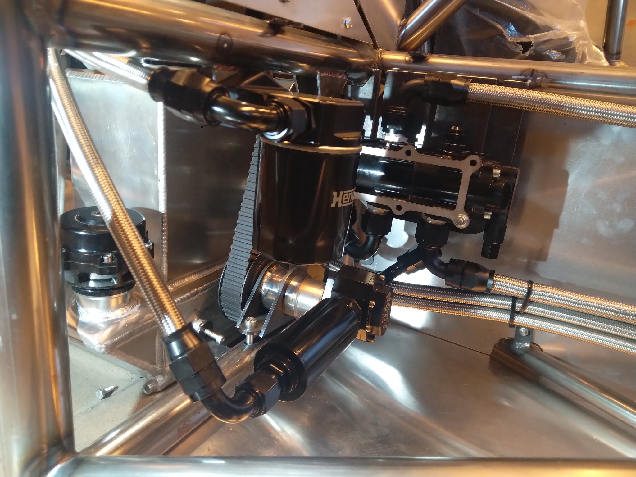

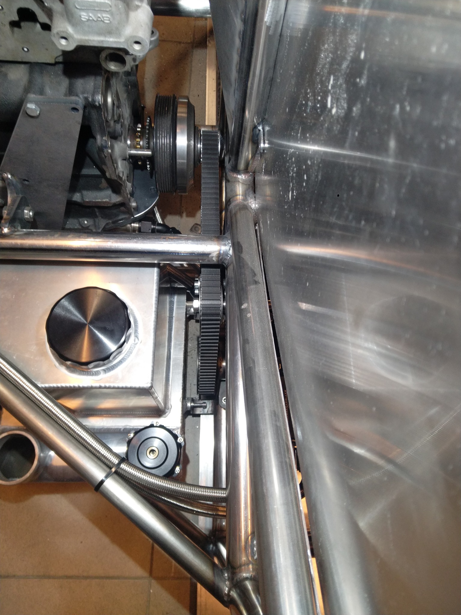

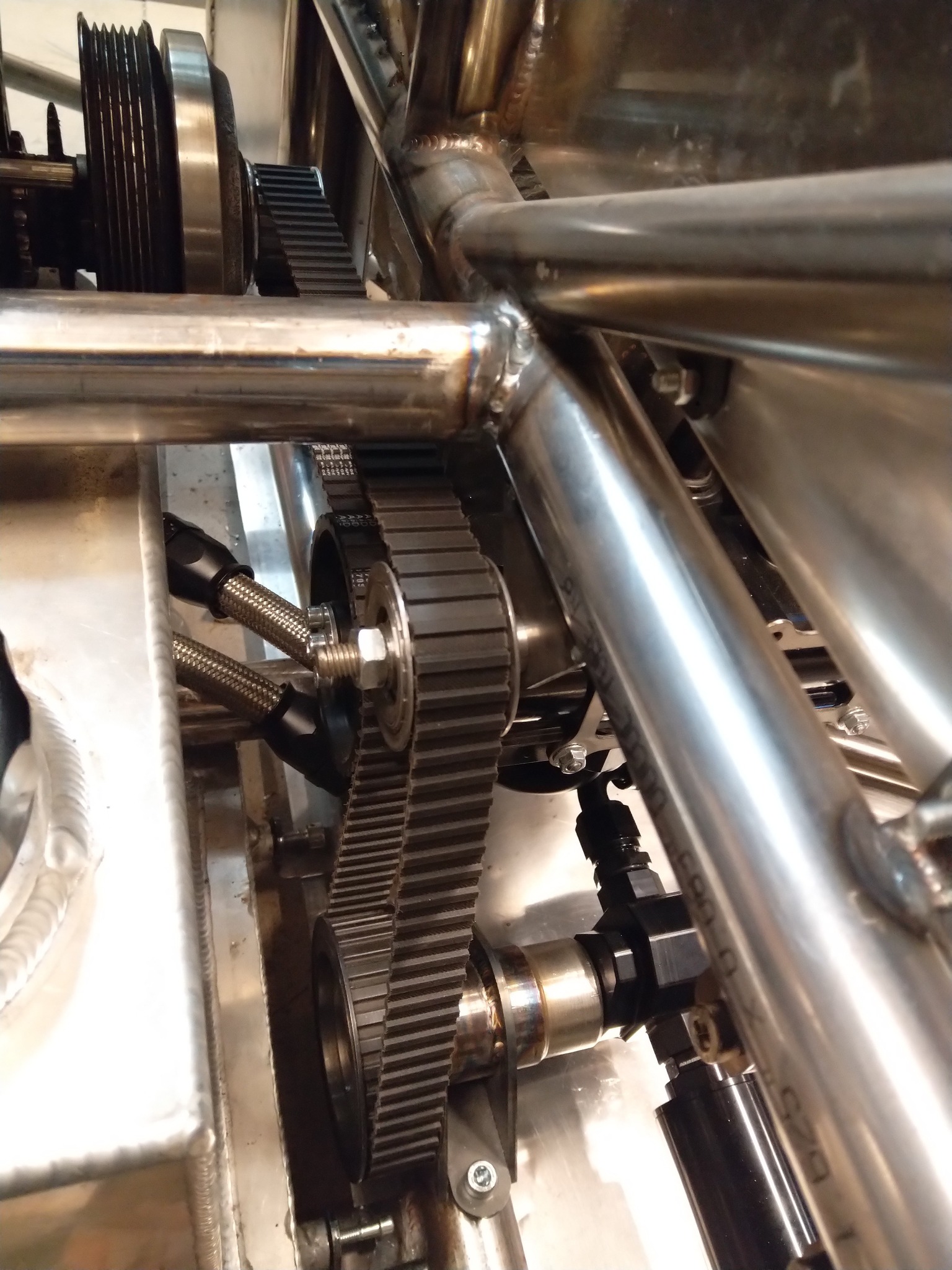

Today I went to one of out bearing/belts store and find out that these oil pump belts is some regular profile, so we searched that is there any lenght of them as 2 side belt (tooth on both side) and we found it. So ordered 2 belt and 2 more pulleys and its gonna be awesome. Pump will be in totally different position as usually. Mostly they are on the side of the engine behind the front pulley. I have no room for that because of my awesome icebox / cooler. So, I will install it to the front of the engine, needed 2 side belt for changing direction. Now it can be on the side I need some weight (passenger side) now it will be more front than behind as my weight requiers and now the oil lines are shorten and more direct with less elbows. Its hard to explain but hope to show it next month.
Then we should have every little piece welded to frame to send it to owen for powdercoating. Can´t wait for working with that new fresh frame. Its so enjoyable to fit new parts to freshly painted frame.

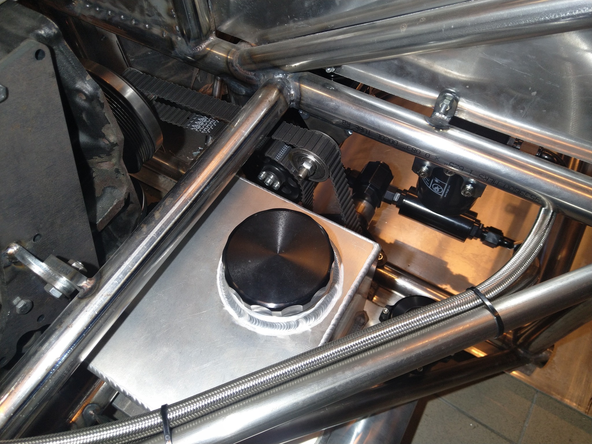

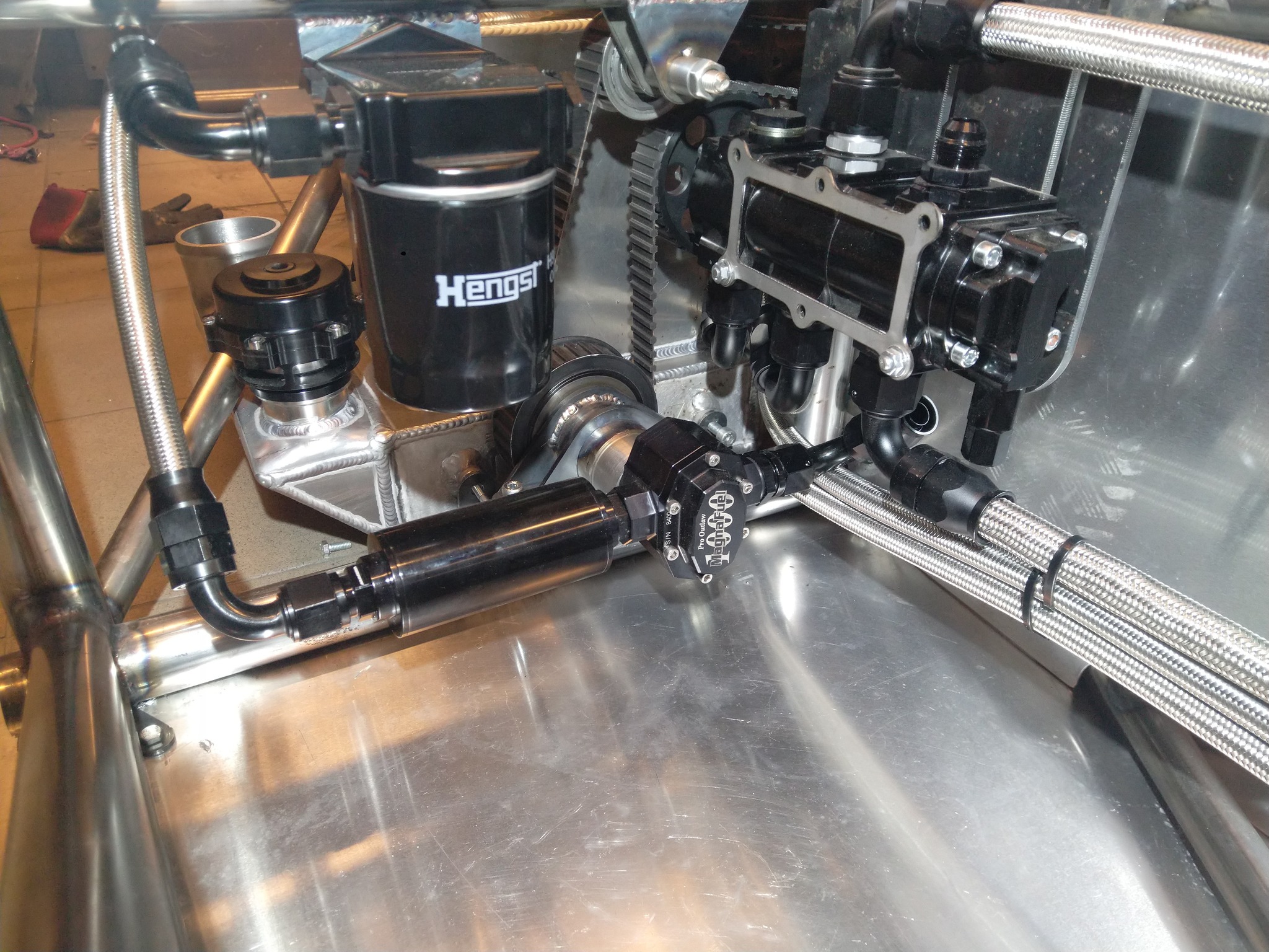

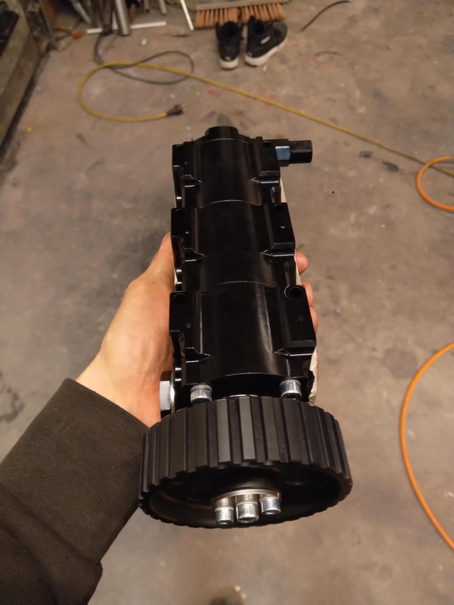

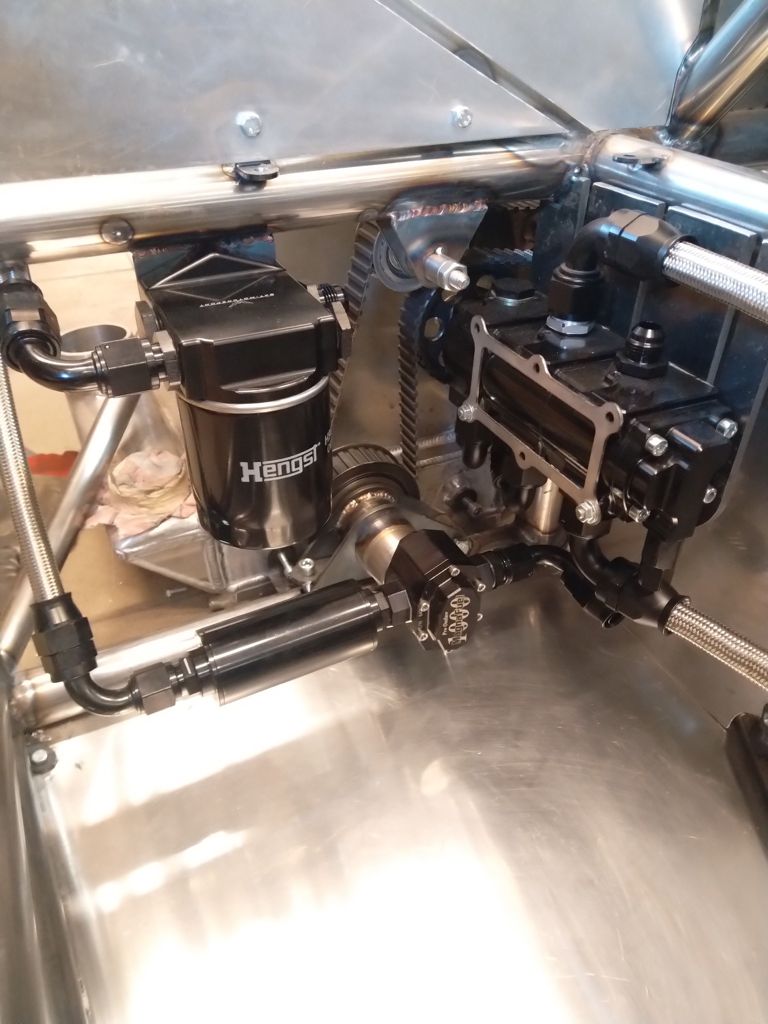

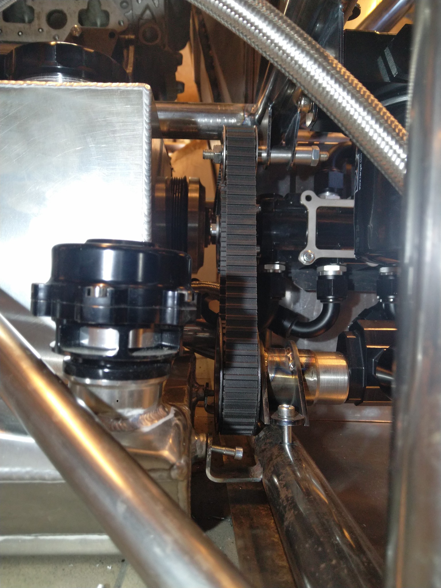

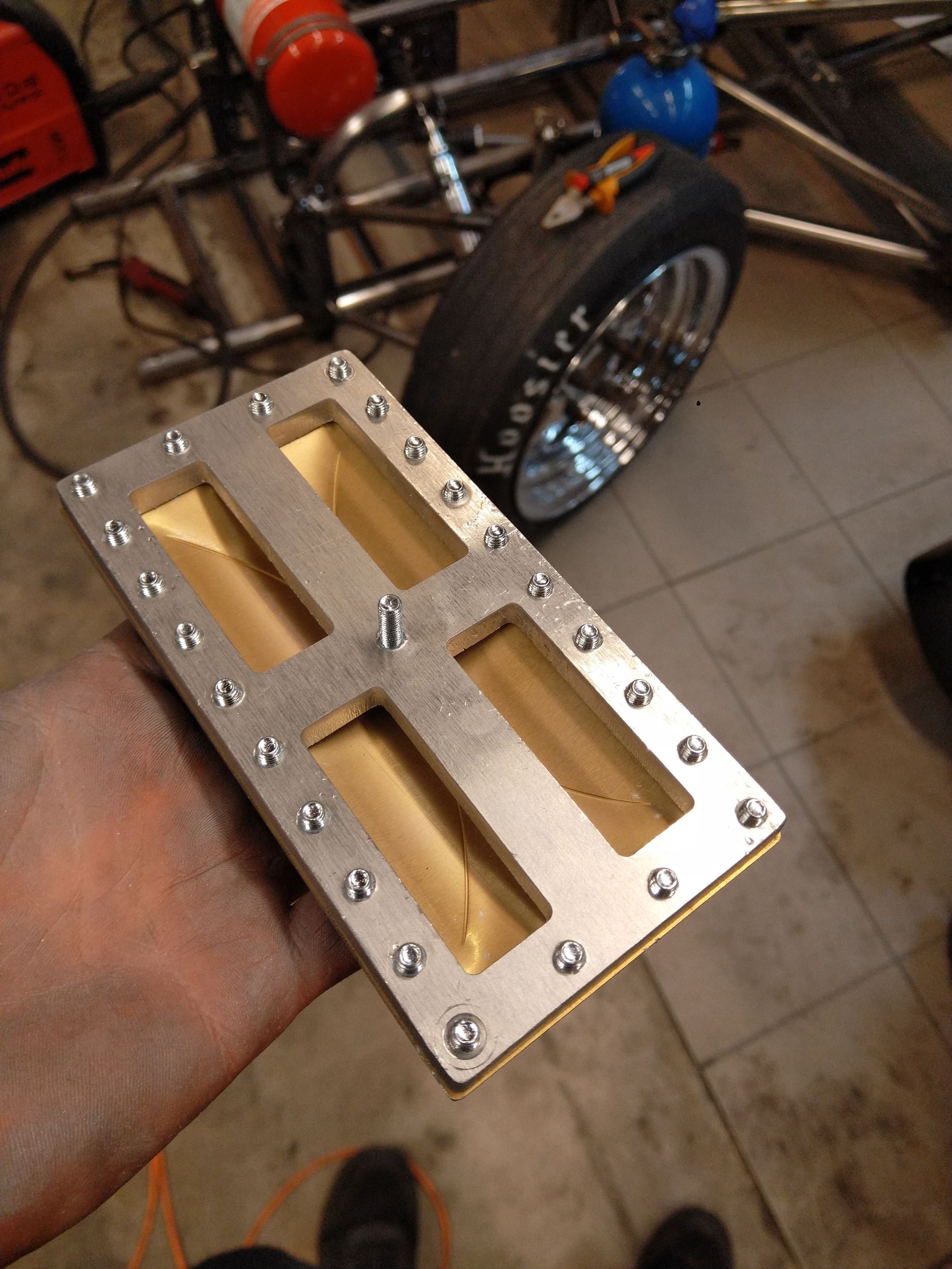

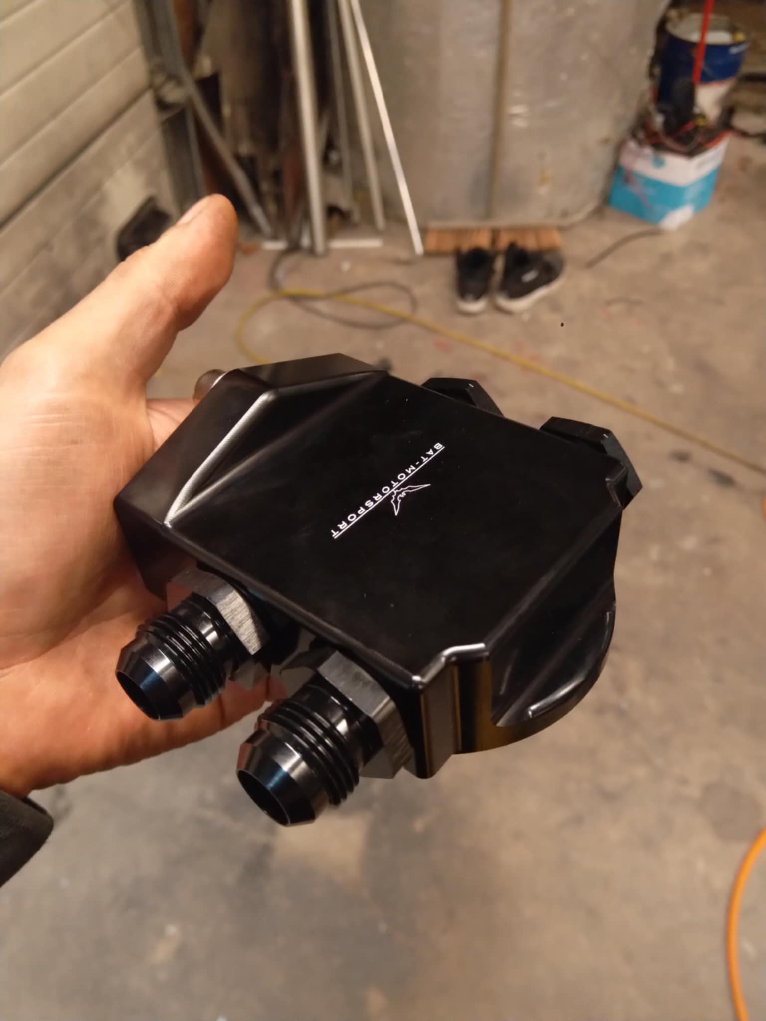

Finally I can show you my solution for pumps. It took me several weeks because you always need to wait for some parts.
Oil pump direction needed to be changed so I decided to go with double side belt. Cam driven fuel pumps need extra bearings for being belt driven. My solution is best for weight distrubution, best for straight and short lines and its easy to maintain.

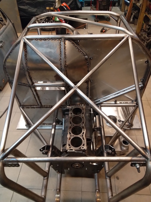

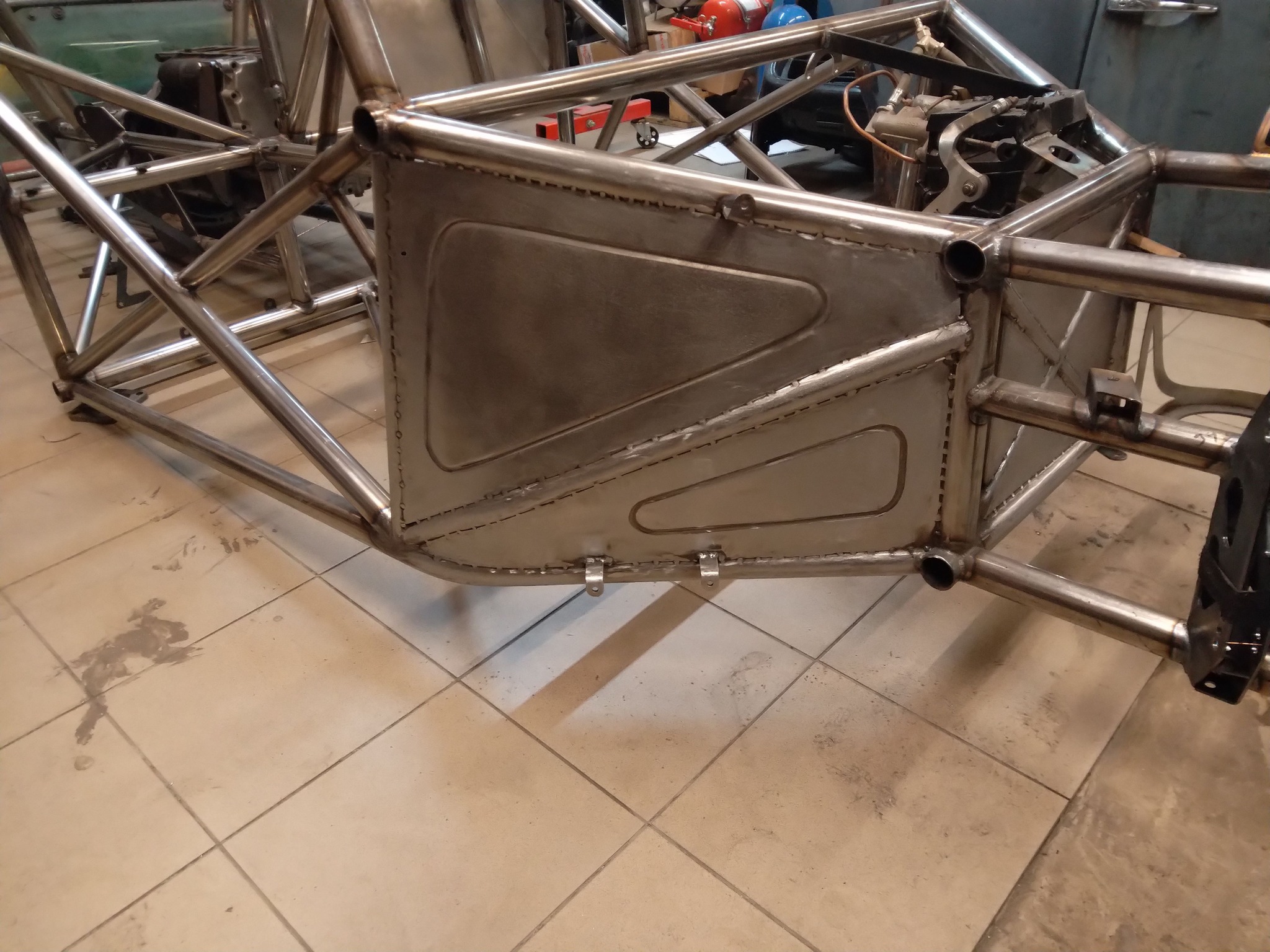

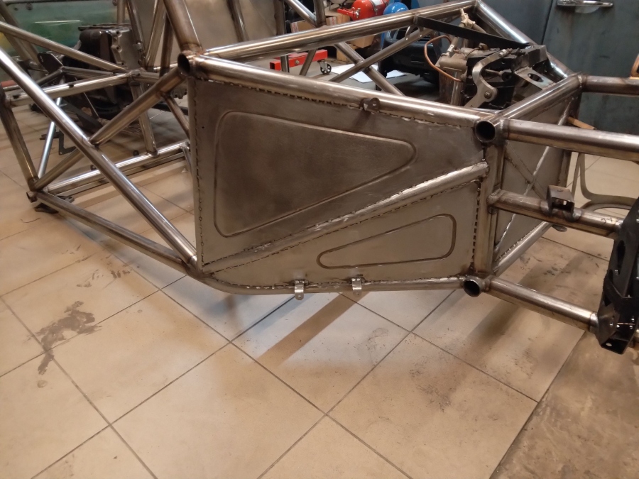

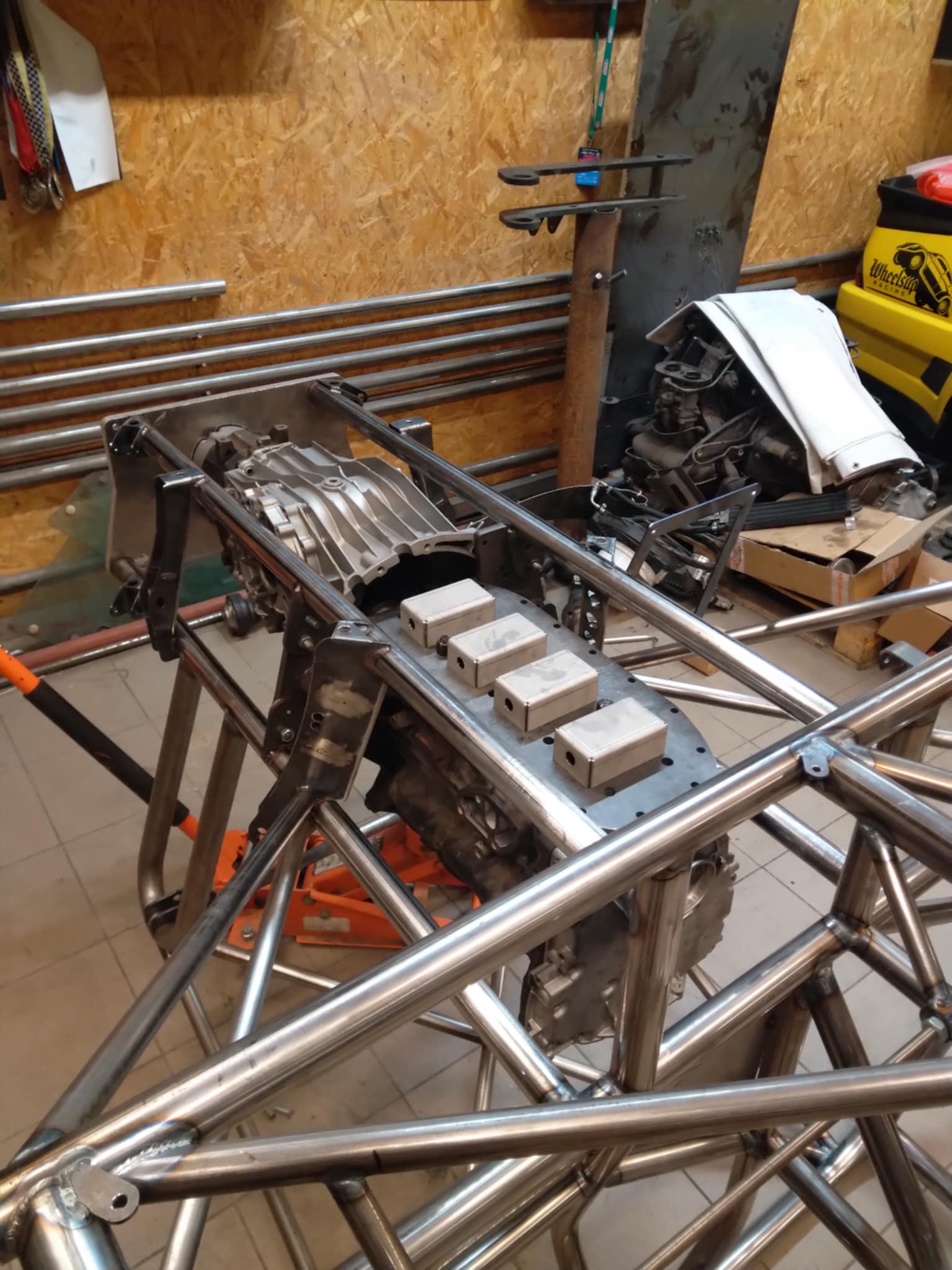

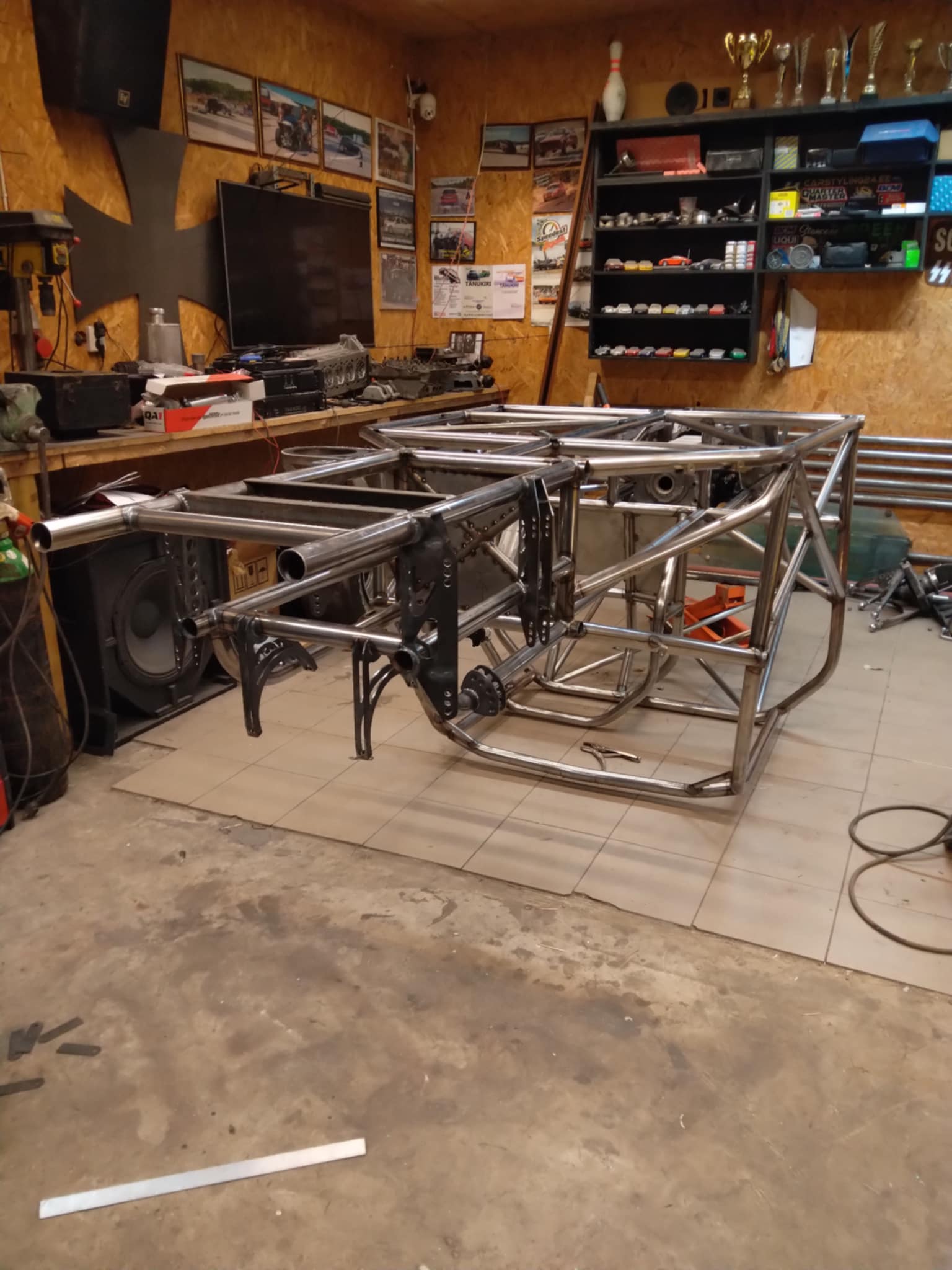

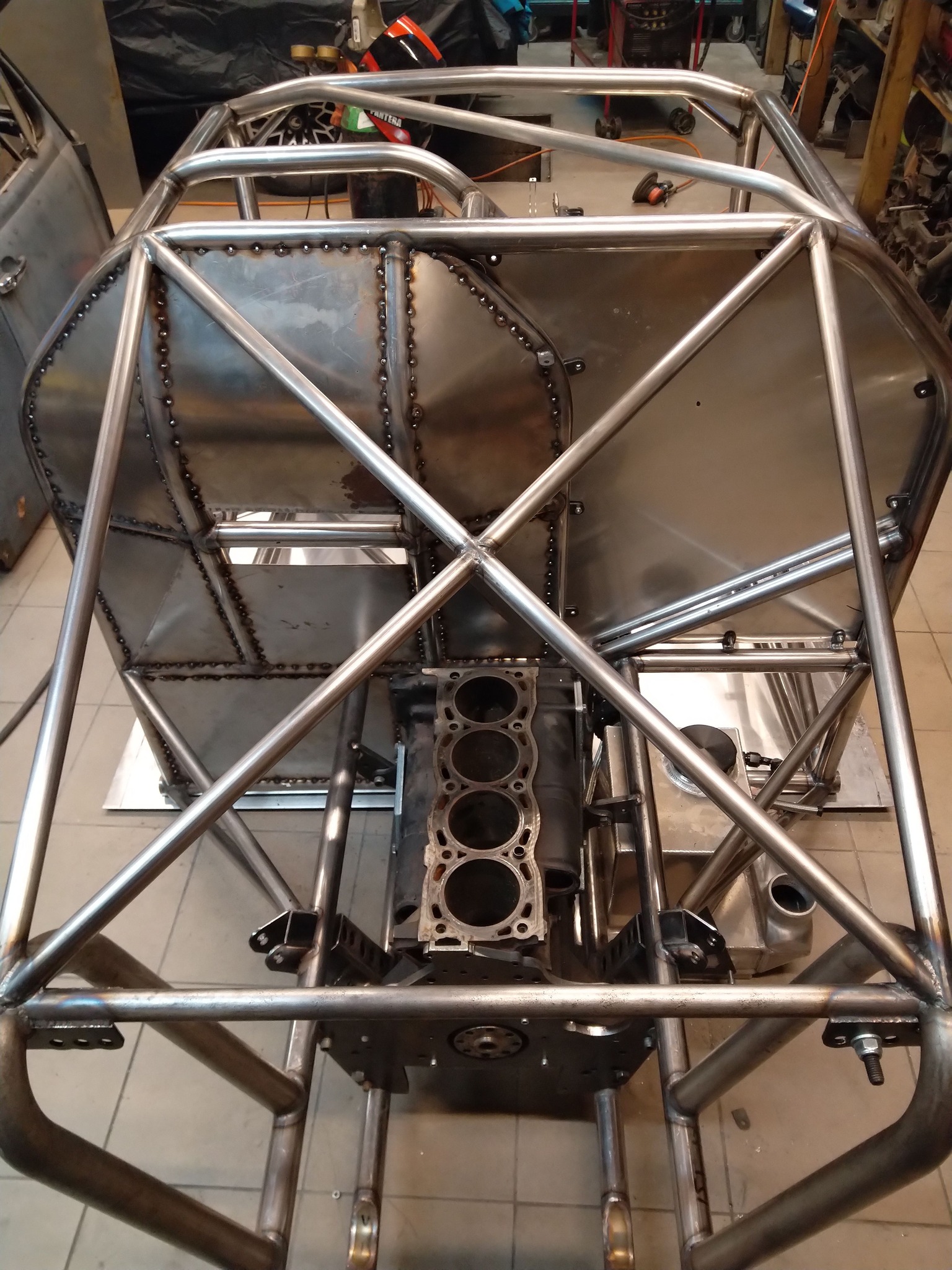

Now the frame is 99% done
When I lifted it I was worried because it seemed heavy, So I brougt my 2 bathroom scaled and measured the weight.
The result was 140kg and 50:50 weight ratio.
My last car was made of steel, that was thicker and was only 20kg heavier. I was hoping 30kg less weight but nothing to do. There are still more pipes and sheetmetal covers than my last car da. Also the endplate for connecting transmission was attached so the diffrece is atleast 25kg compared docol vs steel. Its still cheap place to lower the weight. That 25kg cost me about 1000€ (pipe material price difference) Later I´m sure, I can´t find a place where I can get so cheaply some weight off, its 50€ per 1kk, its good balance I quess.
Also you can see something new there: Anti roll bar, I made it from bmw axle, my last car had none of these.
