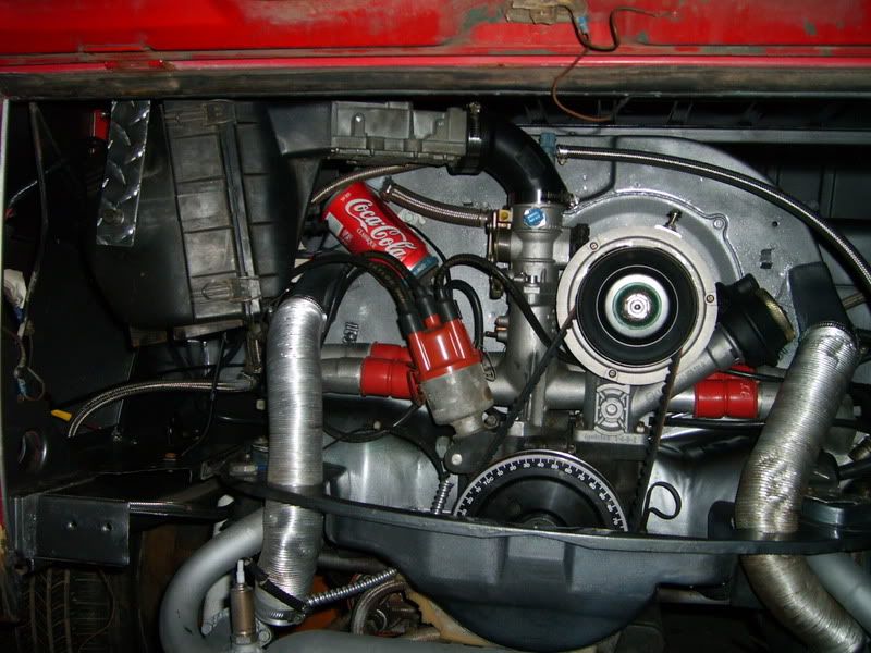

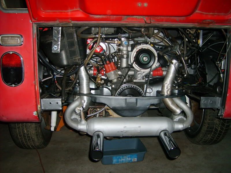

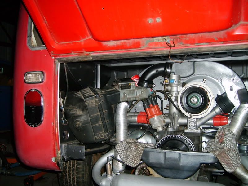

I'm not sure I quite follow you, the L-jet system I'm adapting came of a '78 bus and they had square paper air filters. Everything should fit though, my bus was CIS injected at one point in time a few years ago and everything fit.melville wrote:Jadewombat wrote: I'm very interested to see what that looks like installed in a Bus engine compartment. Can you use the stock oil bath air filter with it? Do keep us updated.

That's not MexiBeetle hardware in your pic? I'm asking about the hardware. It kinda looks like the TB occupies the same space as a 34 PICT 3, but I'm making some assumptions about where each part goes.Jadewombat wrote:melville wrote:I'm not sure I quite follow you, the L-jet system I'm adapting came of a '78 bus and they had square paper air filters. Everything should fit though, my bus was CIS injected at one point in time a few years ago and everything fit.Jadewombat wrote: I'm very interested to see what that looks like installed in a Bus engine compartment. Can you use the stock oil bath air filter with it? Do keep us updated.
I actually have a 78 Bus with L-Jet right now and the manifolds, plenum, and TB sure don't fit an upright motor.
