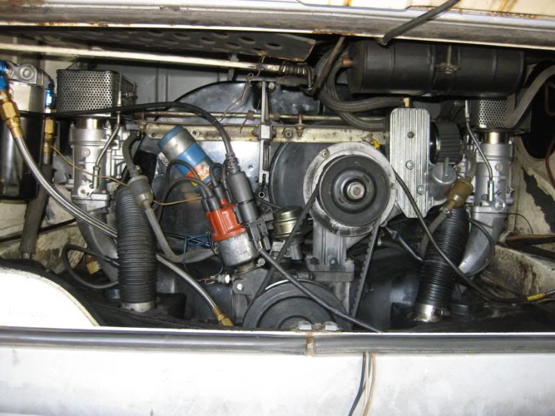

So I just rebuilt the throttle pedal in my `73 as it started to stick horribly bad coming home from work yesterday...There was either no throttle or WOT
Anyway, the bus had always had a good amount of go, but never had full throttle travel at the carbs...after rebuilding the pedal it has full travel and it's an entirely new beast...much more rev happy now, I feel sorry for my cast crank it's going to get a world of punishment now
I just calculated I was getting 18mpg, so we'll see what this brings on.
She used to run out of breath right around 4500 and now it absolutely pulls to over 5k.
