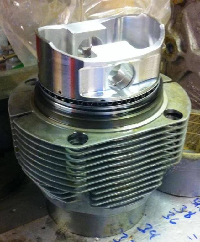

Frallan
Posts: 667
Joined: Sun Mar 30, 2003 12:01 am
Re: Empi 100mm aluminum p/c set
Post by Frallan »
These are my version.
Posts: 22759
Do the 98s use the old 100mm register? (smaller than the ~113mm register the 103-105s use) or thinwall at top w/2l register? (~105?)
Frallan
Posts: 667
Post by Frallan »
Sorry Pile and anyone else that got confused by my post.
The cylinders and pistons are not 98 mm (do not recall what my mind was thinking when I wrote that number) but I thought all the time I had bought a 96 mm set.
Just measured them today and guess what, it surprised me but they are 95mm.
Had the cylinders over at a shop ong time ago that sets them up on a center expandable tool.
That way he can "touch" bottom and top in the lathe in the same setup and they come out fully aligned, he said they squared very nicely.
I asked him to check for cylindricity and same thing, checked out spot on.
So in theory very nice.
Never did we talk about if they were 95 or 96 mm.
Now I know.....and you too.
Now I have to check what the order says. Pretty sure it was 96 mm... :-)
In any case, the have the stock slip in fit.
Frallan
Posts: 667
Post by Frallan »
Item Sku
Forged JE 96mm 2.0 Porsche 914/ VW Type 4 with Biral Liners
Compression Height, Pin Size
C/H 1.185, Pin 22mm VW9600T4B JE-VW9600T4BSJE
Check/ tick off, I am not totally crazy.
Never mind as for turbo more meat in the liner is better. Funny though.
