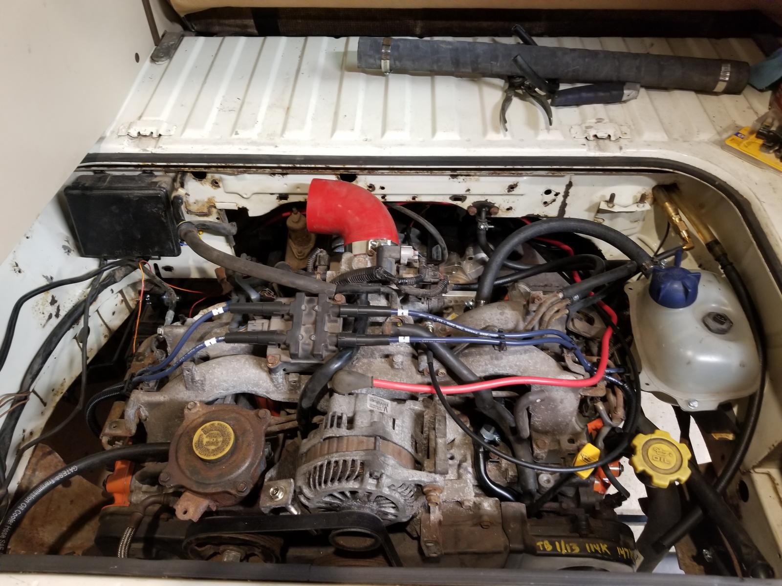

Here are some pictures to show what it took to get to the video of a running van.
Here is an overview of the engine:
I am using a KEP air filter and housing i got from a friend after helping him modify the Vanagon KEP carrier to to fit his bus.
