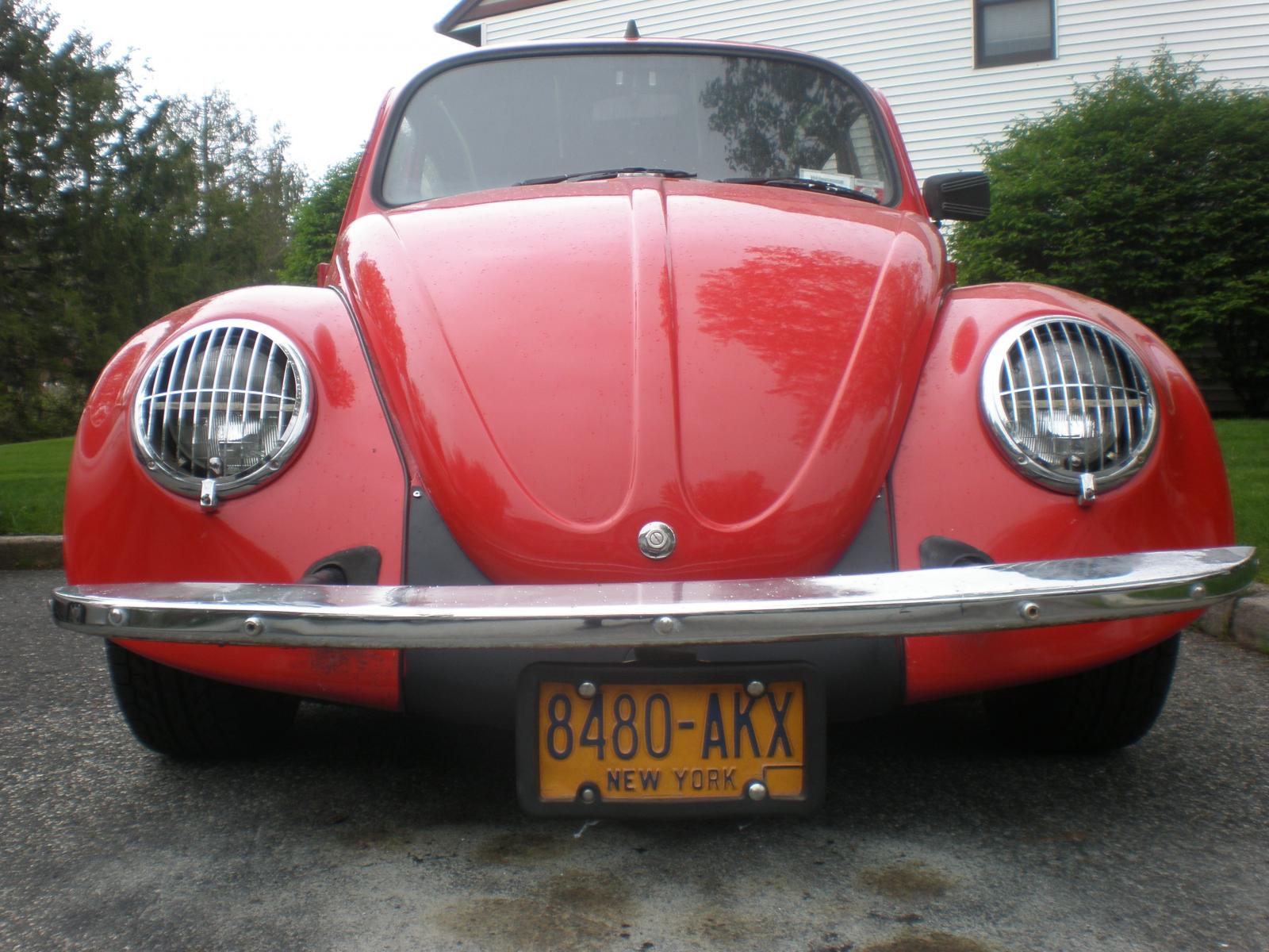

Hi Piledriver and Tony,
To answer your question about what it better. Photos are a thousand words!
I built my first T-4 Cali Style in 1989 Wrote the manual in 1992.
Same engine never opened, for any reason, only valve adjustments ( another post with more photos ( inexpensive breather I posted yesterdsay )
30 years the car blasts from 60 to 100 in seconds. Will not do it again only up to 95mph the front lifts, steering becomes light.
Never babied the car.
Just Visited Chris Vallone the Classic VW builder to the Stars today an old friend. Showed him my new tinted windshield.
If you are going to put a T-4 in a bug and you don't go performace crazy, I have a 2.0 8.5 to 1 compression regular gas.
T-4 is the way to go.
As I said i don't baby it! https://www.youtube.com/watch?v=Ap0NeT2Q2vc
https://www.youtube.com/watch?v=lIkhkOpF7kU
https://www.youtube.com/watch?v=deD2JxpUA48 Put up the Volume
