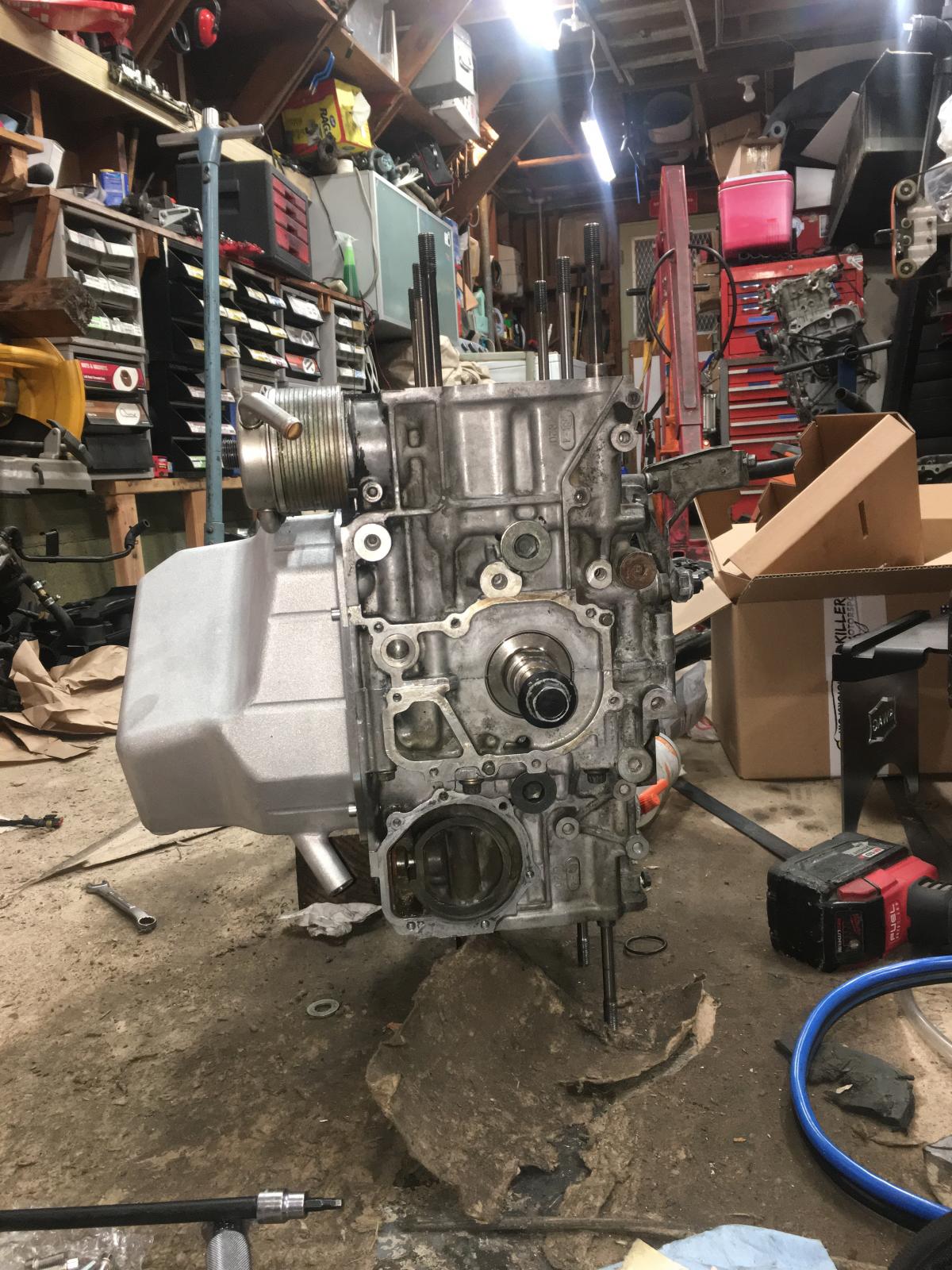

All back together, went with a killer b oil setup, hopefully the extra capacity and better pan design keep me from starving again.
Making a firewall at the moment and dropping the engine down 1-2”
Also getting closer to finishing the 2.5 engine I’m building for it. Still hoping for 450whp, but even 400 is going to scare me.

If you're dropping the engine down watch out for that nice oil pan you have there

Actually the oil pan doesn’t fit! I’m cutting the mount and dropping the entire thing down.
Here is the new motor:
2.5 block with darton sleeves
Je fsr pistons, 9:1 compression
Manley h tuff rods
King race bearings
Arp case bolts
Arp 625+ head studs
12mm oil pump
Stock 08 sti heads
Stock 205 cams
Brian Crower pulleys (still need to index them)
Killer b pan, pickup, and windage tray
Ej253 big manifold
AMR 490 turbo (for now)
ID 1300cc injectors
Microsquirt 3 ecu
Manley h tuff rods
King race bearings
Arp case bolts
Arp 625+ head studs
12mm oil pump
Stock 08 sti heads
Stock 205 cams
Ej253 big manifold
ID 1300cc injectors
Microsquirt 3 ecu
