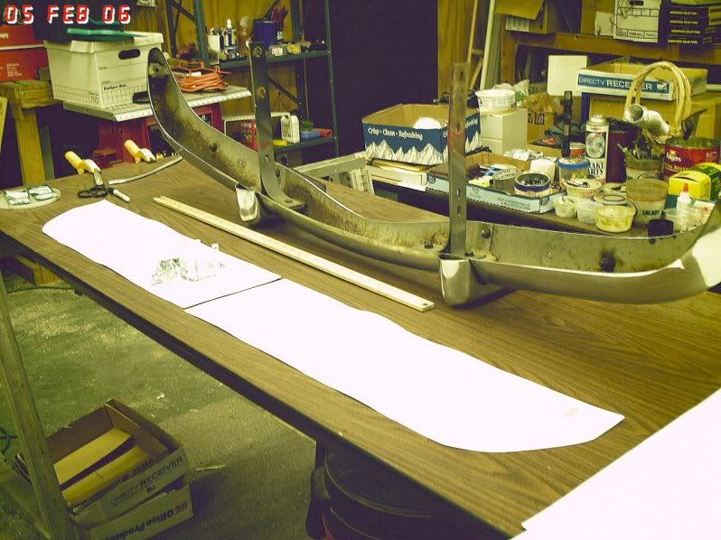

Hi Fiatdude,
I fashioned our airdam out of sheet metal cut from a simple pattern, and fastened it to the bottom of the bumper with simple hardware store L-brackets. The airdam itself will curve gently.
Very easy.

How much deflection do you get at speed with that set up --- or does the slight curve give it some ridigity

Hi FiatDude,
No deflection or warping. The curve seems to work for that, and I was prepared to pop-rivet reinforcing braces to the back of the airdam. It was not necessary.

Fiatdude wrote:How much deflection do you get at speed with that set up --- or does the slight curve give it some ridigity
Do you think there would be any advantage to building one with a spliter on the bottom?????????????

Hi FiatDude,
A splitter may help, but the simplicity of the design here is hard to beat, It just blocks air out from under the car.
I'd concede that a splitter might be cosmetically nicer ...
