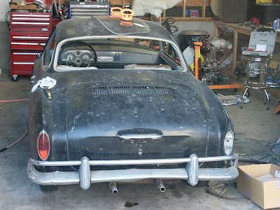

Hey, I'm new here, but have been posting on The Samba for about a year. I drive a '74 Super, and I just picked up a '62 Karmann Ghia coupe a few weeks ago. I've stripped all the bondo and found all the rust, and I'm getting up the courage to make the first cut. I think today's the day.
Actually, I got 1 and 1/3 Karmann Ghias.

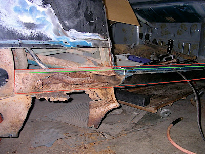

Cutting apart the rockers. I'll have to replace the outer and inner on both sides, but the heater channel is good.

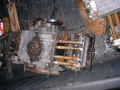

Picked up a couple long blocks for cheap. Hopefully I'll have enough refurbishable parts to get me on my way to a good engine.

More pics of the heater channel repair, please.

This is as much as I have done on the rockers so far. I cut enough to know what I was going to need to do, but completion of the rockers will wait a bit I think. I'm going to concentrate on the pan first.
