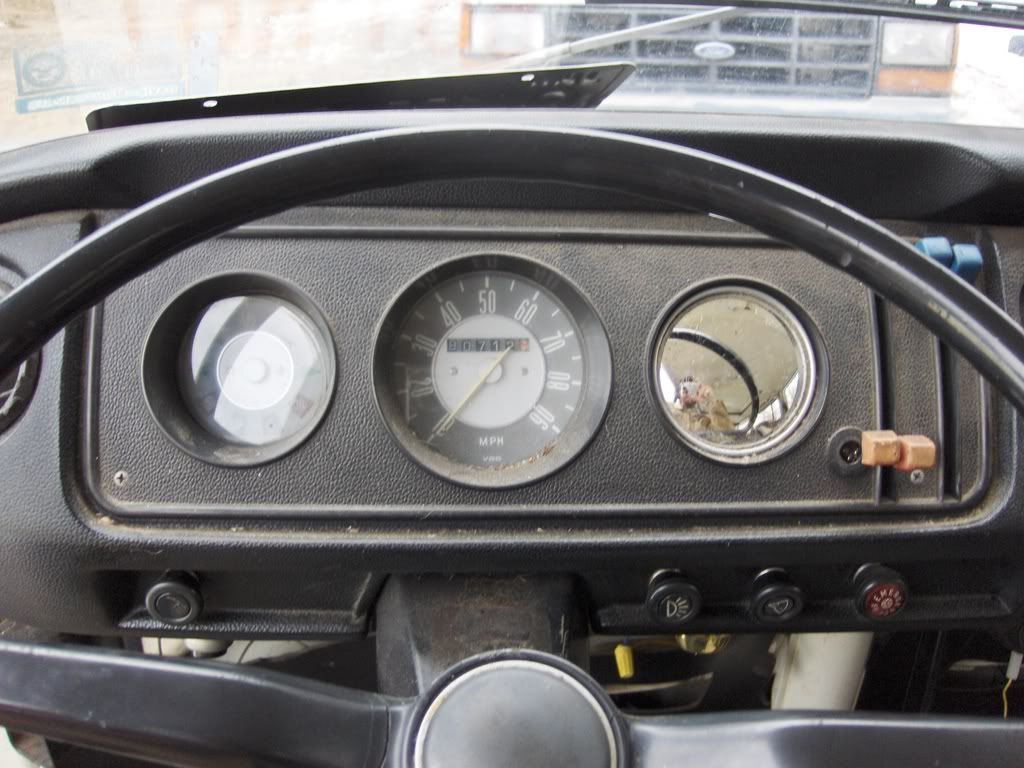

My first VW, I've always wanted a Bus so now I have one! Needs a wee bit of sheet metal work, interior, and some electrical but has a rebuilt motor and is a ton of fun to drive. Any suggestions on where to get preformed sheet metal for this?

nice bus, I keep thinking a bay would be a nice addition to my driveway, but the wife keeps insisting I get a reliable daily driver first. Whats the interior like? It looks like it may have a Z bed, and some camp stuff (from the vent behind the drivers door). STF is a great place to get advice! Not sure where I'd be without it. Welcome!

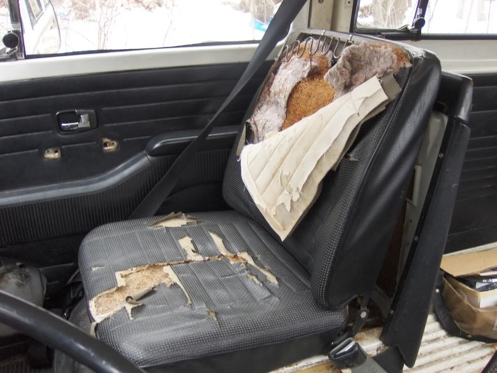

So the interior is rough, plenty of work ahead of me there too. I think it does have a Z bed, the guy I got it from says it folds down into a bed but I haven't checked that yet.

wow, thats old school! A Z bed is a must in my book, whats the fun of having a bus if you can't sleep in it?

If you have a working Z-Bed, treasure it. They are much sought after and they are no longer being made. Skub, this is looking like the beginning of a great project. Keep us up-to-date on how you do.
