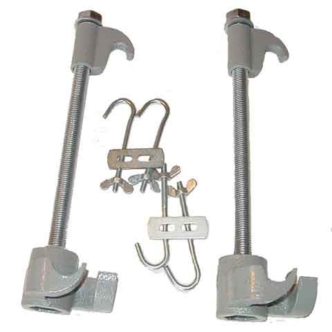

I want to know if i can weld 2-3 of the middle coils together
or if heat to them is a problem
get some spring compressors and compress about 2-3 coils

I think the traditional lower technique for a 41x involves a spare cast iron motor in the trunk.
I saw a coil sprung jeep guy compress his front springs with a set of HF ratcheting strips (in order to fit a raised spring perch lift). As far as I know he still has original equipment eyes and fingers.
http://www.harborfreight.com/4-piece-1- ... 90984.html
