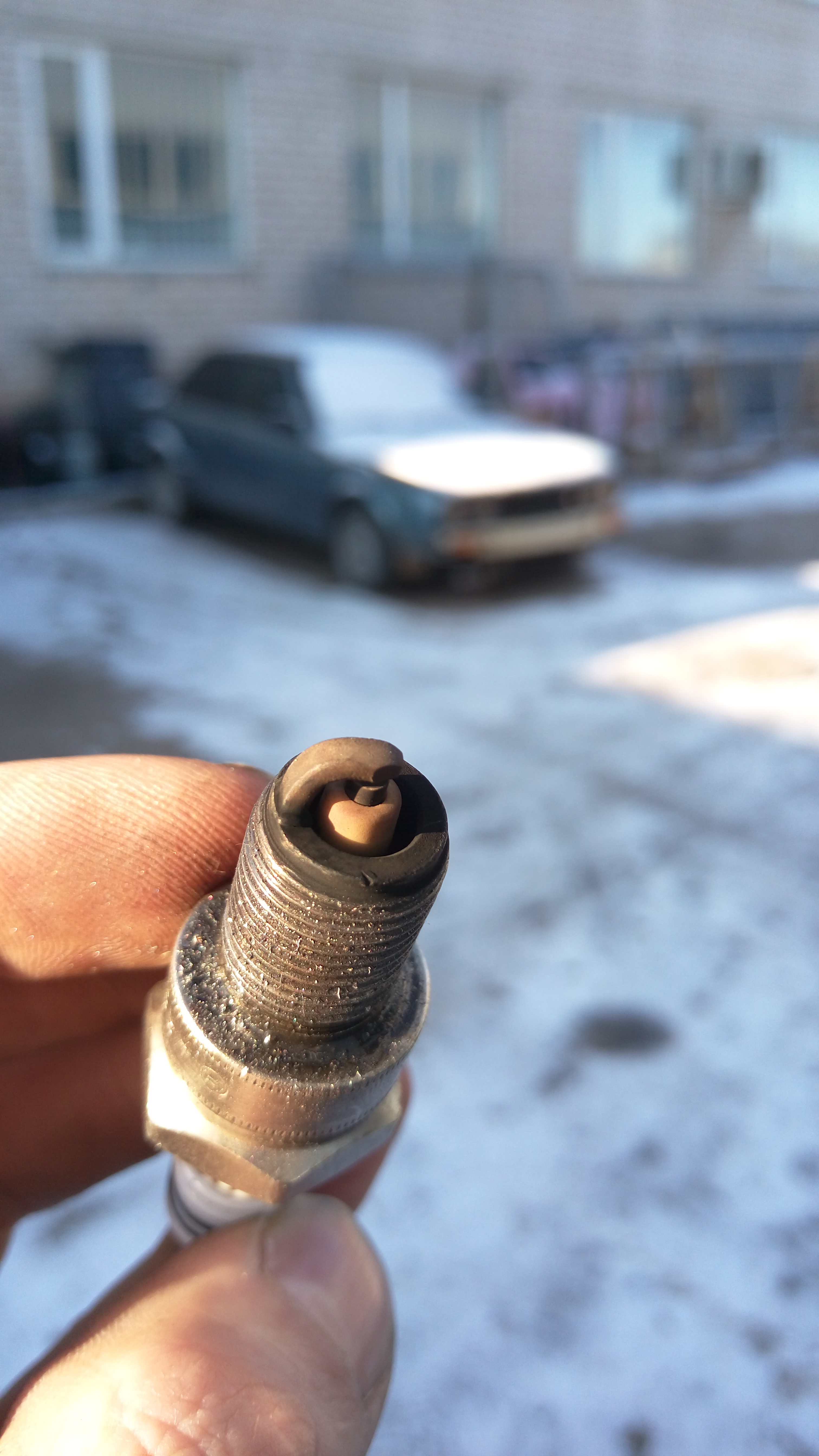

I changed 7 NGK heatrange plugs to 6 - Is it riski business? there were a lot of black on the edge with 7

I suspect that your plug color isn't due to too cold of a plug (I ran B8HS on mine) - NGK 6 is probably going to cause some preignition. File the electrodes back something like this:

Unfortunately I have not enough skills with reading plugs and with naturally aspirated engines. I boost engines for living and usually they are old cheap m50 141kw BMWs in light third serie body and they ask for 300-400kw with stock internals but sometimes 500+ kw when we have some room to play with ethanol and some budget for chinese rods and better headgasket
We gain the displacement up to 3.2 litre with diesel crank and 2mm oversize pistons from some another car like nissan or what ever we can find
Thouse engines live nicely with cheap NGK7 but need 0.6mm gap and last maximum one season. We don´t read plugs and use only wideband and EGT sensor when needed.
Can you help me with reading heatrange from plug? (There were old plugs and when I was thinking that they are too cold then now Im little worried and not feeling comfortable to let this car out with 1 step hotter plugs,
Old bosch on picture (matches heatrange 7 with NGK)
I think I touched it too much because there is no black on the edge as it was before
Re: cam questions...
Several challenges when reading plugs. First and foremost is getting a "clean shutoff" by switching off and declutching at the point of full-load. Any time spent under other conditions (i.e. idling) can change the look of the plug - typically that's where any black soot comes from on a healthy engine. Fuel additives can add coloration. To get a really good read you need to use a loupe and strong light to peer down towards the base of the insulator, the "color" there is more consistent/reliable than what you see near the end.
The plug in your photo looks pretty good to me, from what I can see of it.
http://mechanics.stackexchange.com/ques ... heat-range
The scariest thing you can see is tiny shiny balls (often with a purplish tinge) clinging to the plug, since those indicate preignition and imminent melting. Usually the cause is too lean of a mixture but detonation from any cause, including a too-hot plug, can be a factor. http://www.hotrod.com/articles/reading-a-spark-plug/
I assume you're aware that Bosch heatrange numbers run counter to those of many others, this is for the benefit of others reading this: http://www.leeroysramblings.com/OB%20im ... reange.jpg
