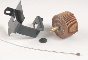

Oh, and I'm also planning on having the Megasquirt control the cooling flaps, replace the thermostat with a stepper motor, whereby I control the flaps directly from the head temp readings.
The first engine I built, about 20 years ago now, a VW type 3, I made the mistake of not installing the thermostat, and the engine would never heat up. I've learned a thing or two about operating temperatures since then ;)

Stepper t-stat sounds cool for sure.
