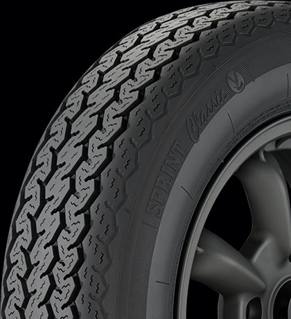

Picked up some sticky vredestein sprint classics in a 185/70

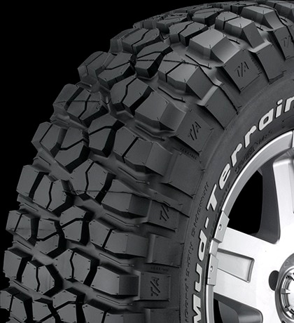

and then on my 4" stockers, i'll run a squared 215/75 in a BFG KM2 Mud terrain (ha!)
