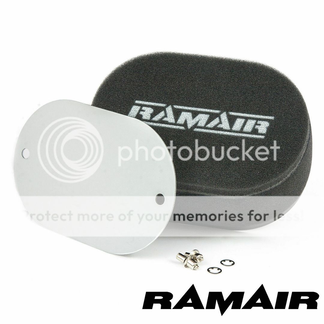

Think I will use something like this on the throttle bodies, and try to duct the cold air to it, maybe enclosing the filter in a housing.
